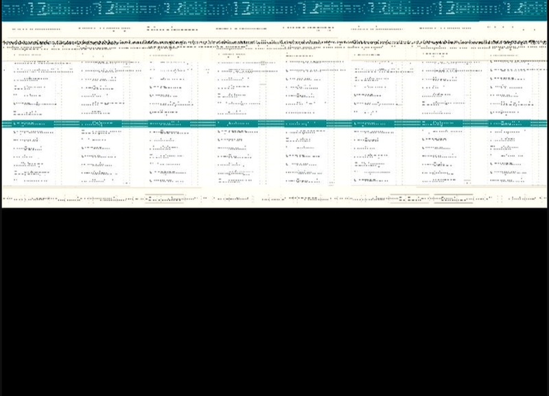

HP EliteDesk 800 G2 VGA Scrambled was created by kirkreiten

Replied by tommylight on topic HP EliteDesk 800 G2 VGA Scrambled
Press Enter, usually fixes itself.
Seen this often, sometimes just rebooting finds the right signal range for the monitor.
Depends also on monitor, so if you can, try another one.

Tried 3 monitors so far. The "Live System" works great..
Tried the same .iso on a Proxmox VM,, it installed fine

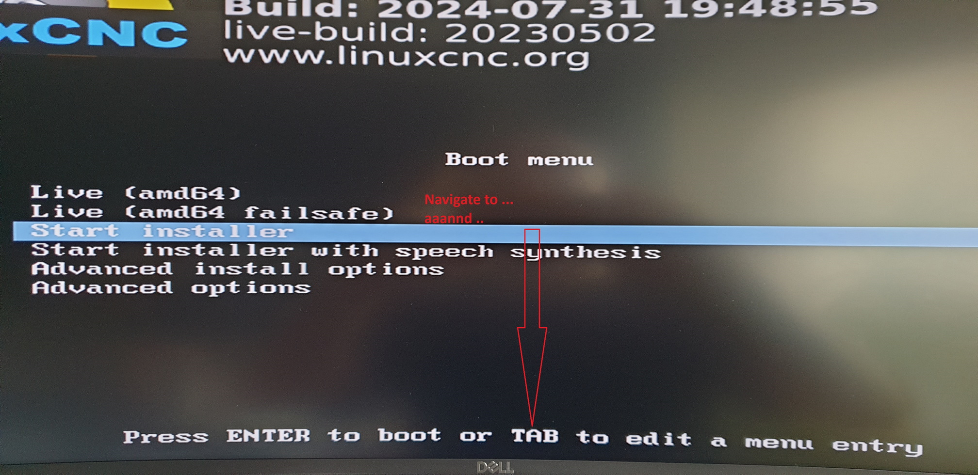

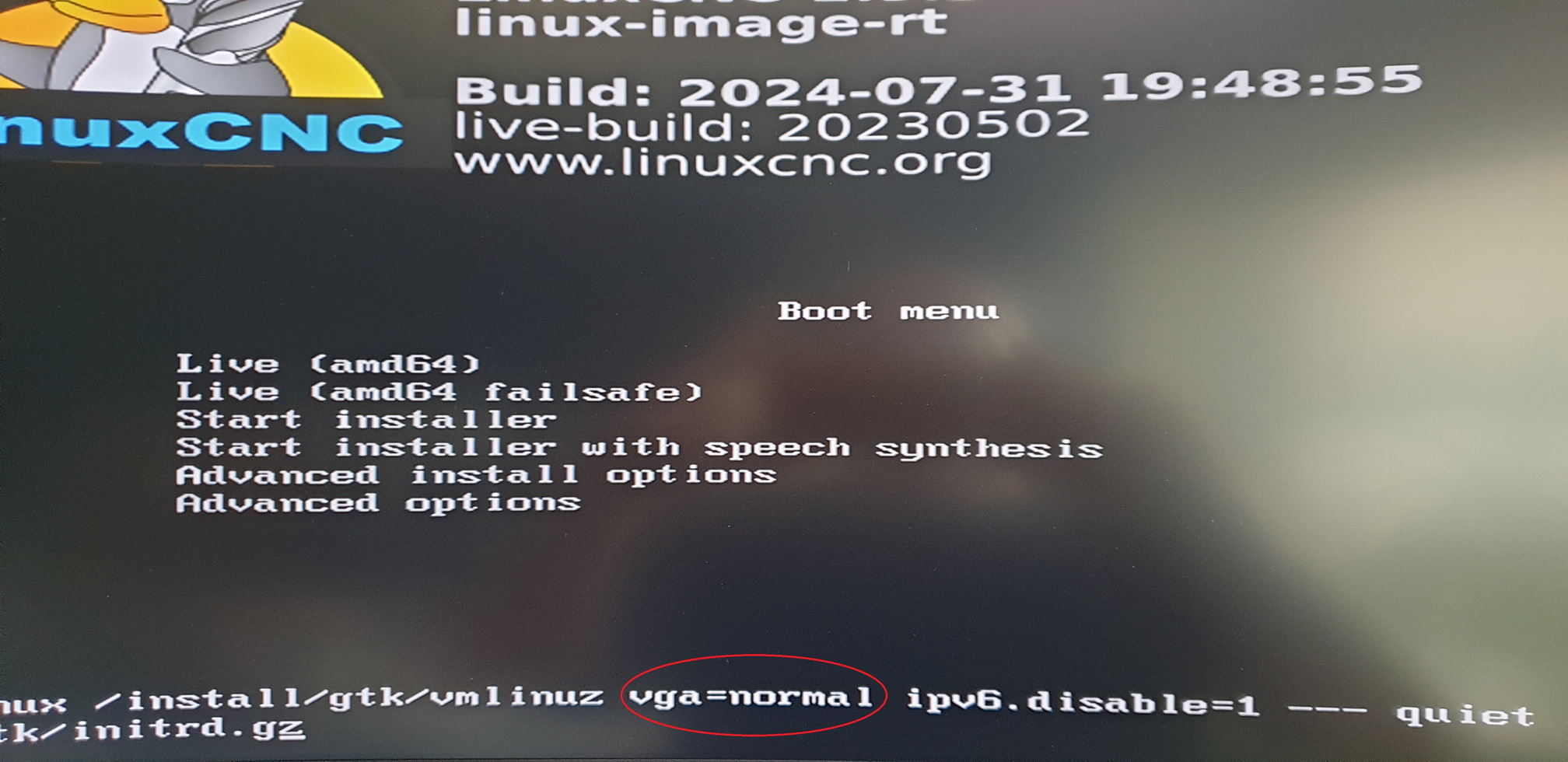

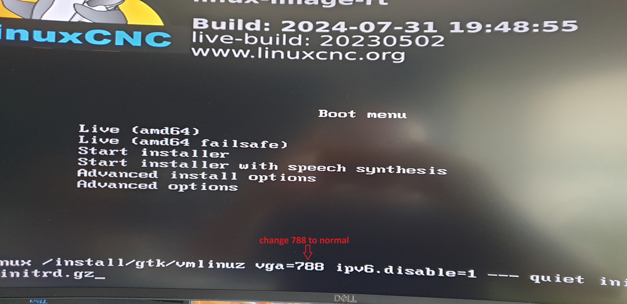

18 Aug 2024 08:49 #308071
by Kittifix
Replied by Kittifix on topic HP EliteDesk 800 G2 VGA Scrambled
- Benb
- Posts: 184
- Thank you received: 61
19 Aug 2024 20:18 #308180
by Benb
Replied by Benb on topic HP EliteDesk 800 G2 VGA Scrambled
The trick is to install Debian via the internet
www.debian.org/CD/netinst/
In this way, Debian will load the correct hardware drivers for your PC. Once you install Debian 12. Use Synaptic to install Linuxcnc. I have not tried this method; I prefer to use run in place method (RIP). If you need step by step instructions how to install RIP Linuxcnc let me know.
