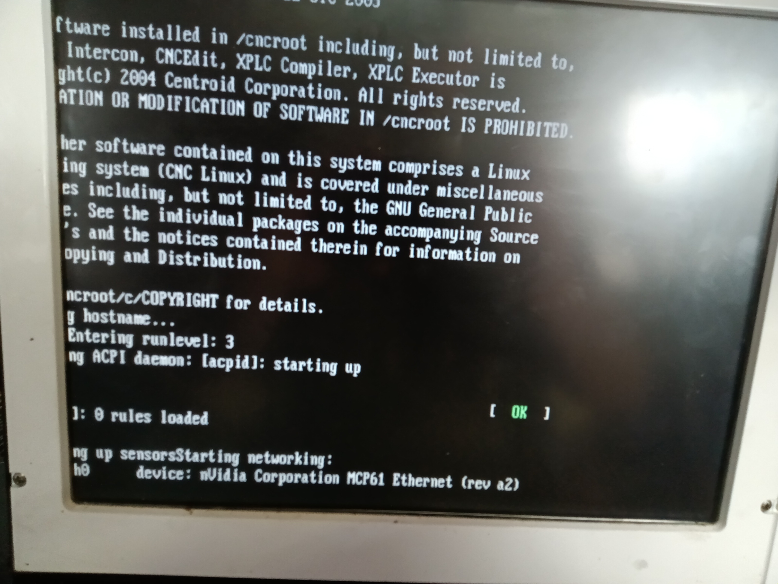

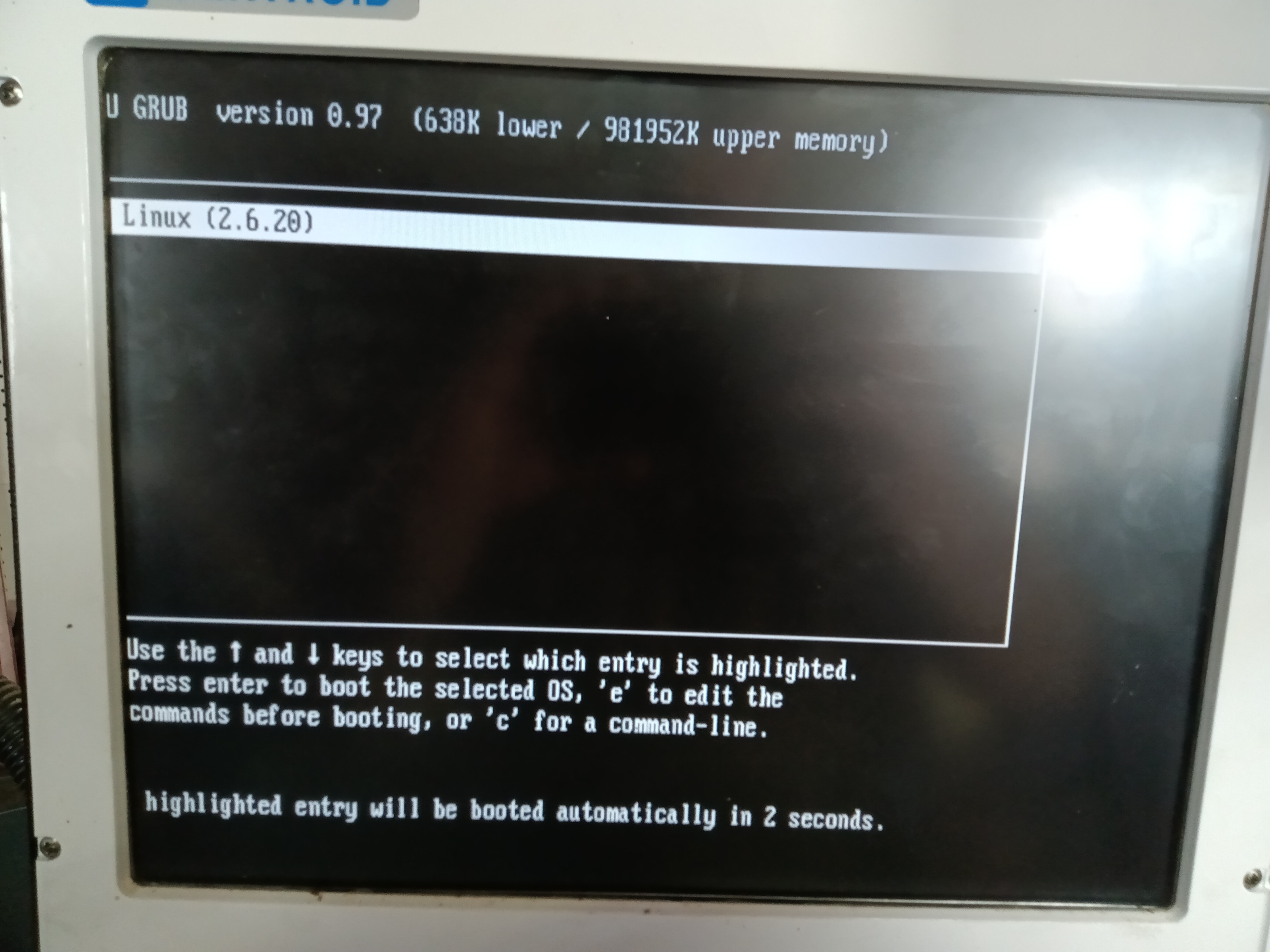

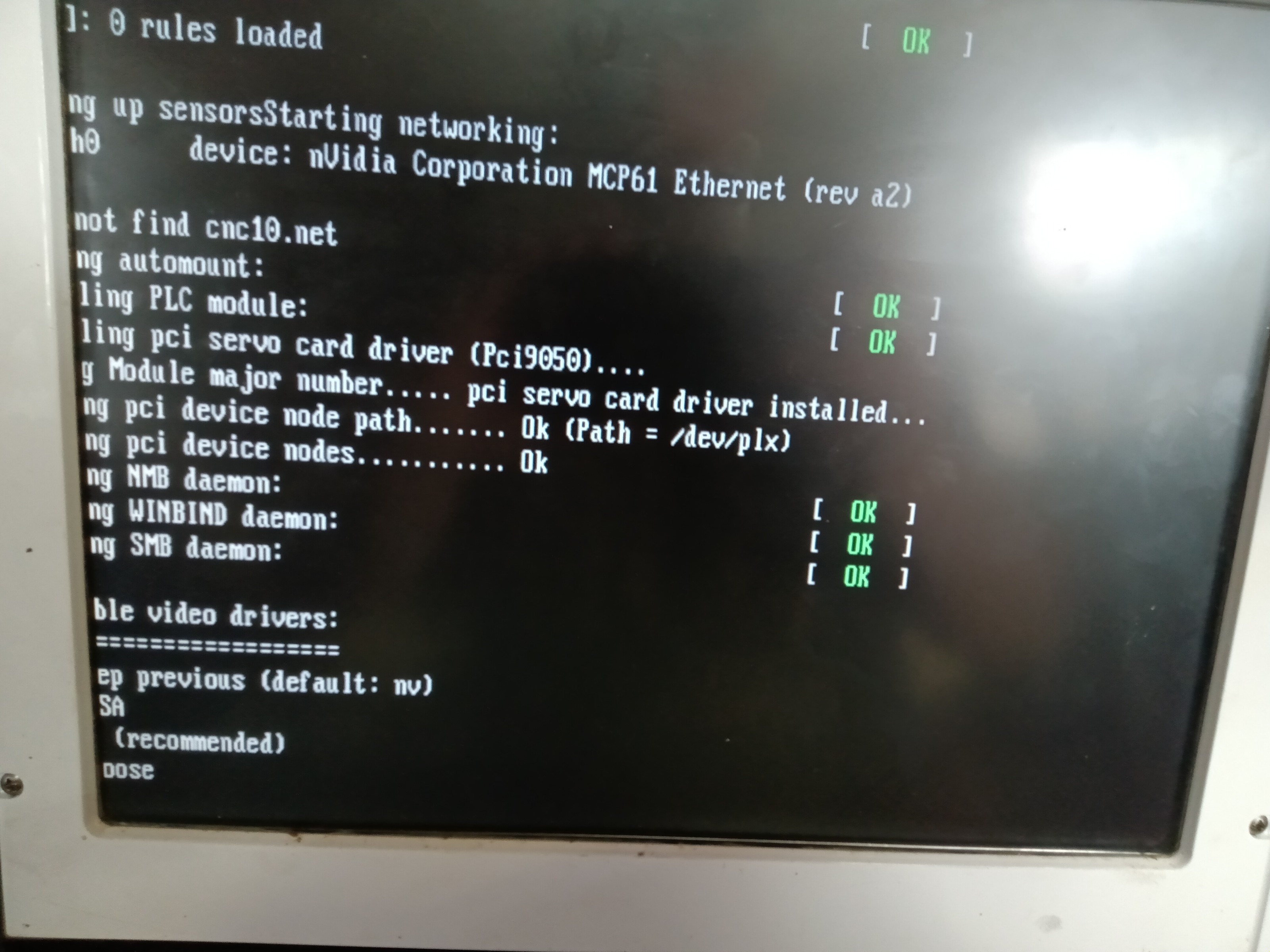

Here are the screenshots. Google only returns LinuxCNC when I search for "cnc Linux" with quotes. I was thinking maybe that was the project name before it was EMC, but I figured you would know

Yes, that is Linux, for sure, seems like Ubuntu 8.04 GRUB menu, that was still EMC2 back then.
Picture of the electronics box? Does the PC get to the desktop? Did you see any mention of QEMU, VBOX, Virtual anything mentioned while booting or after boot?

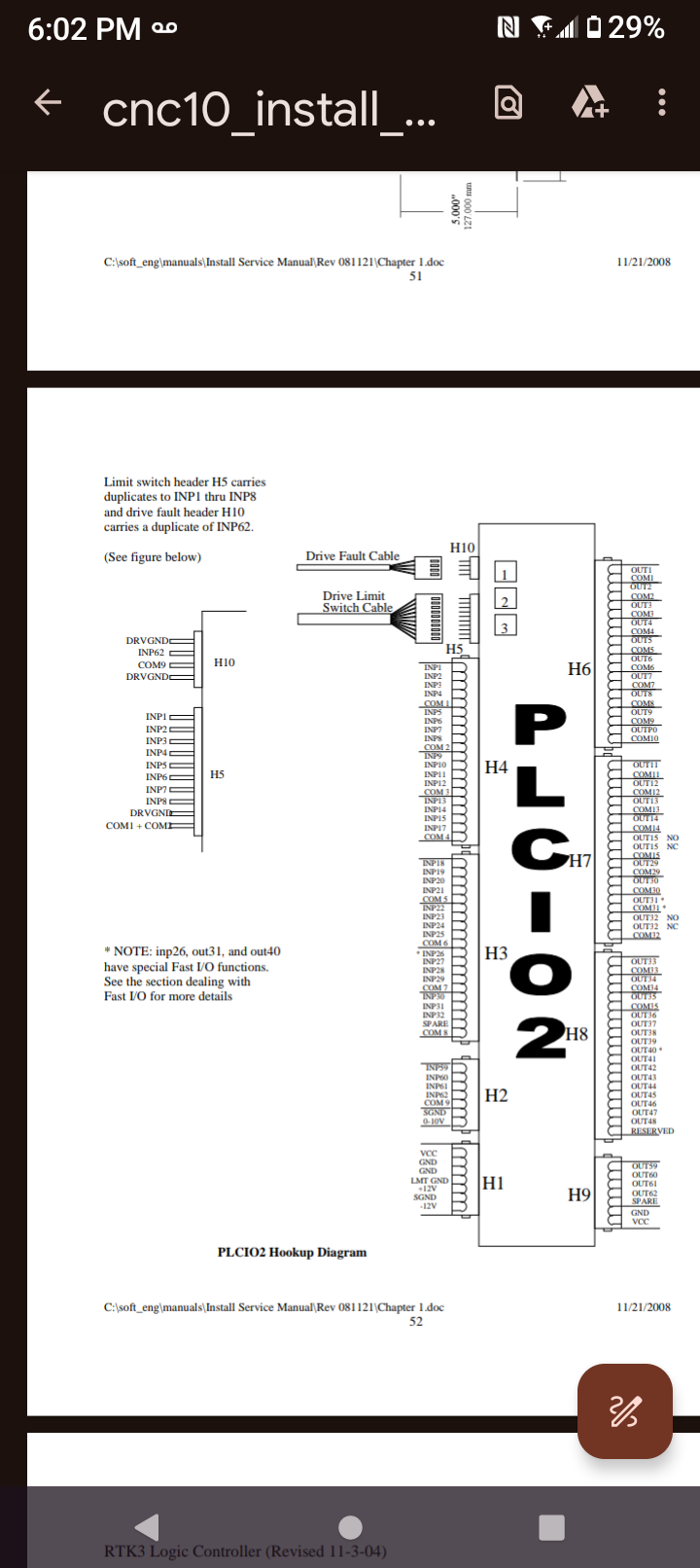

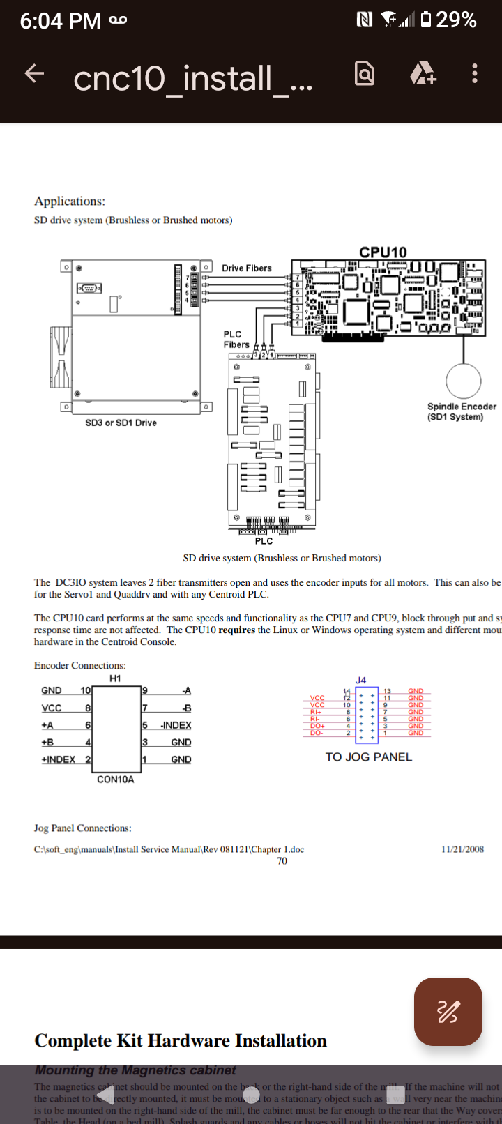

it contains an off the shelf motherboard and a zip drive as I don't think they had SSDs back then. Then it connects to a PLC, that's called PLCIO2. That is in the electrical cabinet and is pretty buried. It also has a motion control card that uses fiber optic cables.

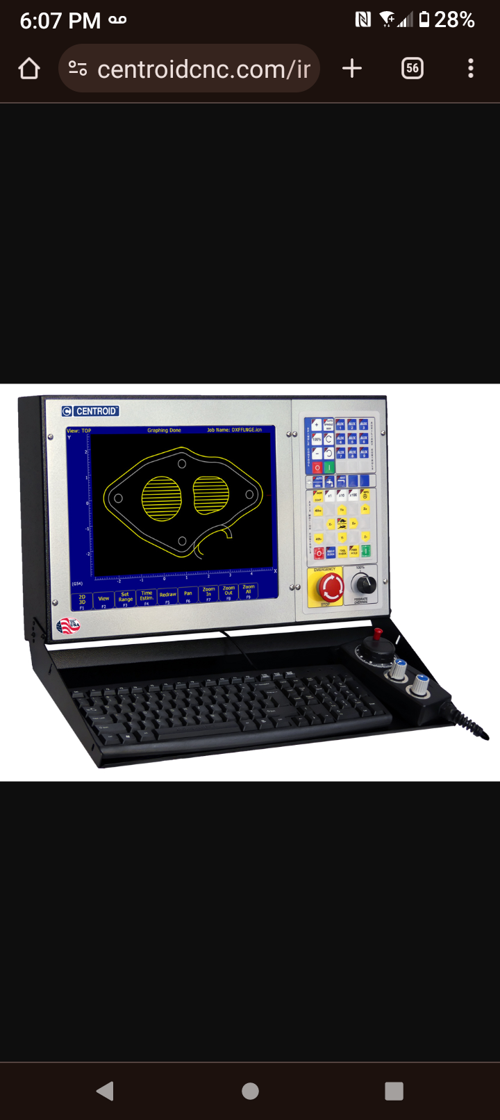

I am not sure what you mean by electronics box. The HMI looks like the one below. It is the M400 model.Yes, that is Linux, for sure, seems like Ubuntu 8.04 GRUB menu, that was still EMC2 back then.
