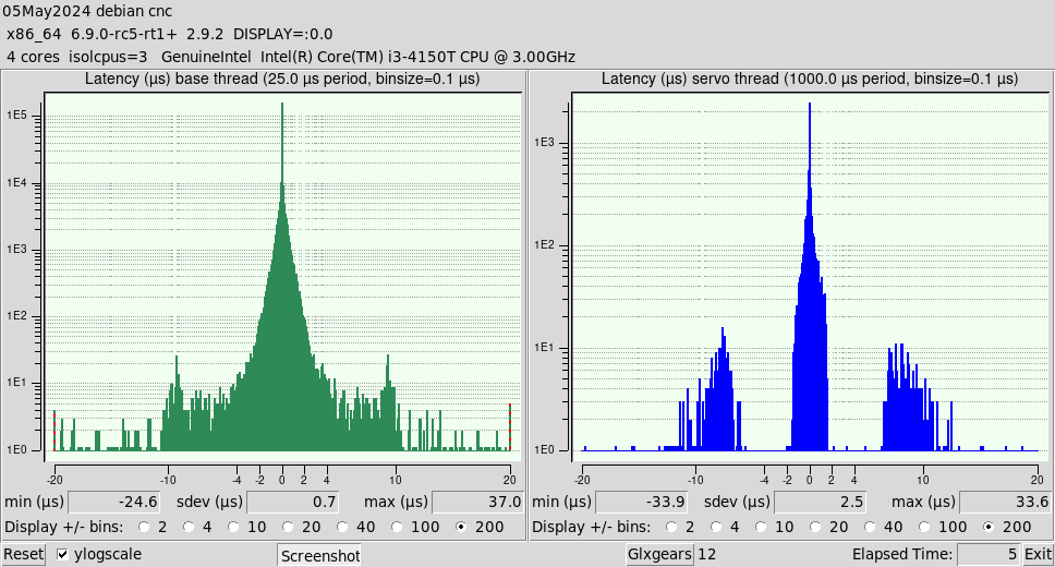

i look to latncy histogram.... the spike stays... but linuxcnc runs... will run again a large gcode..
sorry for the big post but it could be possible that we are on the way to solve my issue.. and i think its nice to share it complete with others.
does someone have more information about the spike?! i absolut new to the debian 12 problem.. thats why i have a mirrored linux with debian 10 running

servo-thread ( 415228, 4213244 )
with 8 youtube single windows and gcode running.. still runs

You can see if it works with "cat /proc/interrupts", the interrupts of enp2s0 should be on the last cpu.
Since you use a Mesa card you don't need a base thread so you could run:
latency-histogram --nobase
These kernel parameters reduced the latency on my Optiplex 7040 micro:
isolcpus=3 intel_pstate=disable processor.max_cstate=0 idle=poll cpufreq.default_governor=performance i915.enable_dc=0 ahci.mobile_lpm_policy=1 irqaffinity=0 nomodeset quiet
