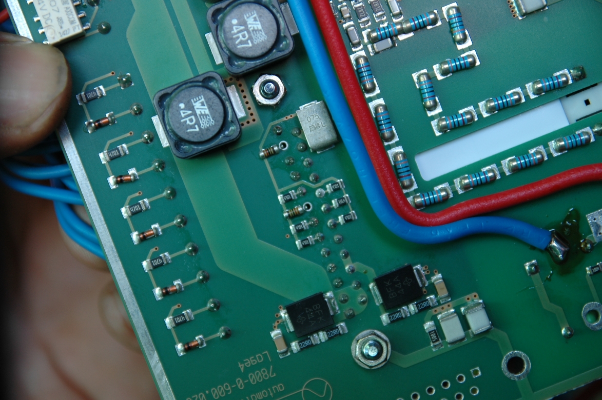

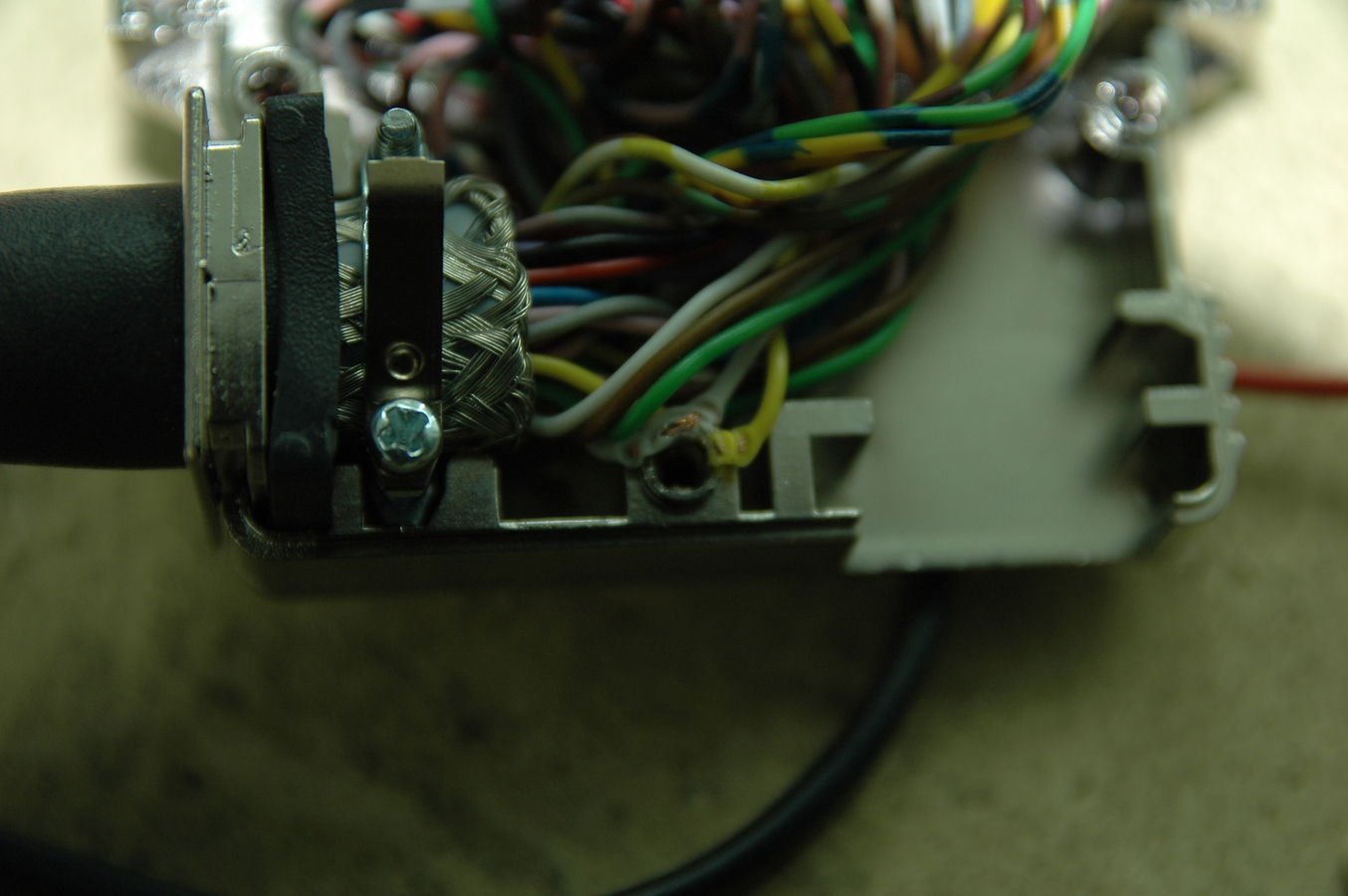

A very good point, thank you for that and the same way of thinking years ago. Old scrap out new one in, pay and have support.....It never happened as the guy was just to busy and major problems could never been solved. Then the company went bankrupt. Now no support at all and the sheer arrogance of this people (except the mechanics and soft ware guys on ground) is outstanding. The only thing they can say buy an new one and pay as after 4 years this crap is outdated. And then the quality.....see the pictures....says all. Replacement...?? Nope!

On old motors, mind the encoder cables, they tend to brake inside the connector, and quite hard to solder in place. Luckily, only one had such issue.
