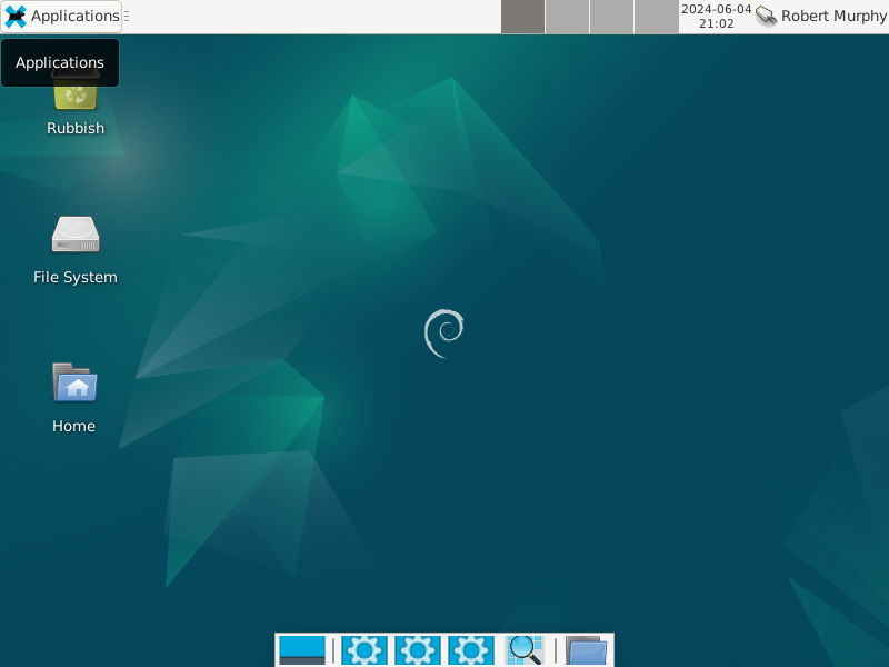

04 Jun 2024 21:15 - 04 Jun 2024 21:19 #302355
Replied by Cant do this anymore bye all on topic linuxcnc_2.9.1-amd64.hybrid.iso Intallation fail
Worked out the live image build process.
Attempting to build image with ipv6 disabled & an image with ipv6 disabled & fix for niggly panel issue.
Issue looks to be this file, specifically the exo prefix on some entries (maybe)
linuxcnc-live-build/config/includes.chroot/etc/xdg/xfce4/xfconf/xfce-perchannel-xml/xfce4-panel.xml
The image on the download page will install in VirtualBox if the network adapter is set as NAT rather than bridged for those that have routers that don't give out ipv6 addresses.

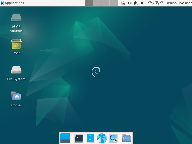

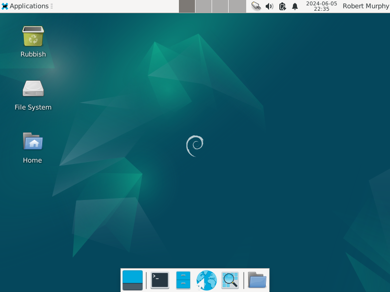

Above after booting into a live session, bottom panel is fully populated, VirtualBox.
Above first boot after being installed, bottom panel is fully populated, ipv6 has been disabled so install doesn't hang, VirtualBox.
Tomorrow I'll test on the hardware and report back, if that appears ok I'll put the image on my google drive if anyone wants to test. If that passes muster I'll work out the "git thing" and make a pull request.
