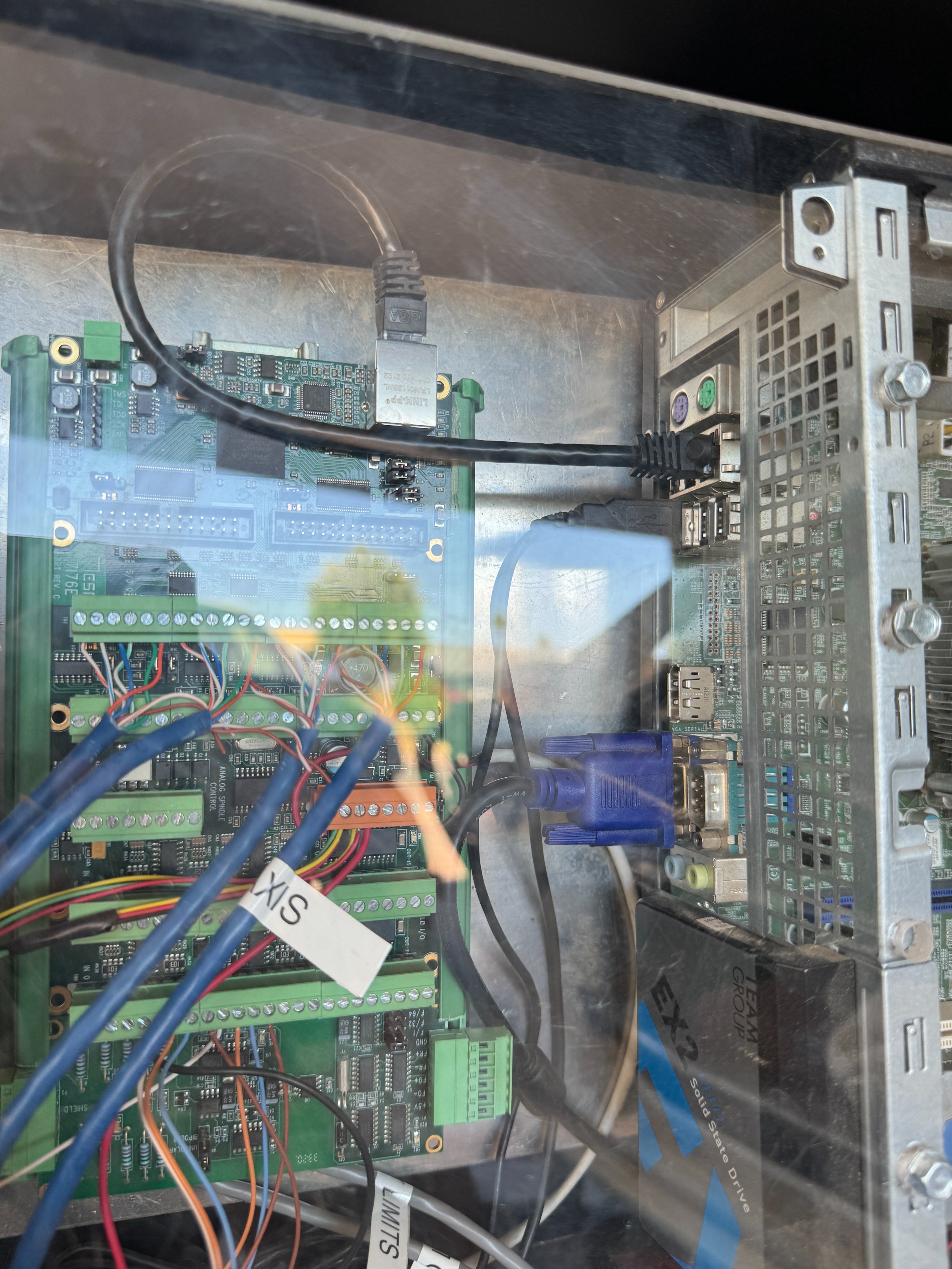

Hey everyone! This is my first post and first time installing and configuring Linuxcnc with a Plasma Table that has four Clearpath servo motors and a MESA 7i76e and THCAD-10. I have reinstalled multiple different versions of Linuxcnc trying to solve my problems. So far the 2.7 stretch version of Linuxcnc connects to the 7i76e just fine and I am able to jog the motors but this version missing the slave axis functions I need for my machine's gantry with two motors. Every single later version of Linuxcnc 2.8 and 2.9 give me network configuration problems but has the slave axis(tandem axis) functions my machine needs. I decided to go with the newest version of Linuxcnc 2.9.2 I went through the pncconf and made a base configuration with IP address 192.168.1.121 now when I open the configuration I get stuck on getting Linuxcnc to start due to this error:

So how is the Mesa wired to the PC? It should be directly wired, not switch or hub or router.
What is the jumper settings on Mesa regarding the IP address?
Did you check the manual?

25 May 2024 22:45 #301449
by RMJ fabrication
Replied by RMJ fabrication on topic Linuxcnc will not connect to MESA 7i76e IP Address
I am not using a network switch and the jumpers are at default position. This is how I have the board connected in the attached.

25 May 2024 23:02 #301450
Replied by Cant do this anymore bye all on topic Linuxcnc will not connect to MESA 7i76e IP Address
What's the IP address of the computer and is the ethernet cable known to be good ?

25 May 2024 23:06 #301451
Replied by tommylight on topic Linuxcnc will not connect to MESA 7i76e IP Address
Probably the same address on the PC, so that might return "connection refused".
Change the 121 at the end to 100.

25 May 2024 23:49 #301454
by RMJ fabrication
I don't know much about networking but when I type "hostname -I"into the terminal to check my computer's IP address I get 192.168.1.121 so they are the same I see now.

26 May 2024 17:02 #301505
by RMJ fabrication
Okay thank you all this info helps a lot. But simply moving the w3 from down to up will not change the board address to 10.10.10.10 alone. Do I basically have to do step 3 like in this post here to change the board address to 10.10.10.10? forum.linuxcnc.org/12-milling/44860-sett...on-a-mesa-card-7i76e

26 May 2024 17:38 #301508
Yes it will, simply changing the jumper will change the board IP, but that is not your issue, you have to change the PC address as you have already done once when you set the IP to 192.168.1.121, but this time set the last part to anything but 121, so 10 or 100 or 200 will work.
