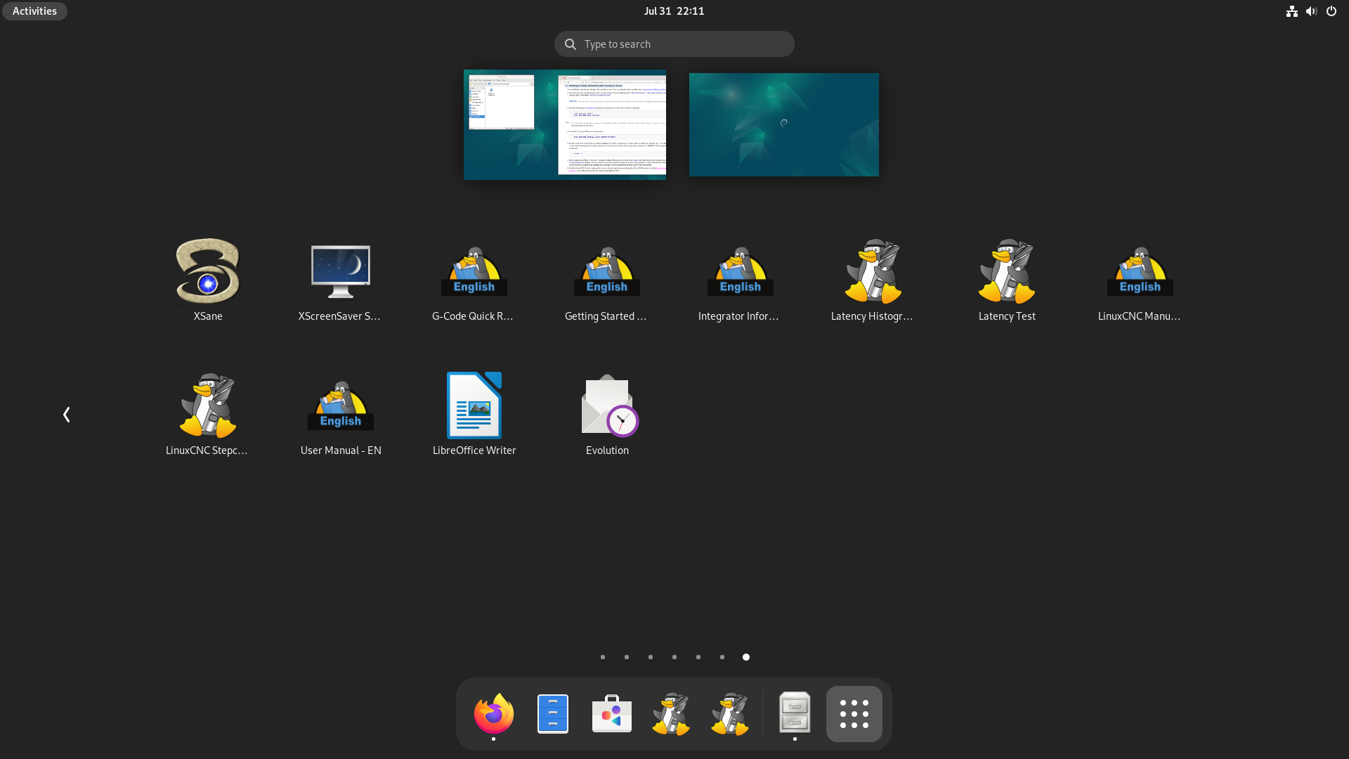

31 Jul 2024 14:19 - 31 Jul 2024 22:17 #306558
by PhilipME
Replied by PhilipME on topic I have full version of debian 12.6 installed on my machine
trying to follow the procedure
when I issue --> sudo apt-get install linux-image-rt-amd64
I get
E: Unable to locate package linux-image-rt-amd64
it looks like my source list has only one line
#deb cdrom:[Debian GNU/Linux 12.6.0 _Bookworm_ - Official amd64 DVD Binary-1 with firmware 20240629-10:19]/ bookworm contrib main non-free-firmware
and I commented it
first editt
I searched and entered the following lines in my source list filedeb deb.debian.org/debian bookworm main non-free-firmware
deb-src deb.debian.org/debian bookworm main non-free-firmware
deb deb.debian.org/debian-security/ bookworm-security main non-free-firmware
deb-src deb.debian.org/debian-security/ bookworm-security main non-free-firmware
deb deb.debian.org/debian bookworm-updates main non-free-firmware
deb-src deb.debian.org/debian bookworm-updates main non-free-firmware
but I still have th same message
second edit :
OK now I am able to execute sudo apt-get install linux-image-rt-amd64
Now I am at this step
Add the LinuxCNC Archive Signing Key to your apt keyring by downloading [the LinuxCNC installer script You will need to make the script executable to run it:
I downloaded the script and executed it
3id edit:
finally installed successfully
thanks rodw
I get
and I commented it
first editt
second edit :
3id edit:
