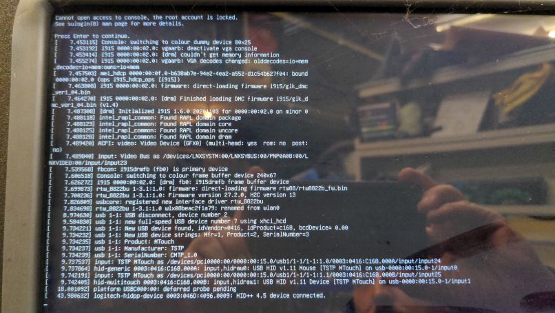

07 Sep 2024 21:17 #309625
by spumco
Replied by spumco on topic USB ports quit working?
If it helps, this is what's displayed when starting in recovery mode.

07 Sep 2024 22:54 #309628
by spumco
Ok, nevermind. Was able to get the files off using a live-usb. Going to reinstall Debian and start with a clean slate.
