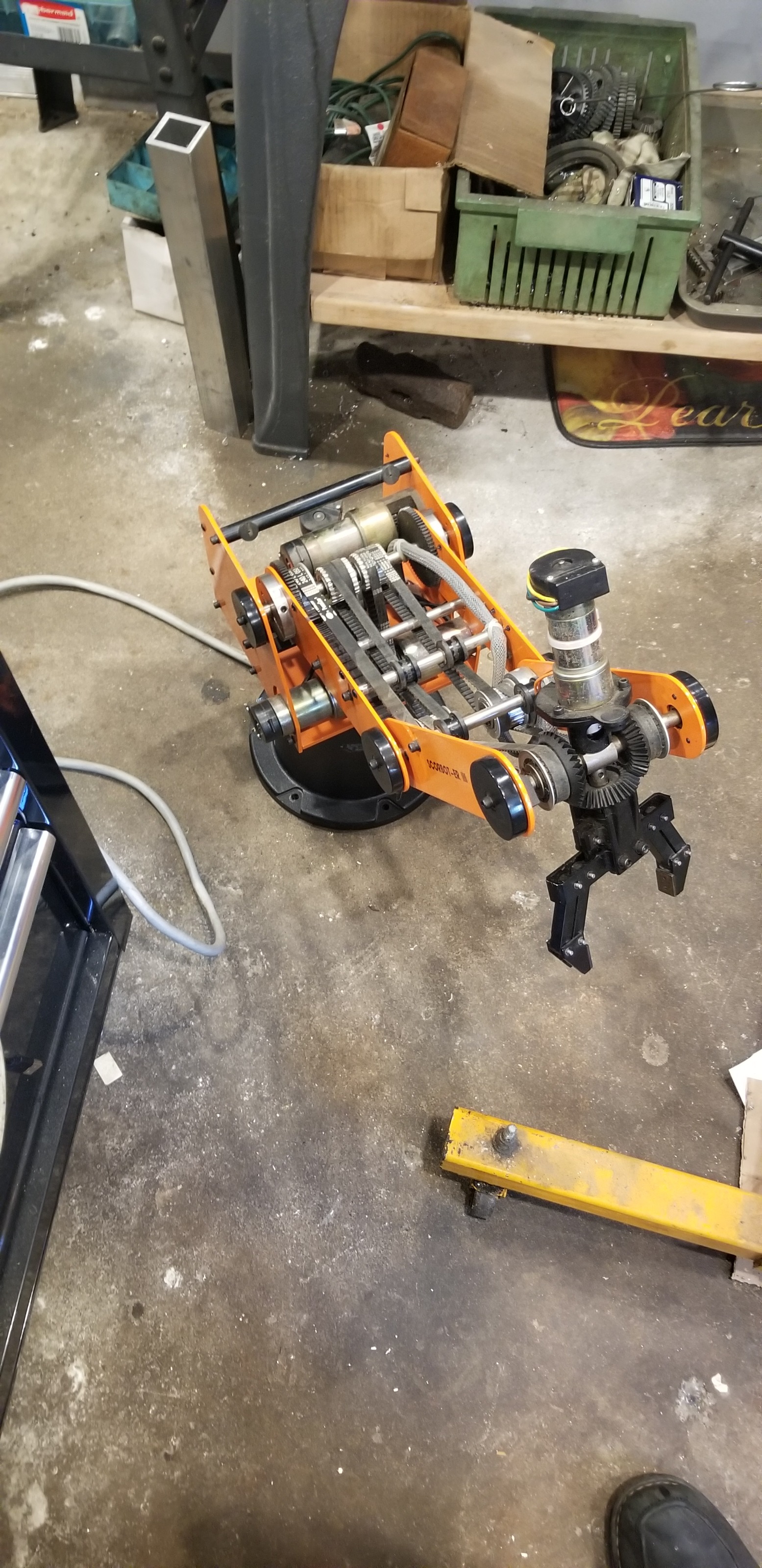

I now have a Dell Optiplex 9010 i5, with a DB25 Parallel Port and a RS232 9pin port. I created a LinuxCNC 2.9.2 live DVD boot disk for it, and are still waiting on a SSD drive to arrive for this computer. I plan on using this computer and LinuxCNC to run my Scorbot-ER-3 Robotic Arm. In my previous question I thought the supplier was sending me a Dell optiplex 980, but shipped the 9010 instead. When I try to run the Scorbot-ER-3 example I get different errors then previously, but believe this is due to no hard drive. Is anyone aware of any LinuxCNC issues with the Scorbot-ER-3 machine example in 2.9.2?
Error report created by /usr/lib/tcltk/linuxcnc/show_errors.tcl:Print file information:RUN_IN_PLACE=noLINUXCNC_DIR=LINUXCNC_BIN_DIR=/usr/binLINUXCNC_TCL_DIR=/usr/lib/tcltk/linuxcncLINUXCNC_SCRIPT_DIR=LINUXCNC_RTLIB_DIR=/usr/lib/linuxcnc/modulesLINUXCNC_CONFIG_DIR=LINUXCNC_LANG_DIR=/usr/lib/tcltk/linuxcnc/msgsINIVAR=inivarHALCMD=halcmdLINUXCNC_EMCSH=/usr/bin/wish8.6LINUXCNC - 2.9.2Machine configuration directory is '/home/user/linuxcnc/configs/by_machine.scorbot-er-3'Machine configuration file is 'scorbot-er-3.ini'INIFILE=/home/user/linuxcnc/configs/by_machine.scorbot-er-3/scorbot-er-3.iniVERSION=1.1check_config: Unchecked: [KINS]KINEMATICS=scorbot-kinsPARAMETER_FILE=sim.varTPMOD=HOMEMOD=TASK=milltaskHALUI=haluiDISPLAY=axisCOORDINATES=X Y Z A BKINEMATICS=scorbot-kinsStarting LinuxCNC...Starting LinuxCNC server program: linuxcncsvrLoading Real Time OS, RTAPI, and HAL_LIB modulesStarting LinuxCNC IO program: ioemc/iotask/ioControl.cc 786: can't load tool table.Starting HAL User Interface program: haluilinuxcnc TPMOD=tpmod HOMEMOD=homemod EMCMOT=motmodFound file(REL): ./scorbot-er-3.halShutting down and cleaning up LinuxCNC...Removing HAL_LIB, RTAPI, and Real Time OS modulesRemoving NML shared memory segmentsDebug file information:Note: Using POSIX realtimeTraceback (most recent call last):  File "/usr/lib/python3/dist-packages/serial/serialposix.py", line 322, in open    self.fd = os.open(self.portstr, os.O_RDWR | os.O_NOCTTY | os.O_NONBLOCK)              ^^^^^^^^^^^^^^^^^^^^^^^^^^^^^^^^^^^^^^^^^^^^^^^^^^^^^^^^^^^^^^PermissionError: [Errno 13] Permission denied: '/dev/ttyS0'During handling of the above exception, another exception occurred:Traceback (most recent call last):  File "/usr/bin/scorbot-er-3", line 56, in <module>    serial = serial.serial_for_url(             ^^^^^^^^^^^^^^^^^^^^^^  File "/usr/lib/python3/dist-packages/serial/__init__.py", line 90, in serial_for_url    instance.open()  File "/usr/lib/python3/dist-packages/serial/serialposix.py", line 325, in open    raise SerialException(msg.errno, "could not open port {}: {}".format(self._port, msg))serial.serialutil.SerialException: [Errno 13] could not open port /dev/ttyS0: [Errno 13] Permission denied: '/dev/ttyS0'./scorbot-er-3.hal:15: waitpid failed scorbot-er-3 scorbot-er-3./scorbot-er-3.hal:15: scorbot-er-3 exited without becoming ready2067Stopping realtime threadsUnloading hal componentsNote: Using POSIX realtime
Info report created by linuxcnc_info:The file:    /tmp/linuxcnc_info.txtcan be posted to a forum or a web site like:     pastebin.comin order to provide information about the linuxcncsystem and configuration.                Date: Tue Sep 24 12:56:51 PM UTC 2024            UTC Date: Tue Sep 24 12:56:51 PM UTC 2024        this program: /usr/bin/linuxcnc_info              uptime: 12:56:51 up 6 min, 2 users, load average: 0.81, 2.06, 1.18     lsb_release -sa: Debian Debian GNU/Linux 12 (bookworm) 12 bookworm            linuxcnc: /usr/bin/linuxcnc                 pwd: /home/user/linuxcnc/configs/by_machine.scorbot-er-3                USER: user             LOGNAME: user                HOME: /home/user              EDITOR:              VISUAL:            LANGUAGE:                TERM: dumb           COLORTERM:             DISPLAY: :0.0             DESKTOP: lightdm-xsession        display size: 1280x1024 pixels (338x270 millimeters)                PATH: /usr/bin:/home/user/linuxcnc/configs/by_machine.scorbot-er-3/bin:/usr/bin:/usr/local/bin:/usr/bin:/bin:/usr/local/games:/usr/gamesuname items:         nodename -n: debian      kernel-name -s: Linux      kernel-vers -v:
24 Sep 2024 12:28 #310722 by tommylight
Replied by tommylight on topic scorbot-er-3
Does the machine use any serial port?
There are again several errors trying to access the serial port called from the scorbot-er-3.hal file, but this time it has no access to it (permission denied), so omit that line in hal.
Or if it has a serial and it has to be used, try searching for
arduino serial port permission denied
to add you user to the "dialout" group.

I believe I have corrected all of the Parallel Port and Serial port issues now. I noticed in the previous video that was posted, he mentioned he was using LinuxCNC Dewey.
below is the error report I get now, please help:

  File "/usr/bin/scorbot-er-3", line 68, in <module>
    serial_write('X')
  File "/usr/bin/scorbot-er-3", line 40, in serial_write
    serial.write(data)
  File "/usr/lib/python3/dist-packages/serial/serialposix.py", line 616, in write
    d = to_bytes(data)
  File "/usr/lib/python3/dist-packages/serial/serialutil.py", line 65, in to_bytes
    raise TypeError('unicode strings are not supported, please encode to bytes: {!r}'.format(seq))
TypeError: unicode strings are not supported, please encode to bytes: 'X'
1381

05 Oct 2024 02:15 - 05 Oct 2024 02:17 #311326 by Aciera
Replied by Aciera on topic scorbot-er-3
looks like '/src/hal/user_comps/scorbot-er-3.py' has not been completely updated to python3 (which might not be an easy task for somebody without the scorbot hardware).
    serial_write('X')
    serial.write(data)
    d = to_bytes(data)
Maybe this could give you an idea about how to fix this particular issue (although there might be others after that):
stackoverflow.com/questions/35642855/pyt...ted-please-encode-to
Last edit: 05 Oct 2024 02:17 by Aciera.
05 Oct 2024 02:20 #311327 by Aciera
_might_ be as simple as changing "/usr/bin/scorbot-er-3", line 40 from this:
serial.write(data)
to:
serial.write(data.encode())

06 Oct 2024 15:54 #311443 by robocidalmaniac
Replied by robocidalmaniac on topic scorbot-er-3
I do not have write access to that file
when i use HALRUN I get the same following error:
~$ halrun
halcmd: loadusr -W scorbot-er-3
serial_write('X')
serial.write(data)
d = to_bytes(data)
<stdin>:1: waitpid failed scorbot-er-3 scorbot-er-3
<stdin>:1: scorbot-er-3 exited without becoming ready
I believe I am also having Python issues please can you tell me when the first LinuxCNC with Scorbot-er-3 version was?
07 Oct 2024 03:17 #311474 by Aciera
Try:
sudo nano /usr/bin/scorbot-er-3
Seems to have been added in Version 2.8

07 Oct 2024 13:49 #311512 by robocidalmaniac
I was able to make the change, and it works now. The 4th axis (3: -1305.7399)     keeps going negative when I try to Home the Scorbot-ER-3 see attached photo.
07 Oct 2024 14:14 #311515 by tommylight
If it is supposed to move the other way when homing, add a - in front of the HOME_SEARCH_VELOCITY in the ini file for that joint.
Might also need to add it to HOME_LATCH_VELOCITY, or it might not.
Wait, does it have homing switches?
