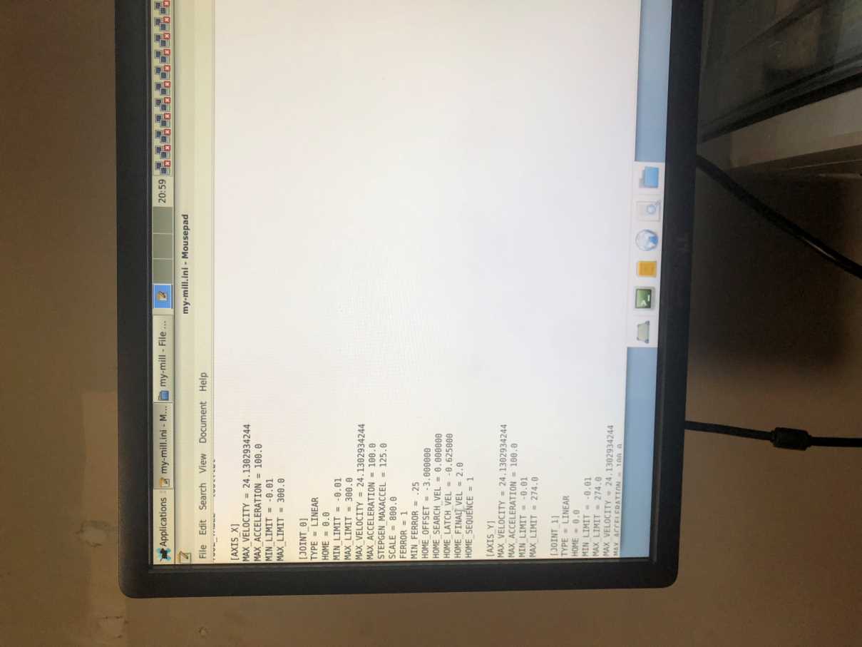

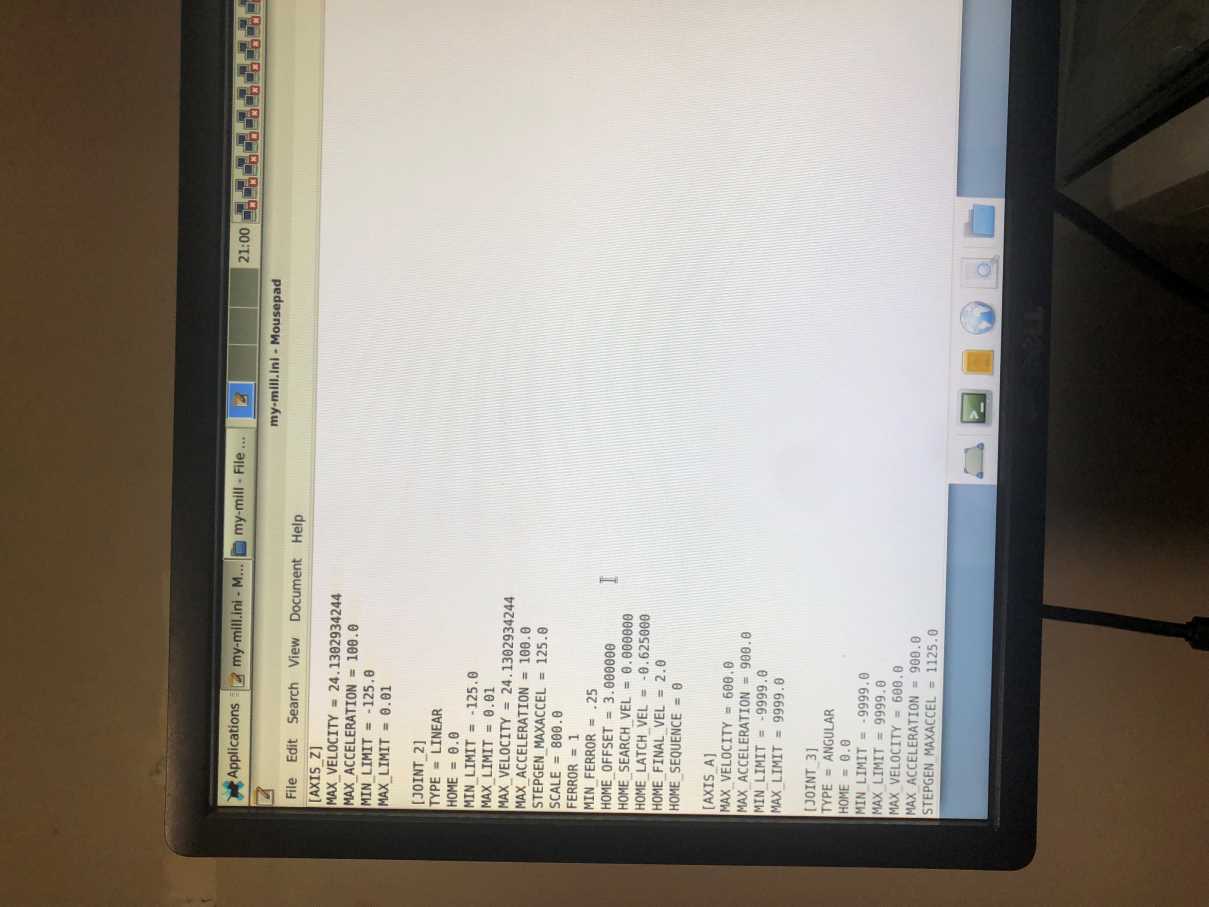

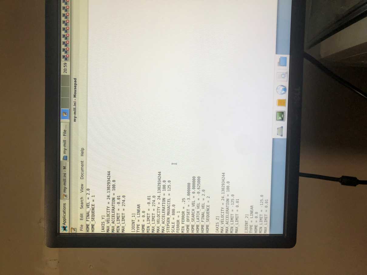

Hi i have done the sequence as in images but still no "home all" button lol, every thing i try brings up an error message and i know the axis are homed but screen error messages insist they are not, think i have a ghost

Hi have added the missing text and also sequenced the axis for homing, dont know if its correct though or whether i have to add anything else either in here or the HAL so could you have a quick look for me. the machine is still sending error messages and still no home all button
Many thanks for your help

Can't see Joint_3 but for the Home_All you need to define a HOME_SEQUENCE number for every joint you have configured.

Ok everyone thank you so much for your help, we now have a home all button and no error messages. I added the code that was suggested for final_vel. The main problem was that the homing needed sequencing which i have done but ommited the A Axis, filled this out on the INI file and hay what do you know. Now we need to work out how to change the speed because when we ran it in air it took off at 90 miles per hour
