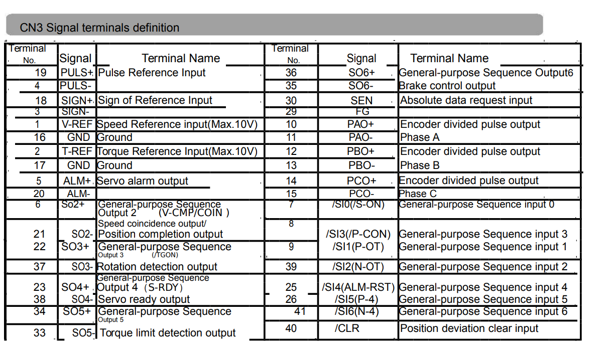

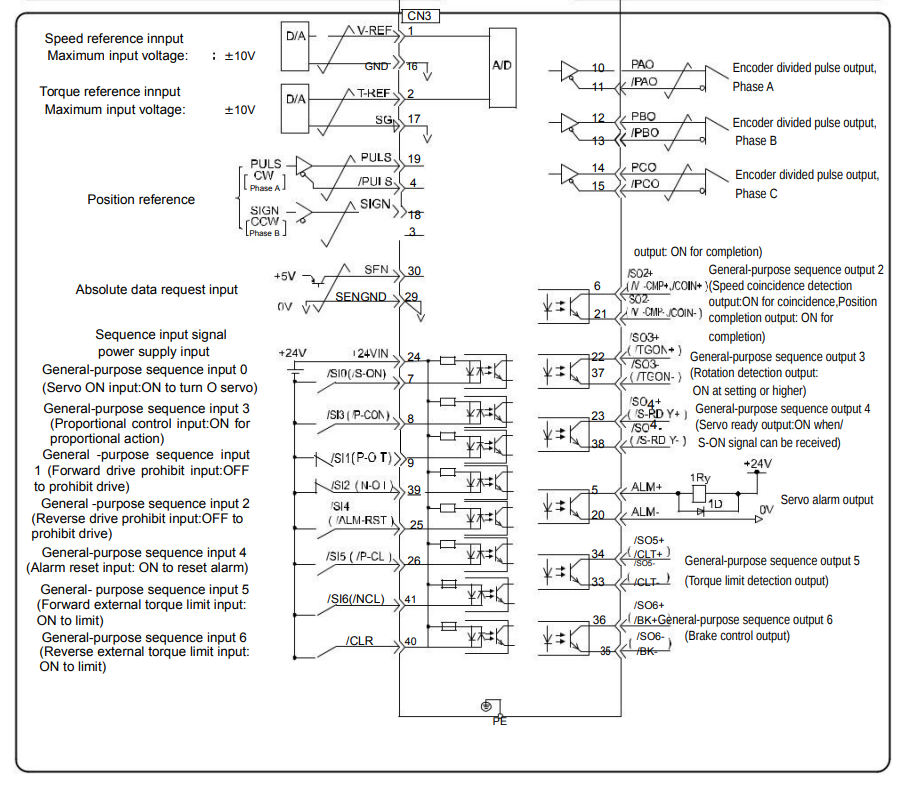

I need help assigning the right wires between the Mesa 7i97t and SG-AS50 servo drive, I read the Mesa manual for the 7I97T and have seen a lot examples that deals with steppers. but cant seem to find information using similar servo drives that I have

As an example of the basic connections for channel 0:
7I97T Drive
AOUT0 TB3.4 V-REF CN3.1
GND TB3.3 GND CN3.16
ENA0+ TB3.2 S-ON CN3.7
ENA0- TB3.1 24V GND
QA0 TB1.1 PA0 CN3.10
/QA0 TB1.2 /PA0 CN3.11
QB0 TB1.4 PB0 CN3.12
/QB0 TB1.5 /PB0 CN3.13
IDX0 TB1.7 PC0 CN3.14
/IDX0 TB1.8 /PC0 CN3.15

23 Sep 2024 13:59 #310668
by akim14
Replied by akim14 on topic Help with Mesa 7I97T card Servo wiring
It makes a lot more sense, now it uses the encoder values from the drive, your the greatest , thank you so much. I was looking for the pulse of reference and the sign of reference all this while

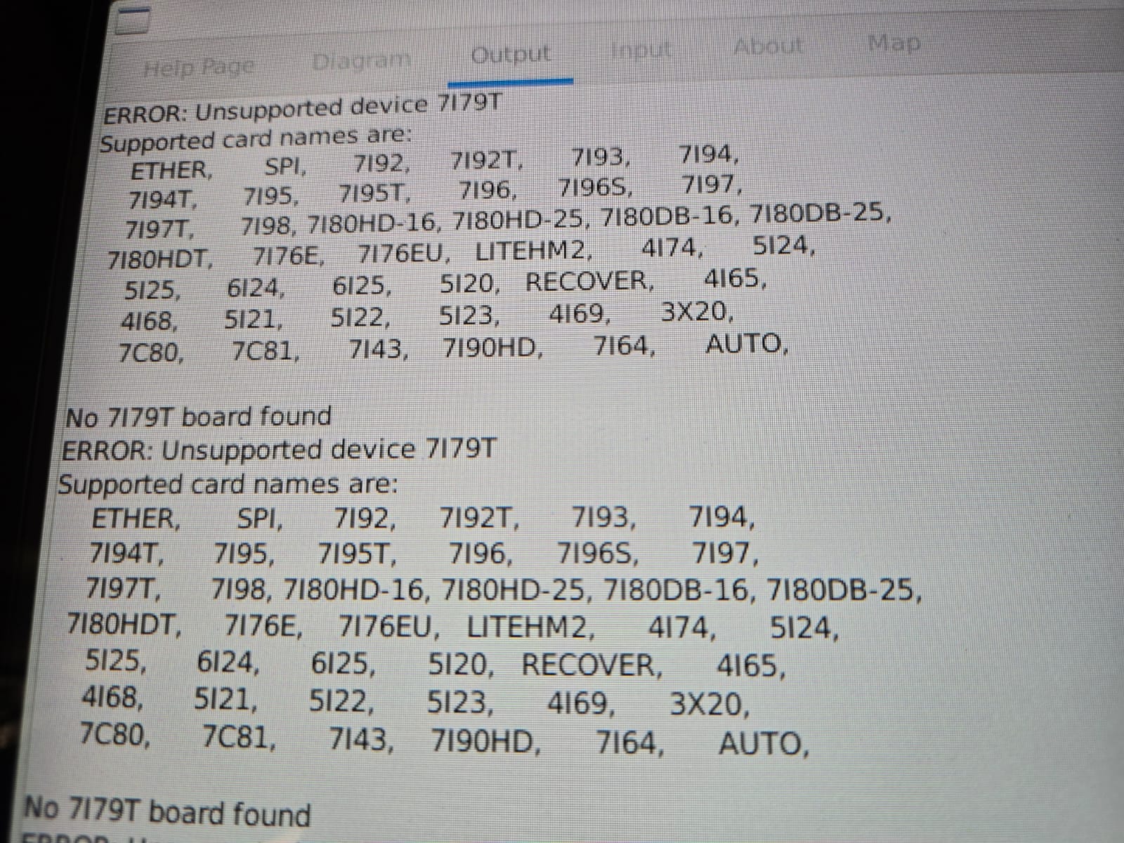

I have another challenge to overcome I cant seem to get the 7I79 board to work it shows that its unsupported,

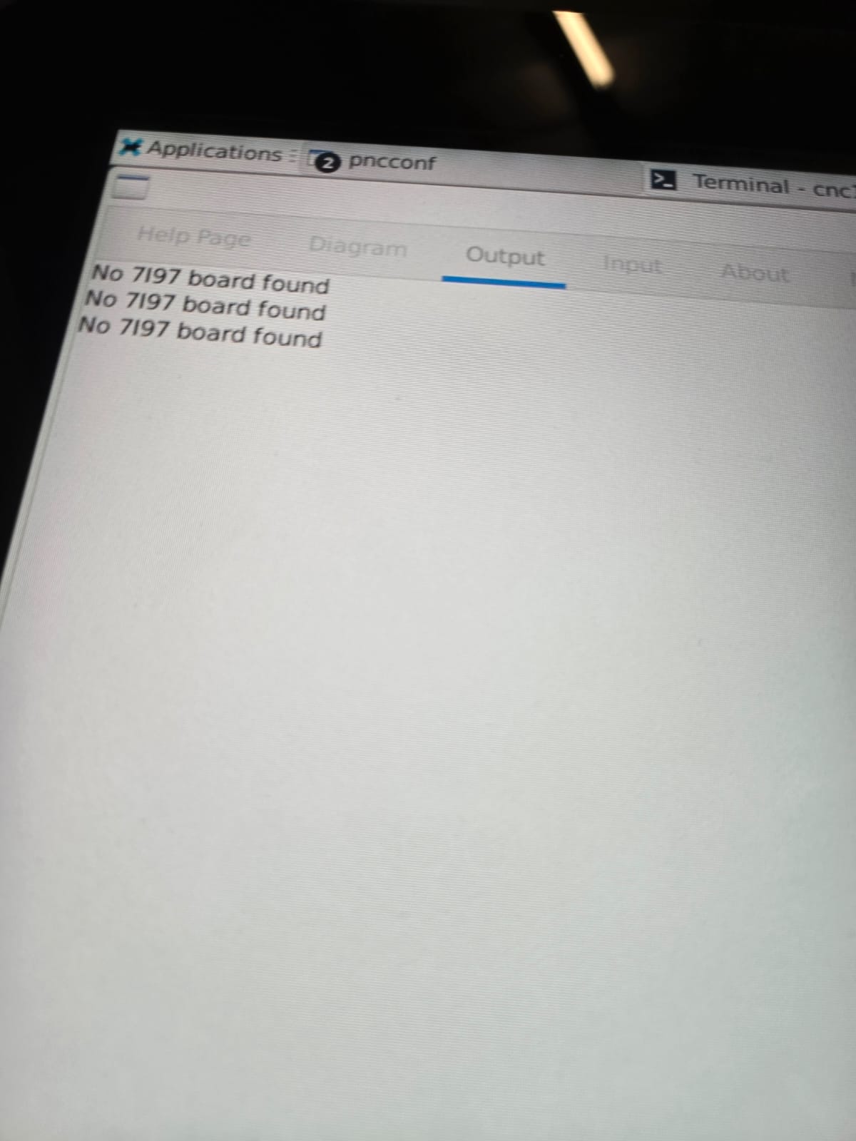

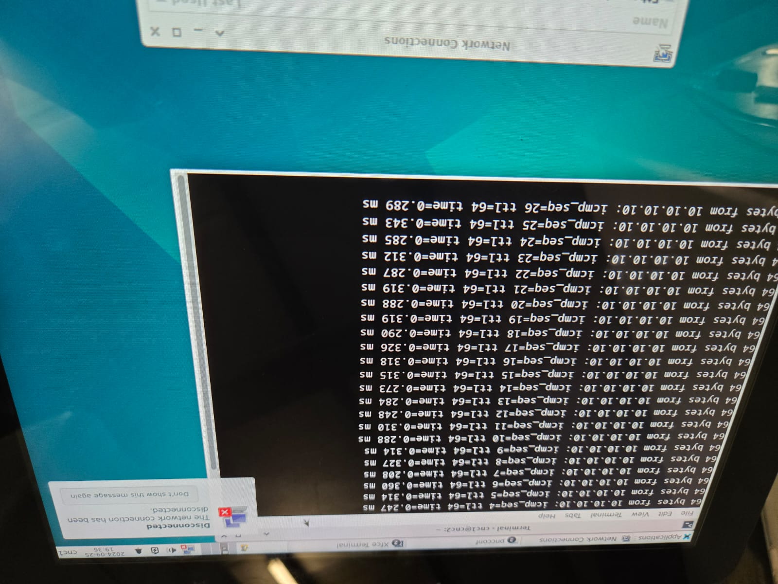

25 Sep 2024 22:40 #310807
by akim14
it was a typo I had to used 7I79T I should just use 7I79, the connection did not work , for some reason the network is interminting

26 Sep 2024 16:09 #310856
Replied by PCW on topic Help with Mesa 7I97T card Servo wiring
If you have a 7I97T you need to have the latest mesaflash
The LinuxCNC ISO includes version is 3.4.9 which does
not support the 7I97T
github.com/LinuxCNC/mesaflash
(build instructions on bottom of page)

I would like to ask how it is created for ENA0+ a
ENA0- voltage +/-10V? Mesa is powered by 5 volts. Is there a step up DC-DC module?
- Posts: 18118
- Thank you received: 5336
28 Sep 2024 14:11 #310994
ENA+ and ENA- pins are just a switch (an optocoupler transistor) intended
for enabling the servo drive (They are "on" when enabled)
The AOUT pins are the +-10V analog outputs. There is a DC-DC converter
on the card for the analog outputs.
