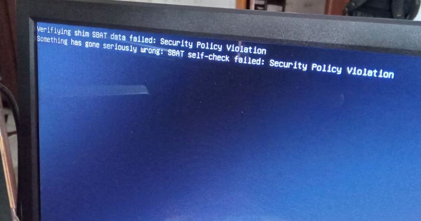

I tried to install LCNC in two desktops from bootable pen-drive and got security policy violation error (refer attached photo). Pen-drive created by Rufus.
Both desktops are windows pre-installed. But the same pen-drive runs the live version ok on an other desktop which has LCNC preinstalled. This is same with LCNC 2.9.2 and 2.9.3.
This is a new issue to me.
Any idea what is going wrong?

Disable "secure boot" in BIOS and enable "CMS" if available .

Solved
