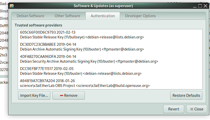

- jjdege
- Posts: 129
- Thank you received: 38
25 Sep 2024 09:53 #310763
by jjdege
Replied by jjdege on topic Module ec_master not found in directory /lib/modules/6.1.0-25-rt-amd64
Hi
have you tried this?
sudo mkdir -p /usr/local/share/keyrings/
wget -O- https://build.opensuse.org/projects/science:EtherLab/signing_keys/download?kind=gpg | gpg --dearmor | sudo dd of=/etc/apt/trusted.gpg.d/science_EtherLab.gpg
sudo tee -a /etc/apt/sources.list.d/ighvh.sources > /dev/null <<EOT
Types: deb
Signed-By: /etc/apt/trusted.gpg.d/science_EtherLab.gpg
Suites: ./
URIs: http://download.opensuse.org/repositories/science:/EtherLab/Debian_12/
EOT
sudo apt update
sudo apt install -y linux-headers-$(uname -r) ethercat-master linuxcnc-ethercat
The following user(s) said Thank You: bkt

just some minute ago ... reading my notes about LMDE6. Ethercat work and modules too because etherlab repo ..... perhaps need to delete any previous ethercat key and gpg.

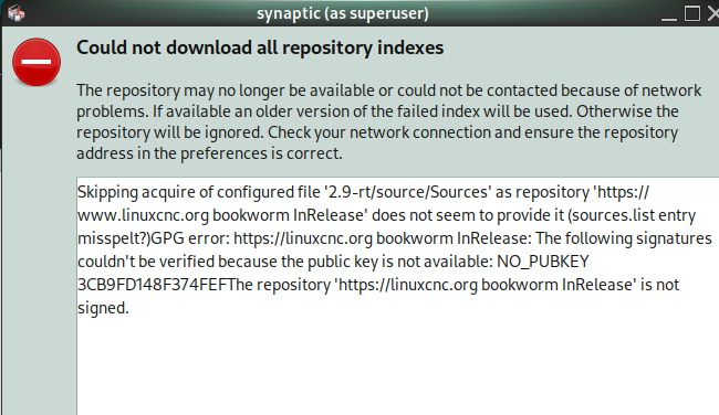

Err:11 https://linuxcnc.org bookworm InRelease
The following signatures couldn't be verified because the public key is not available: NO_PUBKEY 3CB9FD148F374FEF
Reading package lists... Done
W: Skipping acquire of configured file '2.9-rt/source/Sources' as repository 'https://www.linuxcnc.org bookworm InRelease' does not seem to provide it (sources.list entry misspelt?)

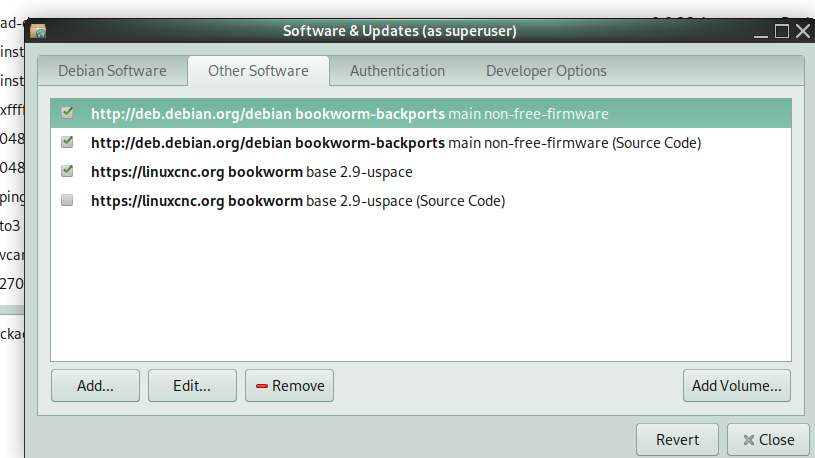

- Posts: 21999
- Thank you received: 7488
25 Sep 2024 14:56 #310778
Replied by tommylight on topic Module ec_master not found in directory /lib/modules/6.1.0-25-rt-amd64
- bkt
- Posts: 1111
- Thank you received: 114
25 Sep 2024 15:36 - 25 Sep 2024 15:40 #310783
by bkt
Replied by bkt on topic Module ec_master not found in directory /lib/modules/6.1.0-25-rt-amd64
sorry not understand .... you suggest to leave out "www.linuxcnc.org bookworm base 2.9-uspace" repo and add "buildbot" instead? After need to reinstall linuxcnc-ethercat think right?
Last edit: 25 Sep 2024 15:40 by bkt.
- Posts: 21999
25 Sep 2024 15:55 #310787
You have not set the public key for the LinuxCNC repository, it is on the page i linked
The following signatures couldn't be verified because the public key is not available: NO_PUBKEY 3CB9FD148F374FEFGetting the archive signing key
To use these packages on your computer, first add the buildbot archive signing key to your apt keychain by running this command in a terminal:
sudo apt-key adv --keyserver hkp://keys.openpgp.org --recv-key EF1B07FEE0EE663E
(Key fingerprint = 4FA2 D1ED 5B2F 38AB 01A4 AB7E EF1B 07FE E0EE 663E)
(An alternative keyserver is keyserver.ubuntu.com)
If you get an error like "GPG: keyserver receive failed: No dirmngr" then install the missing dirmngr package by entering the following in the terminal:
sudo apt-get install dirmngr
If you get an error downloading the key it may be caused by being behind a firewall or a proxy server. Retry by specifying port 80 rather than using the default port (11371):
sudo apt-key adv --keyserver hkp://keys.openpgp.org:80 --recv-key EF1B07FEE0EE663E
(An alternative keyserver is keyserver.ubuntu.com:80)
If you have successfully installed the key then close the terminal.
- bkt
- Posts: 1111
08 Oct 2024 15:59 - 08 Oct 2024 16:00 #311584
by bkt
these problem was solved with buildboot instructions for key
Last edit: 08 Oct 2024 16:00 by bkt.
