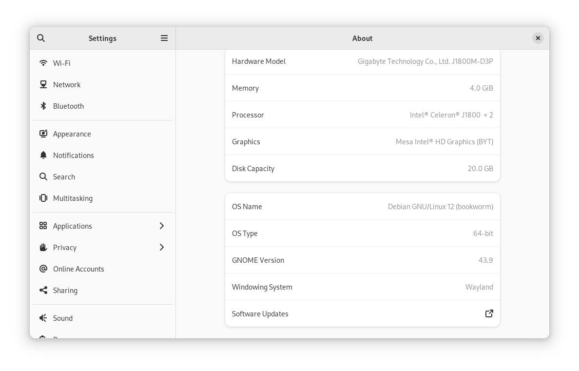

Couple of months ago I installed Linuxcnc rip on an intel i5 4the generation it installed flowlesslly. Try not to skip any steps, take your time don't rush otherwise you will have start all over again.
[edit] OOPS just realized that you loaded linuxcnc. You must start with Debian 12 os only nothing else.

16 Oct 2024 15:00 #312272
by marq_torque
Hello Benb,
I have installed fresh Debian 12 and following the instruction in PDF,This is the result in first few commands

Replied by marq_torque on topic linuxcnc-dev is missing?
Hello Benb,

16 Oct 2024 20:27 - 16 Oct 2024 20:30 #312297
by Benb
Replied by Benb on topic linuxcnc-dev is missing?
Hi marq. I use the internet while following he instruction by cuting and passing from the pdf file. I dont use cd roms.
I only use usb key to burn debian12 using rufus, after that all the debian installation is done through the internet, same for preempt and linux cnc rip all files are loaded through the internet.
Once you get Debian running open a shell (command window) cut tfrom he pdf command and past them nto command line. And try not to skip steps
Dont try to upload files from cd rom they are probley no compatible with existing filesd. Use one and only command window until you complete the procedure

17 Oct 2024 23:25 #312444
by Benb
It looks like you have debian in your e drive and its trying read files from it.

18 Oct 2024 15:17 - 18 Oct 2024 15:20 #312524
by marq_torque
Hello Benb,
I was able to reach till here

checking for glib... configure: error: no -- required until somebody makes glib optional
cnc@cnc:~/dev/linuxcnc/src$
Is there any possibility to install Linuxcnc-Dev in standard 2.9.3 installation?
