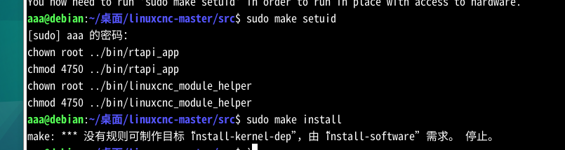

Dear fellow members
I encountered a problem while installing and compiling Linuxcnc from the source code. ./ configure and make can proceed smoothly, but there was an error with make install: there are no rules to create the target‘ install kernel dep’, which was stopped by the ’install software‘ requirement.
how can i slove it.

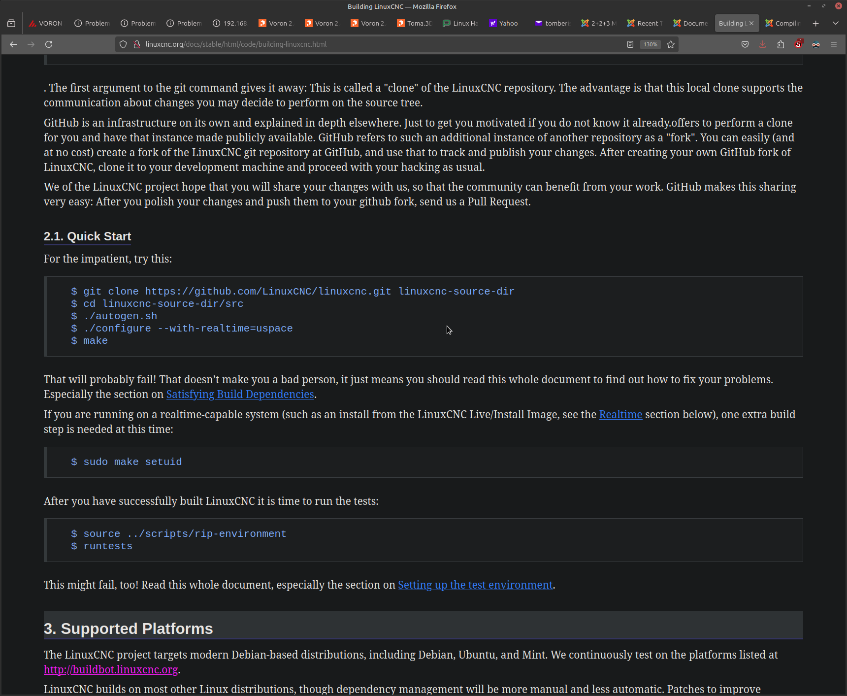

21 Oct 2024 21:38 #312819
Replied by tommylight on topic Compiling linuxcnc with source code on Debian12 resulted in an error
The following user(s) said Thank You: Unlogic, yuyu

22 Oct 2024 08:02 #312849
After setting the RIP environment, does linuxcnc start?
Just type linuxcnc and hit enter.

22 Oct 2024 20:59 - 22 Oct 2024 21:47 #312923
by yuyu
Replied by yuyu on topic Compiling linuxcnc with source code on Debian12 resulted in an error
Thank you, it can run smoothly now.

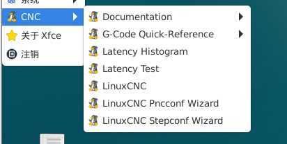

I guess it failed because there were Chinese characters in my installation path.Now I want to try how to directly start LinuxCNC and Stepconf Wizard on the desktop, without having to set up the environment in the terminal every time, as shown in the picture.

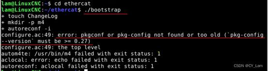

./bootstrap
%If the downloaded tar.bz package contains an m4 subdirectories, this step is not required; Git clone is necessary

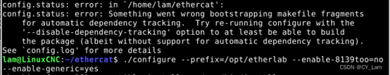

In progress/ When bootstrap, the following error may be reported, as shown in Figure 1
At this point, you need to use the following command to install pkg config.
sudo apt-get install pkg-config
Continue with the installation.

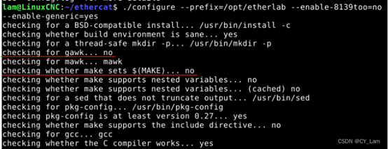

When executing again, if the result prompts an error, as shown in the figure below, you need to flip over to see where the 'no' appears, as shown in the figure below
To resolve the error, it is necessary to install gawk and make, using the following code.
sudo apt-get install gawk make

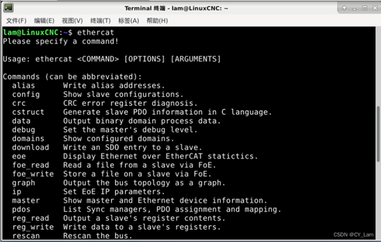

At this point, the configuration is basically complete. You can enter the following code to try starting the main station
sudo /etc/init.d/ethercat start
At this time, it will return
Starting EtherCAT master 1.6.0-rc1 done
Enter the following code to view the main station information
sudo ethercat master
