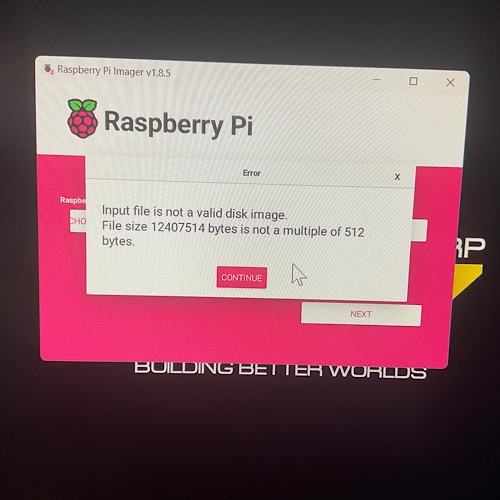

by Jdolecki
Pi image to pi 4 was created by Jdolecki

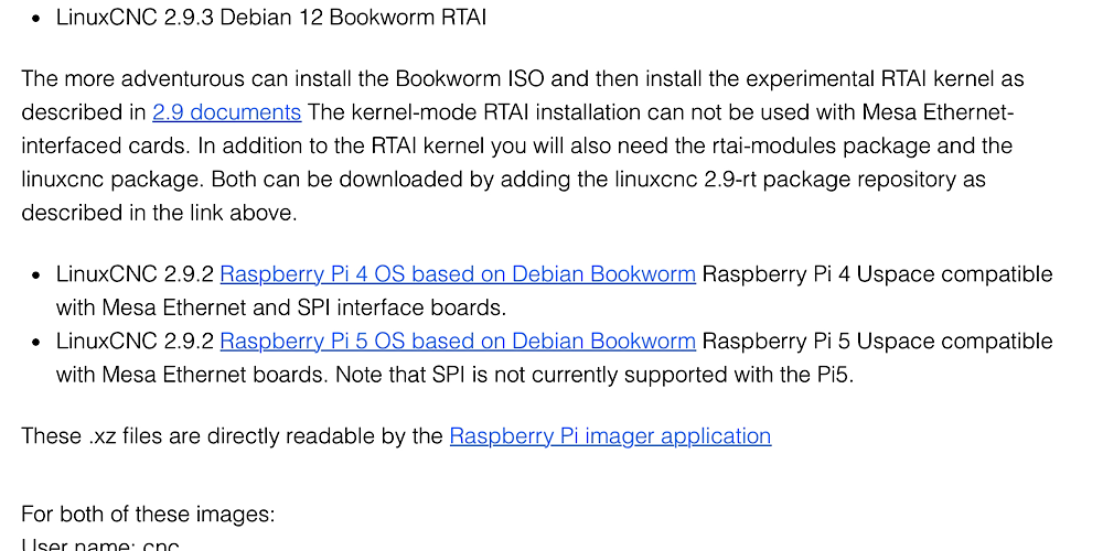

28 Dec 2024 21:16 #317588
by Jdolecki
Replied by Jdolecki on topic Pi image to pi 4
I used the image on Linux cnc download page
And below it said use raspi imager,

29 Dec 2024 03:05 #317594
Replied by rodw on topic Pi image to pi 4
As cornholio says, use balena etcher and it will install. A bug in the upstream installer we use broke the rspi Imager which is not as robust as etcherI used the image on Linux cnc download page

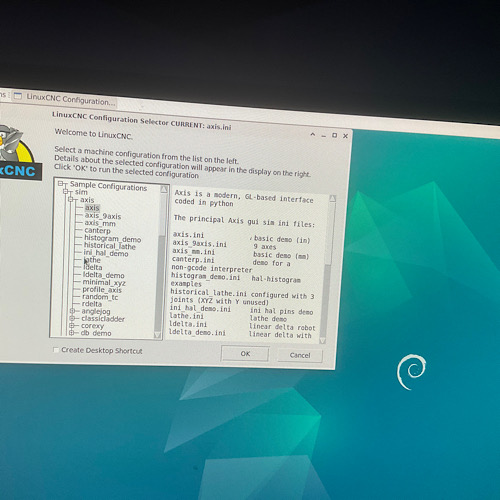

30 Dec 2024 20:36 #317697
by Jdolecki
So my laptop running win 11 won’t do it correctly
My laptop running win 10 was totally different acting when downloading the file.
I already had etcher installed.
Worked flawleslly .
