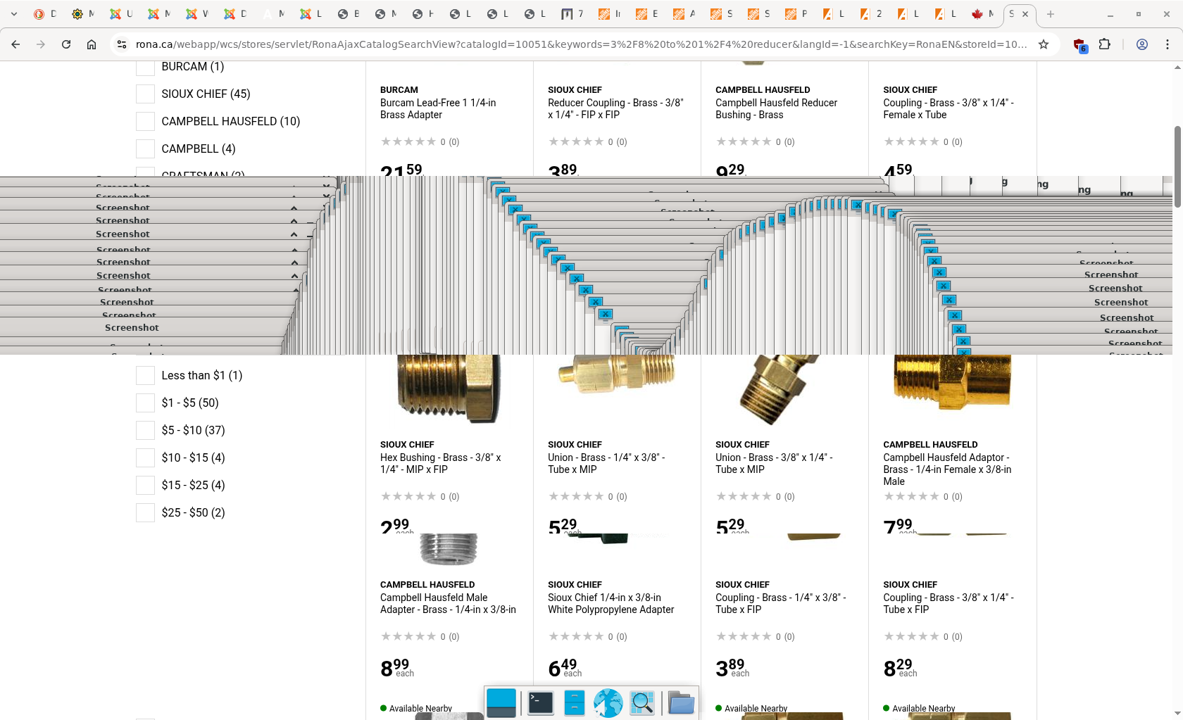

The official LinuxCNC 2.9.4 image for arm64 is installed on a Raspberry Pi 400. There are strange partial graphical glitches in browsers, such as some pages or partial horizontal section of the page not displaying properly, while the rest is fine.

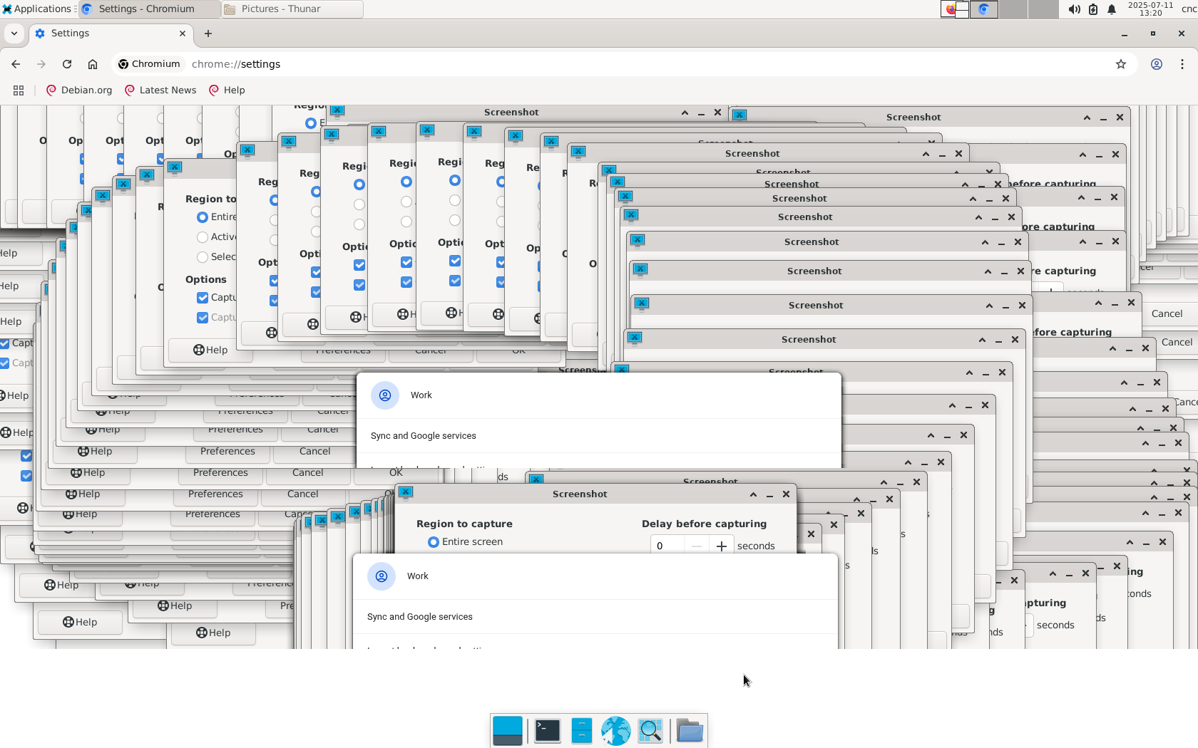

This was tested with Firefox ESR, but Chromium was also installed, and for example, the settings page for Chromium never displays properly. It would appear the underlying text and buttons/links are present but not visible, except by sometimes mousing over them.

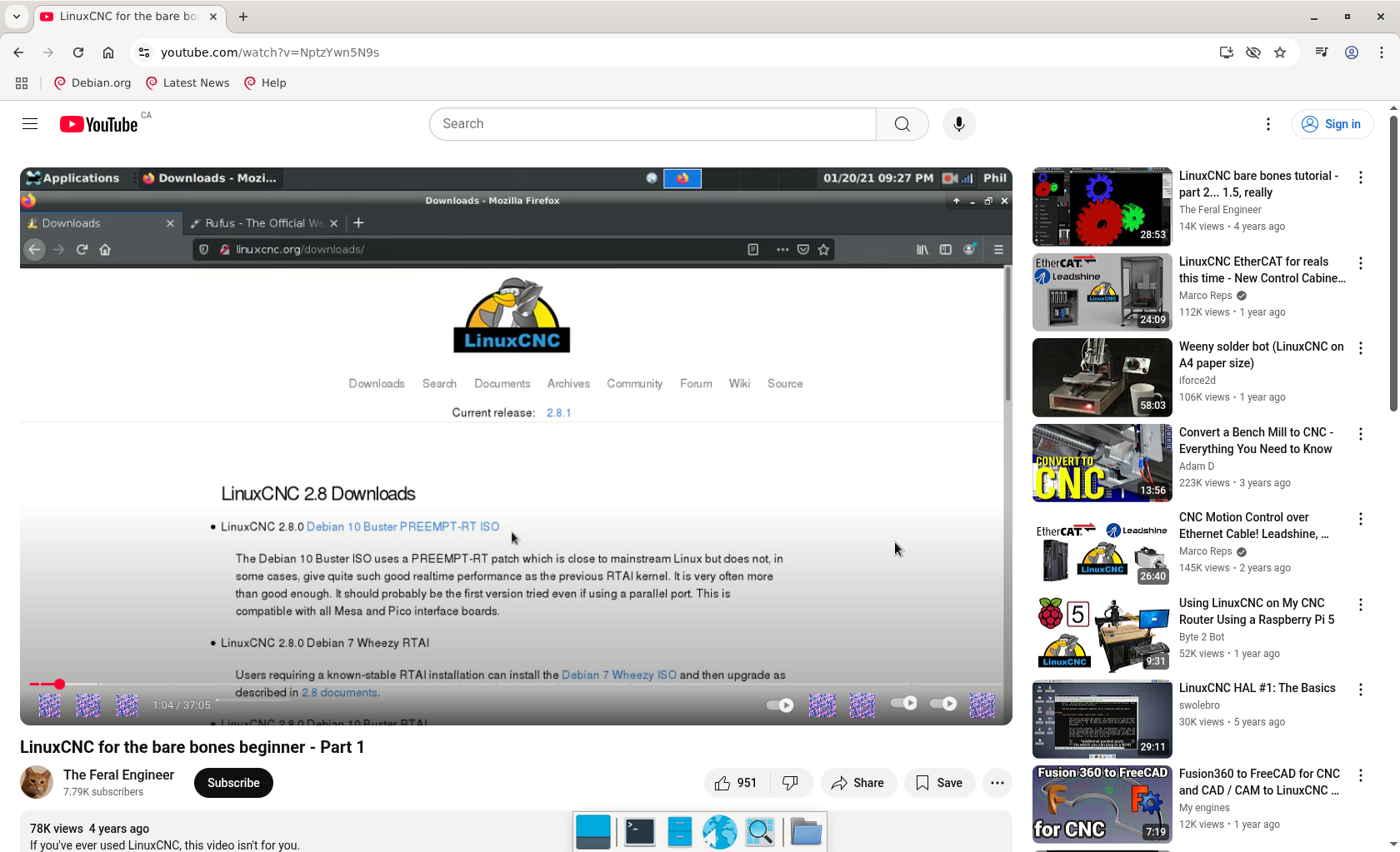

The problem appears to be only in browsers, not other applications. Youtube in either browser is also unusable, with graphical glitches on the player controls (YT buttons like play/pause/settings are either invisible or look corrupt).

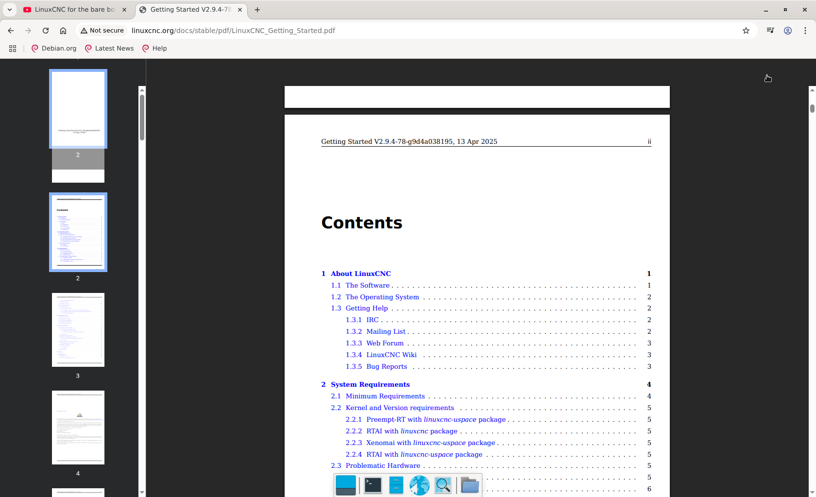

Similarly, when opening PDF documents in browsers, the control buttons along the top of the document for Zoom/Download/Save etc are often invisible, but still present if moused over.

The first screenshot shows a horizontal section of the web page with corrupted graphics. The second is chromium's setting page which never displays correctly. The third is a pdf document opened in chromium, with the controls (download, zoom, etc) at the top not showing. The fourth shows the graphical glitches in the Youtube player controls (buttons for play, pause, settings, etc).
They work in Firefox (very slow though, which is why I installed chromium) so perhaps this is not an issue specifically with LinuxCNC's image, though I can't tell. I don't have these issues with chromium on the other RPi OS images, but I have not tried debian 12 directly. I imagine that also precludes hardware issues. The monitor is a 22" Dell at 1680x1050, though I doubt that is too relevant.
