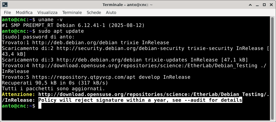

23 Aug 2025 07:03 #333789
by jjdege
Replied by jjdege on topic Debian Trixie upgrade/install to 2.9.4
Good morning,
I followed Rodw's instructions (thanks, Rodw), and upgraded from Bookworm to Trixie.
I can say that everything is fine. I only had two problems:
Several packages weren't installing automatically; they were always in the update list.
I installed them manually and solved the problem.
The Network Manager GUI in the top-right panel wouldn't start, and it was impossible to manage the network
with a graphical interface.
I solved the problem by searching online.
The thing that worries me is the warning that appears after I update from the terminal.
What does this warning mean?
- Posts: 12159
- Thank you received: 4150
23 Aug 2025 07:49 #333790
Replied by rodw on topic Debian Trixie upgrade/install to 2.9.4
Great feedback. Nothing to worry about. The etherlabmaster's certificate in their repository only has a life of 2 years. If you are not using ethercat, there is nothing to worry about. It is outside of our control.

23 Aug 2025 08:26 #333792
by jjdege
Thanks Rodw
I use EtherCAT, so I'm worried!
Is there a chance that etherlabmaster will decide not to update the certificates?
If so, what's the best course of action?
- Posts: 12159
23 Aug 2025 11:37 #333796
Last time it expired, they fixed it when I asked them to so nothing to worry about.
