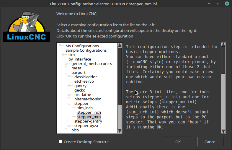

- Posts: 21959
- Thank you received: 7478
22 Jun 2026 15:25 #347222
Replied by tommylight on topic Installing LinuxCNC RTAI
Run one of the included configs for parallel port, if those run you are OK.

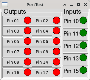

- ClimbingMike
- Posts: 3
22 Jun 2026 19:26 #347242
by ClimbingMike
Replied by ClimbingMike on topic Installing LinuxCNC RTAI
Hello Tommy:
thank you for the fast reply.
I am not sure which config your referencing to?
There is this PortTest demo.
Do you have the path to the config script. Because under the
/usr/realtime-5.4.258-rtai-amd64
bin calibration modules share testsuite
This is all i see and thing to do with config
thanks
Mike
