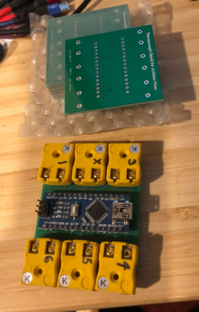

24 Nov 2021 00:00 #227457 by andypugh
This is the chip I was suggesting:
uk.rs-online.com/web/p/instrumentation-amplifiers/1923153/
LinuxCNC has a driver.

Though I also have a bunch of these PCBs going spare which an Arduino Nano can be soldered to along with 6 of the MAX31855 chips:
I don't seem to be able to find the schematics or Gerbers, though.
