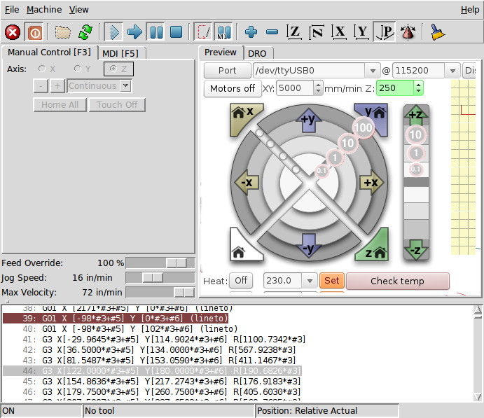

Hi, my question is, is there any 3D printer GUI in LinuxCNC .

Besides extrusion slider in Klipper, and that is easy to do in VCP, so are fans and most other stuff.
Any idea how it should look ?

The difference is for those who don't know how to program, it will be easy for them and there are people who want to use linuxcnc for 3D printing and laser but there is no GUI for it so they find it deficult configure.

Axis GUI is easier and simpler than any laser or 3D printing PC software.
So just adding a VCP panel should do.
I use it for my scratchers/engravers that are the same as lasers.

Ive been playing with an axis mod for 3dprinter. I was adding some sliders , maybe like a cold extrusion prevention or something, but Ive ever used pronterface as reference.
What control features were you looking for, to make linuxcnc easier for laser and 3d printing?
