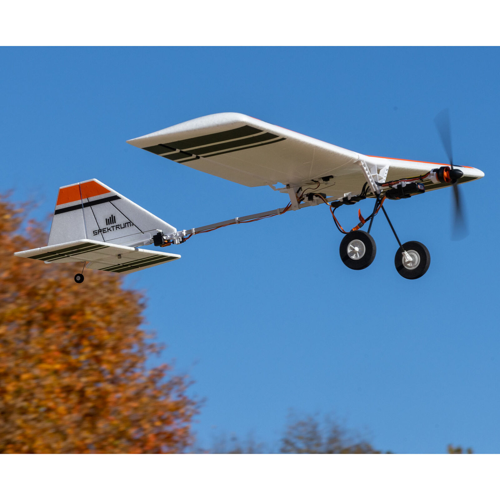

I am about as healed as I am going get..As far as R/C stuff goes, I am building my own version or the Slow Ultra Stick. I will have
to take some pics of it's current state. As it sits right now I don't have a main wing built for it yet but as soon as I have the cnc foam
cutter finished and setup, I will. I am basically building it as a trainer / FPV type craft. Unfortunately it's well past the 250 gram don't
have to register it limit. so I do have to go through extra grief to make it all legal to fly. ( Thanks FAA ) That said I did get in a
flying club so I don't have to worry about remote I.D.
