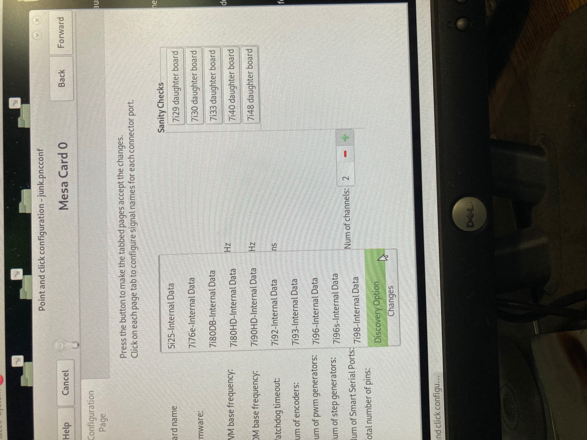

Hi...I am not sure how to update firmware..have it downloaded but not sure how to make available to choose in pncconfig....
Thanks for any help!!
- Posts: 18063
- Thank you received: 5308
20 Aug 2024 17:25 #308232
Replied by PCW on topic Open Configuration tool issue
You update firmware with mesaflash, something like
mesaflash --device 7i96s --addr [mesa_card_ip_addr] --write 7i96s_5abobd.bin --reload
Where [mesa_card_ip_addr] is 192.168.1.121 or 10.10.10.10 depending on how
you have the 7I96S configured

Thanks so much.....finally got it!! ... Now on to a million other things to do.
