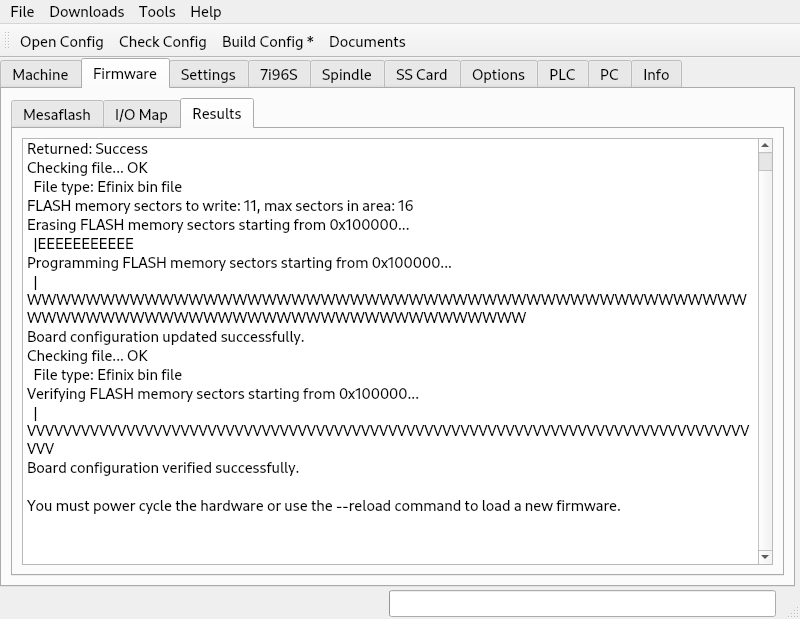

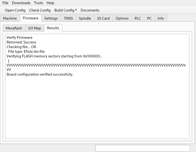

That error message is what mesaflash returns, mesact just prints the result of the command.I see the exact same issue with 7I97T+7I76: I've flashed and verified the firmware using mesaflash, and I also copied those firmware files to local/lib/libmesact .
When I use MesaCT and select the firmware and click "VERIFY" I receive a similar message to the one the OP posted.

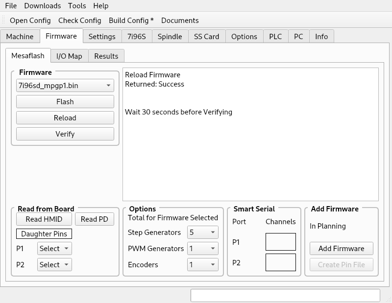

I downloaded the firmware file and copied the bin and pin file to the .local/lib/libmesact/7i96s and flashed, reloaded then verified so I suspect they skipped reloading.I wonder if there is a file name error of some kind?

I changed the verify button enable so after a successful flashing the verify button is disabled until a successful reload.
