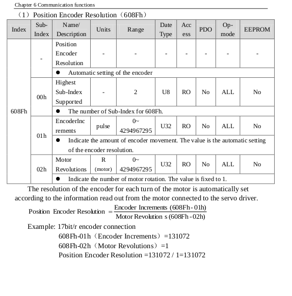

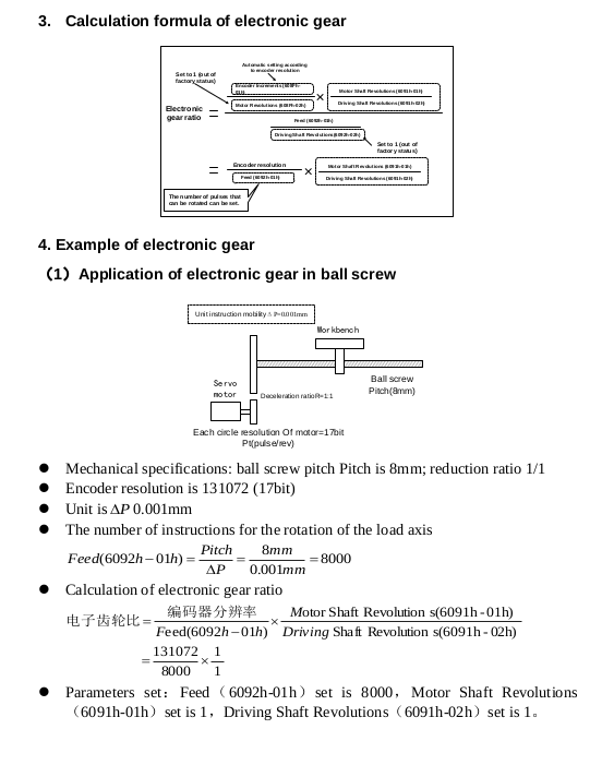

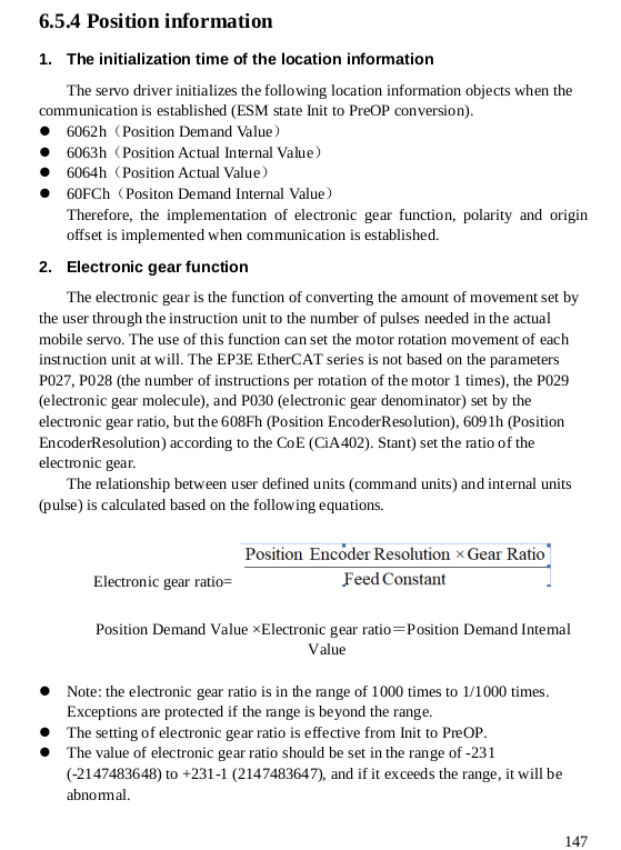

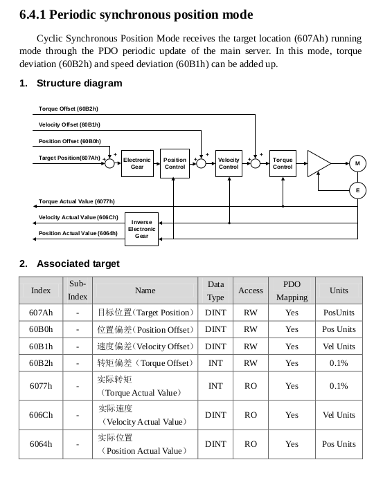

After many and many attempts, I put back the synchro position mode. I'm carrying a piece of xml. I have a mechanical reduction of 37.5 my drive has a resolution of 131672 puls / rev (17bit) and with this hal and ini configuration I get the required movement of + and - 90 ° on my joint .... what is it that I don't have I got it? In fact, the scale factor on the xml file was reached by attempts without any apparent logic .... the method escapes me even if I have reached the goal.
My xml file:
My pieces of .hal file:
My piece of ini file for X axes for example (other is the same):
Drive is Maxine EP3 in attach some interesting manual page ... for sure value of position is in Dint .... not sure these infuences the system ... I assumed that the conversion to float is automatic.
