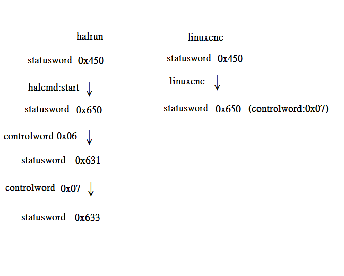

- rogerz6217
- Posts: 1
27 Jan 2016 20:29 #69166
by rogerz6217
Replied by rogerz6217 on topic Ethercat HAL driver
Dear all,
This is my halrun cmd, everthing goes well.
However, when i use .hal file with linuxcnc, the statusword stuck in 0x650 no matter how i set the controlword.
My .hal file as below.
The change of statusword as below.
Thanks for help.
halcmd: loadrt threads name1=master period1=1000000
halcmd: loadusr -W lcec_conf /home/lab428/hiwin.xml
halcmd: loadrt lcec
halcmd: addf lcec.read-all master
halcmd: addf lcec.write-all master
halcmd: start
setp lcec.0.0.drivecontrol-1 1
setp lcec.0.0.drivecontrol-2 1
setp lcec.0.0.drivecontrol-0 1However, when i use .hal file with linuxcnc, the statusword stuck in 0x650 no matter how i set the controlword.
#load the XML config & the ethercat hal parser.
loadrt lcec
#load the motion component
loadrt trivkins
loadrt [EMCMOT]EMCMOT base_period_nsec=[EMCMOT]BASE_PERIOD servo_period_nsec=[EMCMOT]SERVO_PERIOD num_joints=[TRAJ]AXES
#add the function we need to the servo-thread
addf lcec.read-all servo-thread
addf lcec.write-all servo-thread
#set the control word to 6 and the state will be ready to switch on.
#check if the state is in OP mode then enable emc and go to switched on state.
net ready_to_switch lcec.state-op => iocontrol.0.emc-enable-in => lcec.0.0.drivecontrol-0The change of statusword as below.
Thanks for help.

- sirop
- Posts: 193
- Thank you received: 57
28 Jan 2016 12:05 - 28 Jan 2016 12:06 #69189
by sirop
If your slave understands SDO commands ( and PDO ampping), then you can use a shell script with Etherlab SDO commands
like:
www.iram.fr/~blanchet/ethercat/akd/examples/akd_free_pdo.sh -- example for Kollmorgen CoE slave
github.com/sirop/EtherCAT_HAL/blob/master/setPDO.sh -- example fro Copley CoE slave
Replied by sirop on topic Ethercat HAL driver
Hello
Another question about the el7041: is there a way to do the commissioning part (current limit and nominal voltage settings) through LinuxCNC and this driver?
I had a successful test run on a motor but I had to do this part through TwinCAT since I didn't know how to do it through our setup.
I was wondering that maybe someone here does.
I would ideally like to bypass using TwinCAT; quite user friendly but I'd have to switch every time I change the parameters and it poses some limits on the hardware as well (works only with intel chipsets as far as I know).
like:
Last edit: 28 Jan 2016 12:06 by sirop. Reason: typo

- sirop
- Posts: 193
28 Jan 2016 12:30 #69191
by sirop
I did not follow your previous comments and I do not know your slave.
So my quick guess: if it is not about improper slave configuration, then it can be a timing issue.
Suppose, your control word is always set (one cycle ?) too late?
To gain more control about this try
either
wiki.linuxcnc.org/cgi-bin/wiki.pl?Etherlab (LinuxCNC, RTAI)
or
github.com/sirop/EtherCAT_HAL/blob/master/pdortapi2dc.comp (Machinekit, Xenomai/RT-Preempt ) .
Dear all,
My .hal file as below.#load the XML config & the ethercat hal parser. loadusr -W lcec_conf /home/lab428/hiwin.xml loadrt lcec #load the motion component loadrt trivkins loadrt [EMCMOT]EMCMOT base_period_nsec=[EMCMOT]BASE_PERIOD servo_period_nsec=[EMCMOT]SERVO_PERIOD num_joints=[TRAJ]AXES #add the function we need to the servo-thread addf lcec.read-all servo-thread #check if the state is in OP mode then enable emc and go to switched on state. net ready_to_switch lcec.state-op => iocontrol.0.emc-enable-in => lcec.0.0.drivecontrol-0
Thanks for help.
either
or
