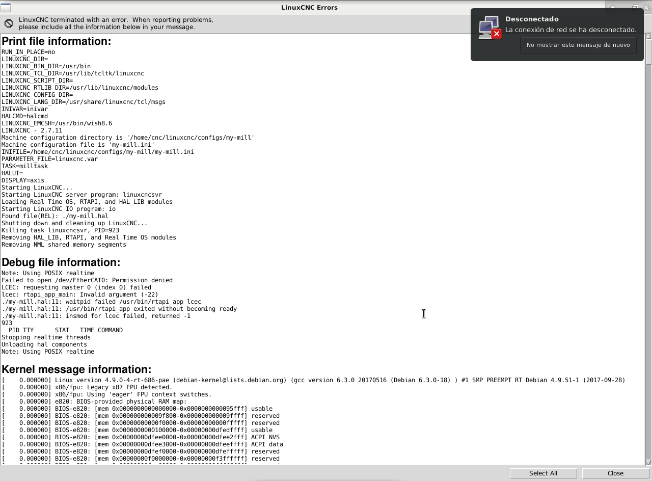

11 Nov 2017 10:11 #101650
by chimeno
Replied by chimeno on topic Ethercat HAL driver
hi Sirop,
if this works, now I have a new error "open / dev / EtherCAT0: Permission denied"
lack of permission? I give permission so?
echo KERNEL == \ "EtherCAT [0-9] * \", MODE = \ "0664 \"> /etc/udev/rules.d/99-EtherCAT.rules
after this it does not work either.
how can I solve that?
Thank you
Thank you

11 Nov 2017 11:42 #101652
by sirop
Replied by sirop on topic Ethercat HAL driver
The following user(s) said Thank You: chimeno

14 Nov 2017 19:08 - 14 Nov 2017 19:11 #101797
by chimeno
Hello sirop
I have been comparing and searching but I can not give linuxcnc permissions to EtherCAT0, this is what I have done.
sudo -i
echo KERNEL == "EtherCAT [0-9] *", MODE = "0664", GROUP = "ethercat"
directory /etc/udev/rules.d/ ...ok
What am I doing?
sudo -i
What am I doing?

14 Nov 2017 20:06 - 14 Nov 2017 20:06 #101799
by sirop
So what is the contents of 99-ethercat.rules now?
Last edit: 14 Nov 2017 20:06 by sirop. Reason: typo

15 Nov 2017 04:50 #101815
by chimeno
Hi Sirop,
The content of the 99-ethercat.rules file is :
KERNEL=="EtherCAT[0-9]*", MODE="0664", GROUP="ethercat"
thanks
thanks

15 Nov 2017 09:57 #101827
by sirop
That should work if you installed github.com/sittner/ec-debianize.
Otherwise:
KERNEL ==" EtherCAT [0 -9]*" , MODE ="0664" , GROUP ="users"
Hi Sirop,
thanks
Otherwise:

17 Nov 2017 12:29 #101926
by chimeno
hi Sirop,
thank you very much, now if it works well, I will start to try. I tried to install github.com/sittner/ec-debianize but I lacked dependencies, so get it installed manually.

Nov 21 11:40:18 computer kernel: [ 7792.916591] EtherCAT 0: Domain 0: 7 working counter changes - now 46/75.
Nov 21 11:40:21 computer kernel: [ 7795.391418] EtherCAT 0: Domain 0: Working counter changed to 48/75.
Nov 21 11:40:21 computer kernel: [ 7795.397407] EtherCAT ERROR 0-12: AL status message 0x001B: "Sync manager watchdog".
Nov 21 11:40:21 computer kernel: [ 7795.401410] EtherCAT 0-12: Acknowledged state SAFEOP.
Nov 21 11:40:21 computer kernel: [ 7795.618032] EtherCAT ERROR 0-13: AL status message 0x001B: "Sync manager watchdog".
Nov 21 11:40:21 computer kernel: [ 7795.622024] EtherCAT 0-13: Acknowledged state SAFEOP.
Nov 21 11:40:22 computer kernel: [ 7796.391729] EtherCAT 0: Domain 0: 7 working counter changes - now 50/75.
Nov 21 11:40:26 computer kernel: [ 7800.809280] EtherCAT WARNING 0-13: Slave did not sync after 5000 ms.
Nov 21 11:40:26 computer kernel: [ 7800.816267] EtherCAT 0: Domain 0: Working counter changed to 52/75.
Nov 21 11:40:26 computer kernel: [ 7800.826249] EtherCAT ERROR 0-14: AL status message 0x001B: "Sync manager watchdog".
Nov 21 11:40:26 computer kernel: [ 7800.830243] EtherCAT 0-14: Acknowledged state SAFEOP.
Nov 21 11:40:26 computer kernel: [ 7800.965014] EtherCAT ERROR 0-15: AL status message 0x001B: "Sync manager watchdog".
Nov 21 11:40:26 computer kernel: [ 7800.968011] EtherCAT 0-15: Acknowledged state SAFEOP.
Nov 21 11:40:27 computer kernel: [ 7801.818581] EtherCAT 0: Domain 0: 7 working counter changes - now 54/75.
Nov 21 11:40:31 computer kernel: [ 7806.061420] EtherCAT WARNING 0-15: Slave did not sync after 5000 ms.
Nov 21 11:40:31 computer kernel: [ 7806.066417] EtherCAT 0: Domain 0: Working counter changed to 56/75.
Nov 21 11:40:31 computer kernel: [ 7806.073399] EtherCAT ERROR 0-16: AL status message 0x001B: "Sync manager watchdog".
Nov 21 11:40:31 computer kernel: [ 7806.075395] EtherCAT 0-16: Acknowledged state SAFEOP.
Nov 21 11:40:31 computer kernel: [ 7806.185210] EtherCAT ERROR 0-17: AL status message 0x001B: "Sync manager watchdog".
Nov 21 11:40:31 computer kernel: [ 7806.187206] EtherCAT 0-17: Acknowledged state SAFEOP.
Nov 21 11:40:32 computer kernel: [ 7807.066731] EtherCAT 0: Domain 0: 7 working counter changes - now 58/75.
Nov 21 11:40:37 computer kernel: [ 7811.282616] EtherCAT WARNING 0-17: Slave did not sync after 5000 ms.
Nov 21 11:40:37 computer kernel: [ 7811.287613] EtherCAT 0: Domain 0: Working counter changed to 60/75.
Nov 21 11:40:37 computer kernel: [ 7811.294595] EtherCAT ERROR 0-18: AL status message 0x001B: "Sync manager watchdog".
Nov 21 11:40:37 computer kernel: [ 7811.296591] EtherCAT 0-18: Acknowledged state SAFEOP.
Nov 21 11:40:37 computer kernel: [ 7811.410399] EtherCAT ERROR 0-19: AL status message 0x001B: "Sync manager watchdog".
Nov 21 11:40:37 computer kernel: [ 7811.412395] EtherCAT 0-19: Acknowledged state SAFEOP.
Nov 21 11:40:38 computer kernel: [ 7812.287928] EtherCAT 0: Domain 0: 7 working counter changes - now 62/75.
Nov 21 11:40:38 computer kernel: [ 7813.079587] EtherCAT ERROR 0-20: AL status message 0x001B: "Sync manager watchdog".
Nov 21 11:40:38 computer kernel: [ 7813.082583] EtherCAT 0-20: Acknowledged state SAFEOP.
Nov 21 11:40:38 computer kernel: [ 7813.195389] EtherCAT ERROR 0-21: AL status message 0x001B: "Sync manager watchdog".
Nov 21 11:40:38 computer kernel: [ 7813.197385] EtherCAT 0-21: Acknowledged state SAFEOP.
Nov 21 11:40:39 computer kernel: [ 7813.290238] EtherCAT 0: Domain 0: 8 working counter changes - now 66/75.
Nov 21 11:40:39 computer kernel: [ 7813.307201] EtherCAT ERROR 0-22: AL status message 0x001B: "Sync manager watchdog".
Nov 21 11:40:39 computer kernel: [ 7813.309197] EtherCAT 0-22: Acknowledged state SAFEOP.
Nov 21 11:40:39 computer kernel: [ 7813.419012] EtherCAT ERROR 0-23: AL status message 0x001B: "Sync manager watchdog".
Nov 21 11:40:39 computer kernel: [ 7813.421008] EtherCAT 0-23: Acknowledged state SAFEOP.
Nov 21 11:40:39 computer kernel: [ 7813.534818] EtherCAT ERROR 0-24: AL status message 0x001B: "Sync manager watchdog".
Nov 21 11:40:39 computer kernel: [ 7813.537815] EtherCAT 0-24: Acknowledged state SAFEOP.
Nov 21 11:40:39 computer kernel: [ 7813.649641] EtherCAT 0: Slave states on main device: OP.
Nov 21 11:40:40 computer kernel: [ 7814.292561] EtherCAT 0: Domain 0: 14 working counter changes - now 75/75.It gets reconnect automatically but it doesn't work for me because I would need to make homing again.
Some parameters:
appTimePeriod="1000000"
refClockSyncCycles="100"
<dcConf assignActivate="300" sync0Cycle="*1" sync0Shift="0"/>
Any idea why is this happening ?

21 Nov 2017 13:26 - 21 Nov 2017 13:27 #102130
by sirop
You could "play" with sync0Shift if you know what you are doing,
but to my mind an even worse sourse of jitter is concealed in github.com/sittner/linuxcnc-ethercat/blo...c_main.c#L1119-L1132
As you seeeach time the Ethercat HAl thread is called. So if your HAL thread has latency/jitter, then this latency/jitter is inherited to EtherCAT process.
To say more: this snippet above shows how to sync slaves' clocks to the master clock. It would be better to do the opposite: to sync the master clock to a DC of a slave as the slave has a hardware ( more precise) clock. There must be a solution for this somewhere on the etherlab list.
master->app_time += master->app_time_period;
ecrt_master_application_time(master->master, master->app_time);
// sync ref clock to master
if (master->sync_ref_cycles > 0) {
if (master->sync_ref_cnt == 0) {
master->sync_ref_cnt = master->sync_ref_cycles;
ecrt_master_sync_reference_clock(master->master);
master->sync_ref_cnt--;
// sync slaves to ref clock
ecrt_master_sync_slave_clocks(master->master);As you see
master->app_time += master->app_time_period;To say more: this snippet above shows how to sync slaves' clocks to the master clock. It would be better to do the opposite: to sync the master clock to a DC of a slave as the slave has a hardware ( more precise) clock. There must be a solution for this somewhere on the etherlab list.
