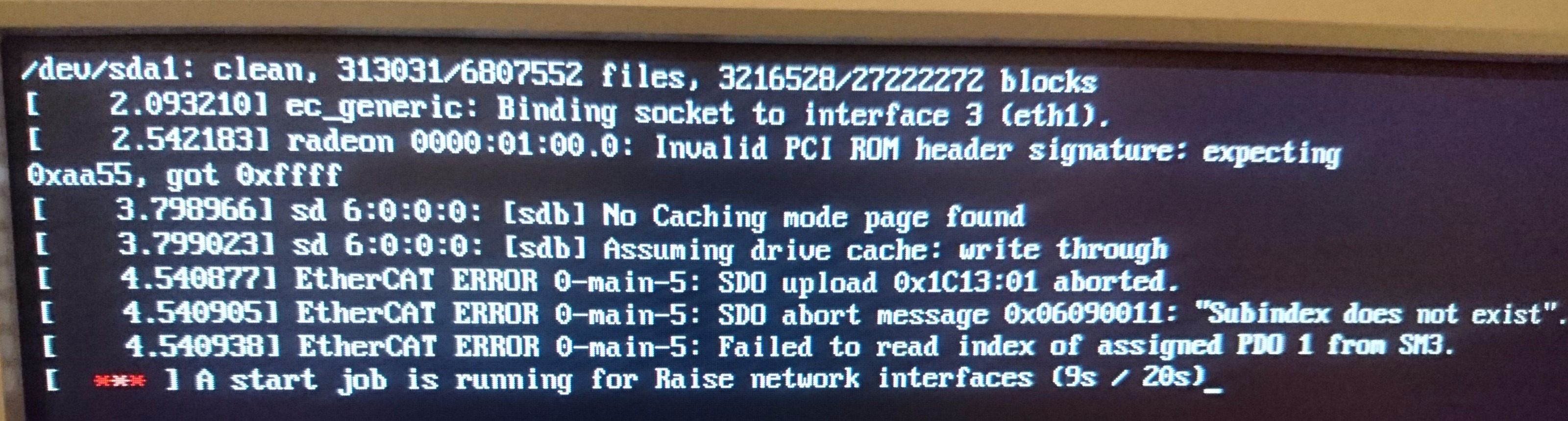

22 Feb 2020 21:15 #158240 by jirkam
Replied by jirkam on topic Ethercat HAL driver
Hi
Still waiting 90 seconds. But I don't mind that much.
Rather, I need to solve the PREOP for EL4004.
If anyone had any advice I would be very happy.
Thank you.

23 Feb 2020 20:11 #158325 by chimeno
Replied by chimeno on topic Ethercat HAL driver
Hi @jirKam,
Can you try only this module?
Does TWINCAT3 work for you?

23 Feb 2020 21:17 #158330 by jirkam
Hi @chimeno.
Thank you for your response.
The module itself is also PREOP.
Twincat I tried only version "2". But I couldn't connect. I also wondered if there is a problem in the module. I will try to download Twincat 3. Which version should I download? There are 10 pieces.
Thank you.
Jirka
24 Feb 2020 09:52 - 24 Feb 2020 10:27 #158367 by jirkam
Hi @chimeno
"It is OP" !!! :)
I tried "EtherCAT_Configurator" and found that "#define LCEC_EL4004_PID 0x0fc23052" in the "lcec_el40x4.h" file does not match.
I wrote "0x0fa43052". And it works.
But I still have errors when I start my PC. And I don't know what to do with it.
Can you advise me?
Thank you very much.
Jirka

24 Feb 2020 21:12 - 24 Feb 2020 21:36 #158421 by chimeno
Hi @Jirka
I am very happy that everything works, I only have EL4034, in relation to the error, it seems an error in the device number 5, although I am not sure why it gives you error when starting the PC.
TwinCAT 3.1 – eXtended Automation Engineering (XAE) 3.1.4024.7
to see the error messages you can use the command
dmesg
greeting
Chimeno
Last edit: 24 Feb 2020 21:36 by chimeno. Reason: Edit
24 Feb 2020 21:26 #158422 by jirkam
Hi @chimero
Thank you very much for your support.
Where can I copy text that is on PC startup? I won't have to do .jpg.
Jirka
