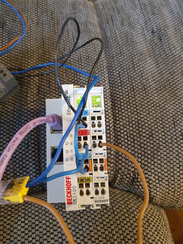

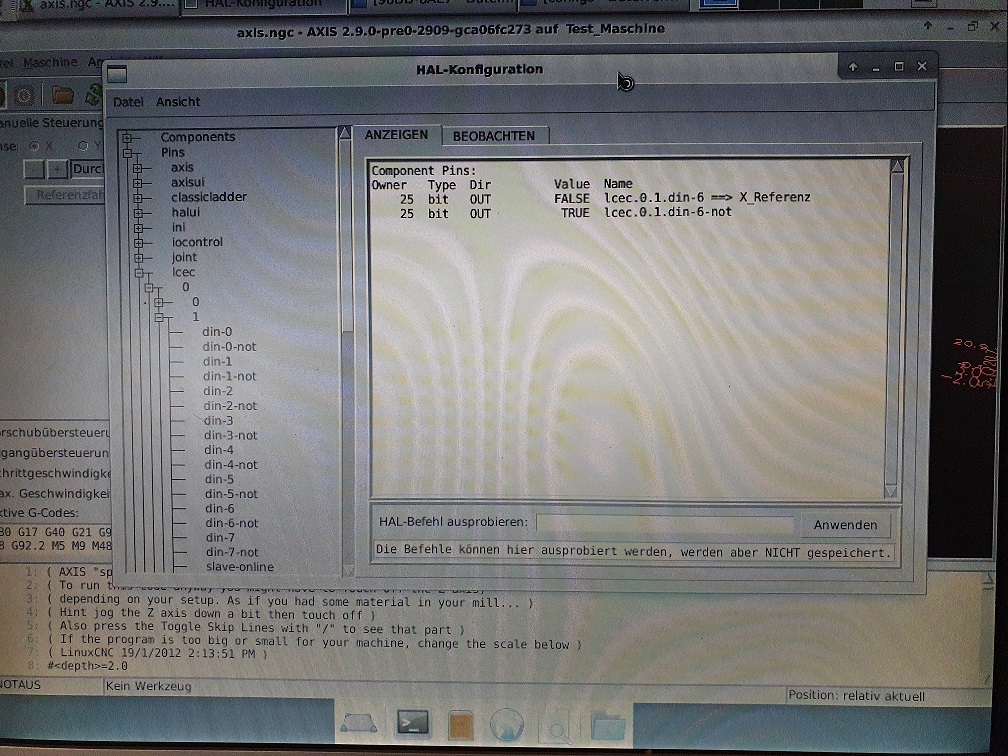

29 Oct 2020 09:24 - 29 Oct 2020 14:09 #187668
by Korbi
Replied by Korbi on topic Ethercat HAL driver
I checkt my configs a few times and found my misstake. Highsignal stays on PIN 3
Hello,
i use a Beckhoff EK1100 and as DI EL1008
now i have some problems on my hal, ini or xml
in my machine hal config is lcec.0.1.din-6´s dir as oUT
I think it has to be IN.
can someone look at my configs and tell me what iam doing wrong?
Ethercat is working
ethercat slaves -v

Hello,
Ethercat is working
