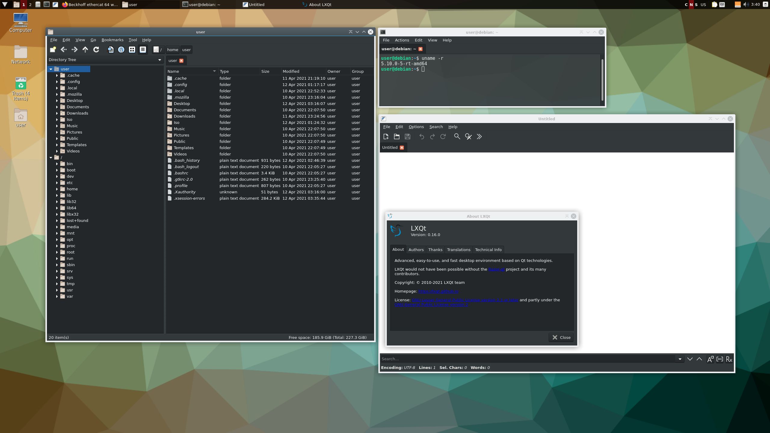

09 Apr 2021 13:14 #205427 by V-max
Hi Grotius,
I was unable to install and run Debian with EtherCat by me own and following your advice I installed this distro.
Questions:
Is there any forum with doubts?
With this distro, is it need to do something special to start Ethercat?
"avc@debian:~$ ethercat slaves
Failed to obtain number of masters: Failed to open master device /dev/EtherCAT0: No such file or directory"
Inside the readme.txt says to install without username and password, I was unable,Is it possible in Debian?
Inside : applitation/CNC/ there is two Linuxcnc Installation but noone Rip
Thank you in advantage

12 Apr 2021 07:36 - 12 Apr 2021 07:44 #205708 by Grotius
Only leave blanco the root name and leave blanco root passwd.
Just fill in the username and userpasswd.
If you done this incorrect. The succes with ethercat and other software will fail.
It is my fault it is mentioned not good enough at the readme page.
In my new outcomming distro, this will be much easyer. Trough a preceed.cfg file, i can customize the debian installer that you
only have to fill in the username + userpasswd. Root entry's will not be visible anymore during installation process.
Announcement upcoming very cool distro. I am focussing on a preconfigured desktop environment, etc. Switched the xfce desktop to something with more future.

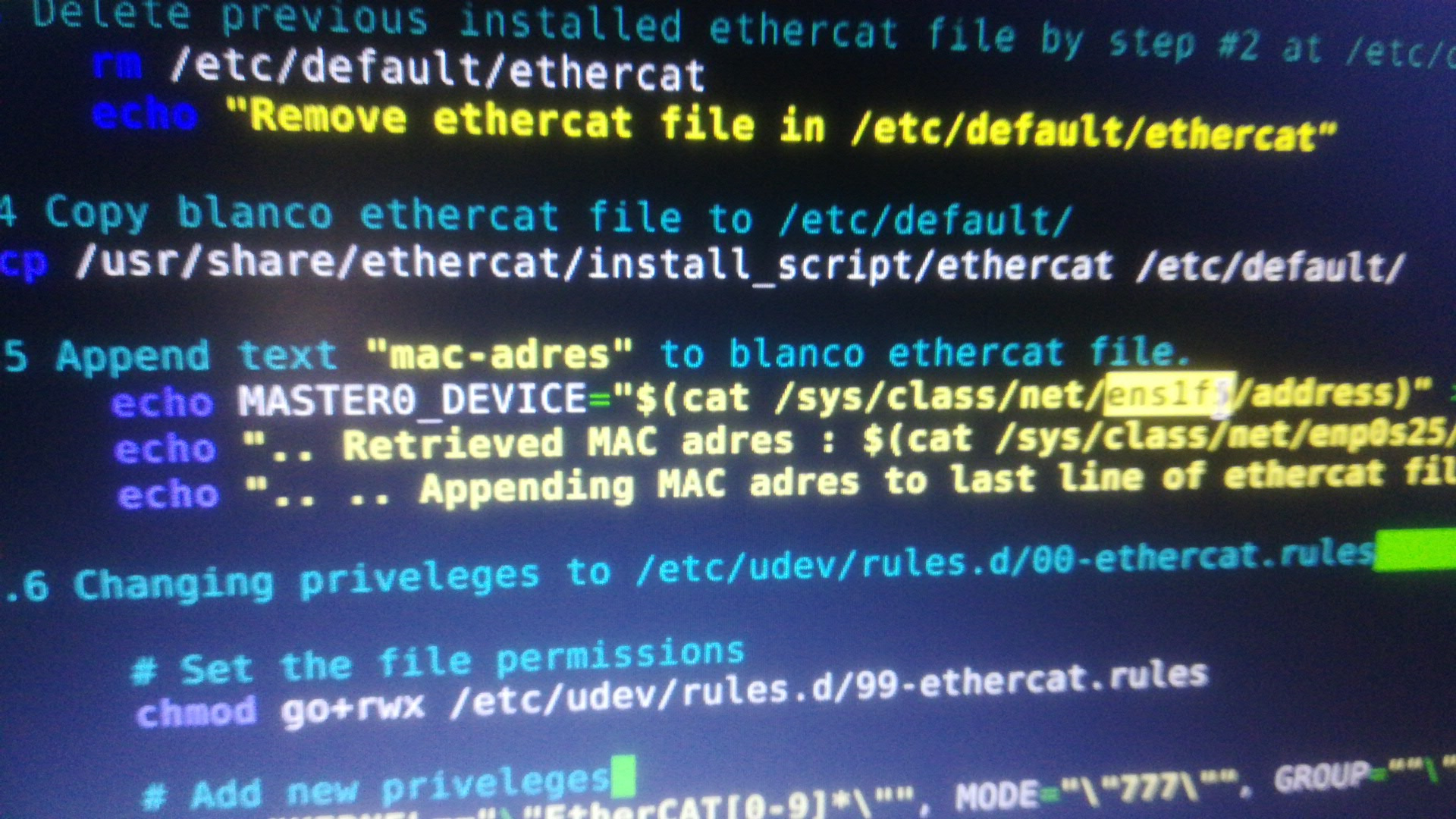

17 Apr 2021 21:07 - 17 Apr 2021 21:17 #206228 by hozte
Hello V-max,
the problem is the name of your ethernet adapter. You have to change in the ethercat_setup_script.sh file the name
of the ethernet adapter to your one.
Run the installer again.
@Grotius
Many thanks for your ISO. Installing of Ethercat is now very easy!
Best regards
Matthias

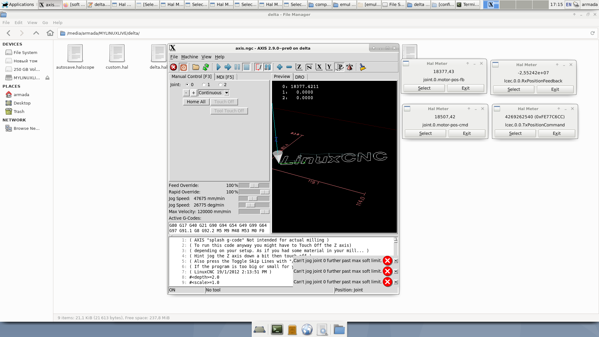

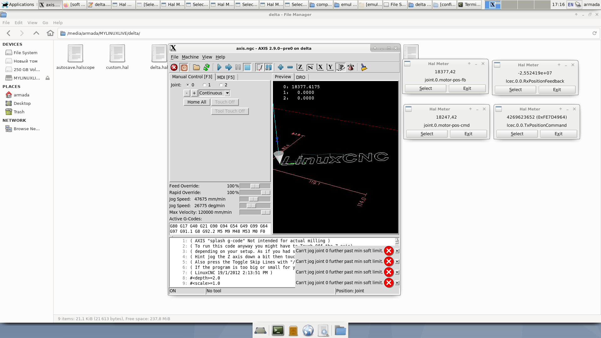

06 May 2021 14:27 - 06 May 2021 15:31 #208119 by TheRoslyak
Hi everone
I start to use ethercat driver hiwin E1 with absolute encoder
I have checked hal for incremental encoder.
If I reset counter in driver I can rotare motor forward up to a certain point then I get error (pic1)
The other way I always get the error (pic2)
Tell me where I have a problem in the Linux settings (* .ini or maybe * .hal) or some settings in the drive itself.
What does this error mean and how to fix it.
UPD I figured it out Anyone can suggest how to debug machines with absolute encoders, physical limit switches are needed?
Last edit: 06 May 2021 15:31 by TheRoslyak.
