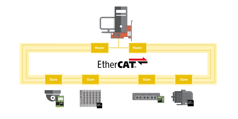

Hello everyone
Now I am facing a demand. I don't know if you know Ethercat cable redundancy.
At present, I have successfully used linuxcnc+Ethercat to control a three-axis laser machine tool. However, according to customer needs, I not only need to achieve ethercat communication, but also need to achieve cable redundancy to ensure that the equipment is still online when one end is disconnected.
like this
www.hilscher.com/blog/ethercat-cable-redundancy/
Have you done anything like this before? Or give me some ideas, thanks

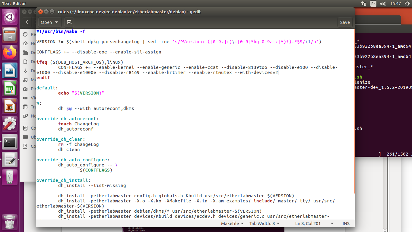

Thank you very much for your explanation. I read the document you provided, but I don't understand how to modify the "the rules file in the debian folder" you said. What parameters should I change? (I'm already here)
I tried adding "--with-devices=2" after CONFIGS, but it didn't make ethercat redundant.
I already know the configuration method of the two parameters "--with-devices" and "MasterX_Backup" by reading the document.
I have configured MasterX_Backup as a backup MAC address, do I need other operations?
Last edit: 05 Nov 2021 08:55 by wang.

I don't know by which method you installed the etherlabmaster.
If you have installed it with ec-debianize. you can edit the rules file
(/ec-debianize/etherlabmaster/debian/rules) on top of the file are the config flags for the Master defined. At this place you can add "--with-devices" and install the master again.
If you already have installed the master with "--with-devices" , everythins is fine.
Then you only have to edit the config file (etc/default/ethercat)
