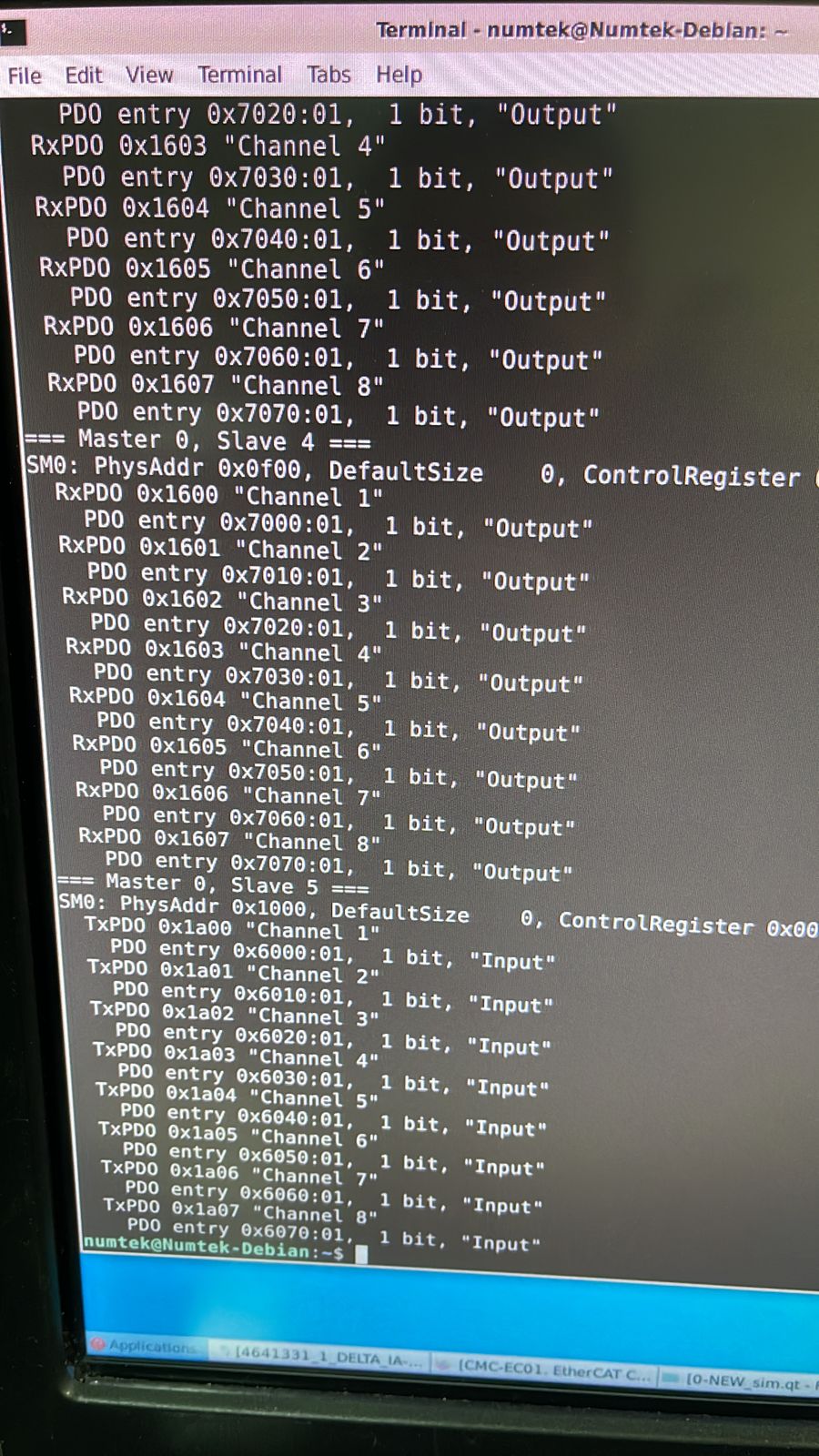

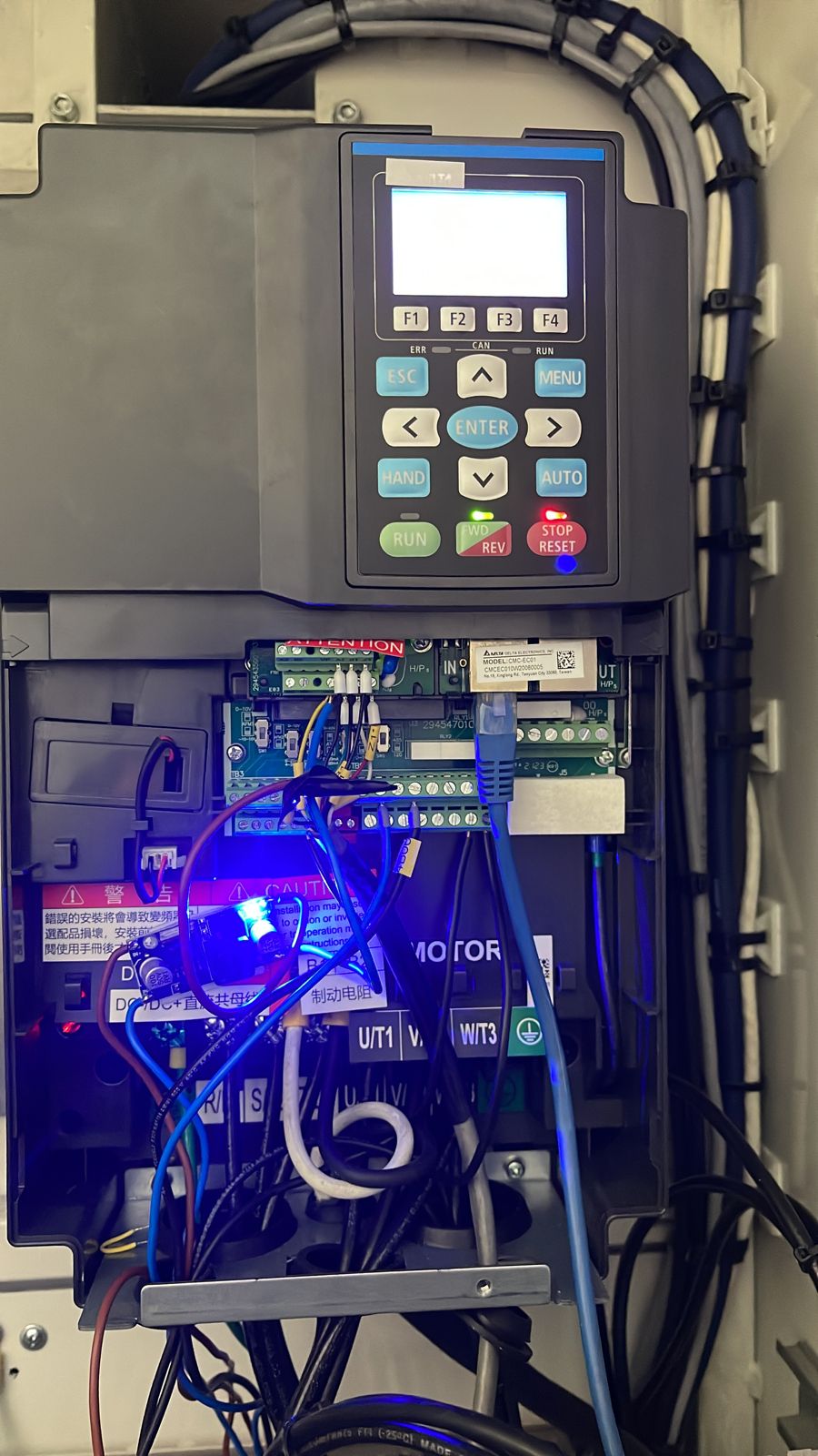

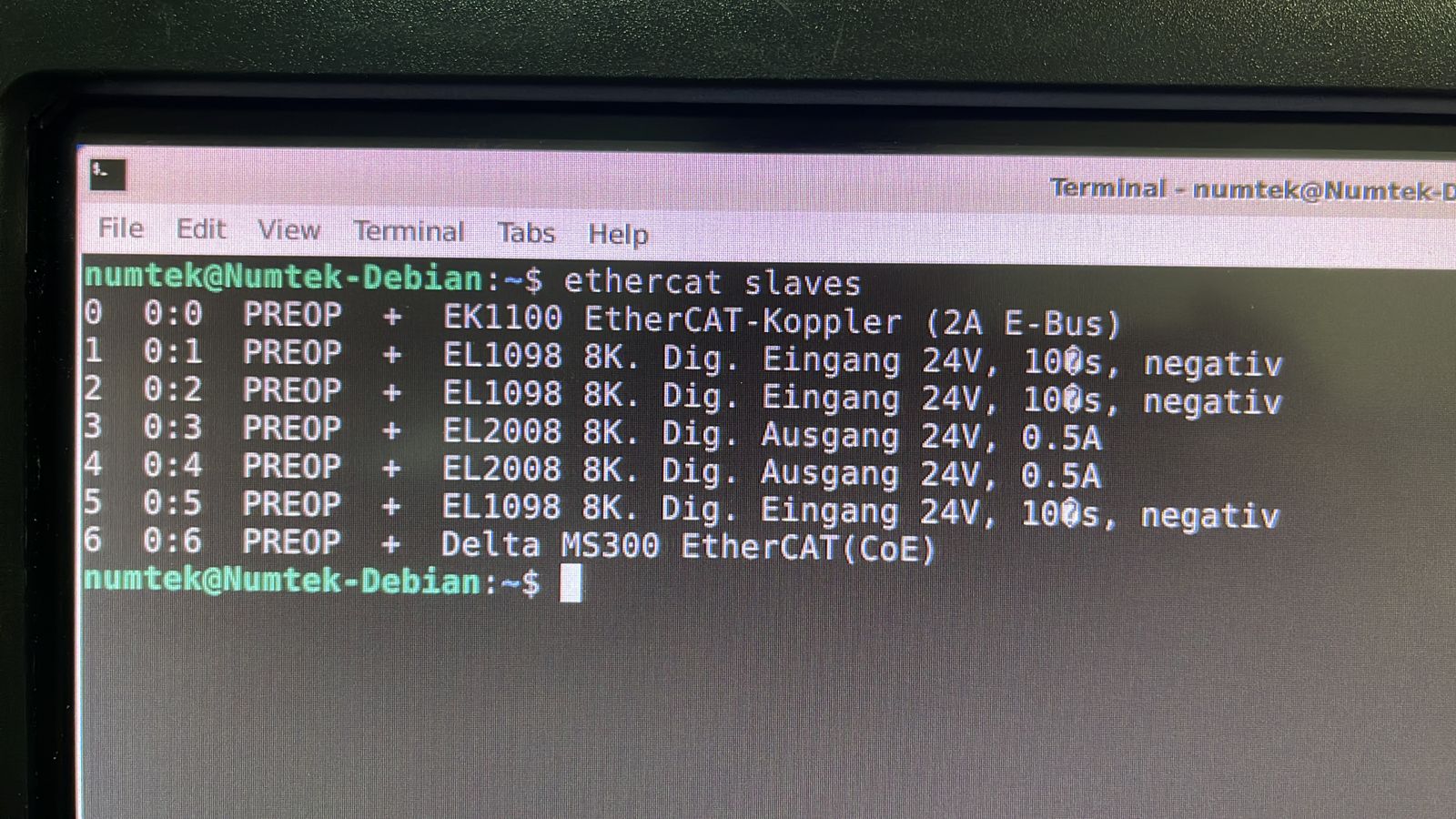

Hello: I am trying to control my VFD delta C2000 plus with ethercat card CMC-EC01. When I run the ethercat slaves I can see the VFD, but when I run the ethercat slaves pdos, the VFD slave does not appear. Any sugestion? thanks in advance

Ethercat Modul CMC-E01 is the same as the modul in the MS300.
You can use the native ms300 driver.
But one Problem is the the manufacture delivers the drive with an faulty/empty SII Eeprom, so you have to burn the eeprom by yourself or load the content of the eeprom in the etherlab master (but this requieres a bit more experience....).

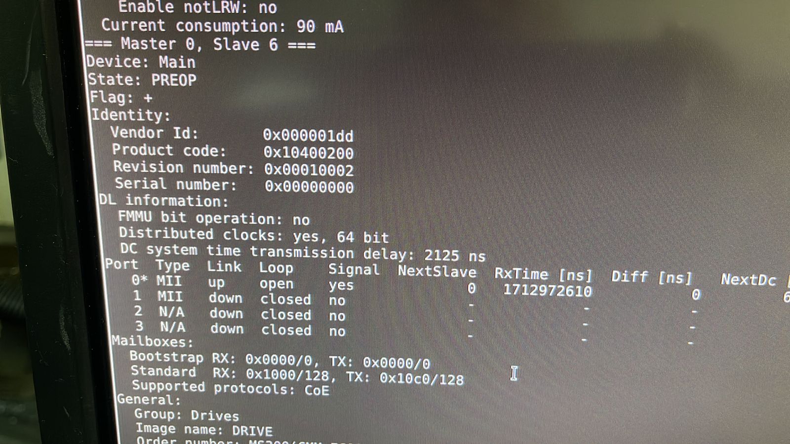

Hello, I have PDOs from the Drive, and I put the in the XML file the configuration for the MS300. I can see the hal pins, but can not write the freq or the control word. I think my drive is a new version (C2000 plus) with the position control option. Maybe I need to write a different sii file in to the eprom. Any sugestion?

does the slave reaches ethercat op state after lcnc start?
As far as i know cmc-ec01 card is only for velocity command, for servo and position control there is the ec02 card.
do you have manufactur xml for c2000 with ec01 card?
