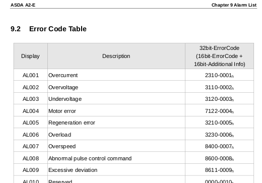

ethercat upload -p 0 -t uint16 0x603F 00 .... read error register but only 16bit register (normally) .... on delta asd-a2-e drive 603F register is 32bit register .... but if try to read with:
obtain these reply on terminal ...
but on a2-e manual at pag.130 is clear thar 603F must be 32 register 16(error code)+16(addictional info) register so I aspect to see something like 9000-0500h ... but can obtain only 0x9000 36864 (hex and dec value of same 16 bit register)
I appreciate any suggest
Code:
ethercat upload -p 0 -t uint32 0x603F 0000
Code:
Data type mismatch. Expected uint32 with 4 byte, but got 2 byte.

In a2-e manual, page 79 it is clearly written that object 603Fh is unsigned 16

Try
to get the drive's idea of register length.
Code:
ethercat sdos

just try ... seems 16bit only not 16 + 16
