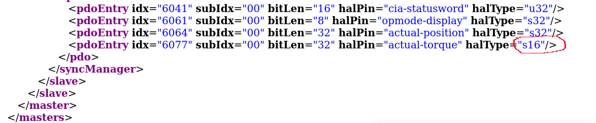

27 Oct 2023 20:12 - 27 Oct 2023 20:42 #283914 by jjdege
HI
I get an error in the .xml file
with the modified file, LCNC sees the pins,
test if the devices are op
Attachment not found
Last edit: 27 Oct 2023 20:42 by jjdege.
27 Oct 2023 21:12 #283921 by eduard
Thanks, I'll correct it, but I'm pretty sure it is not the problem, since I commented complety out this part for testing.
Any other suggestion?
What arduino code shloud I use? Now I testing whith this code from examples: TestEasyCAT.ino
