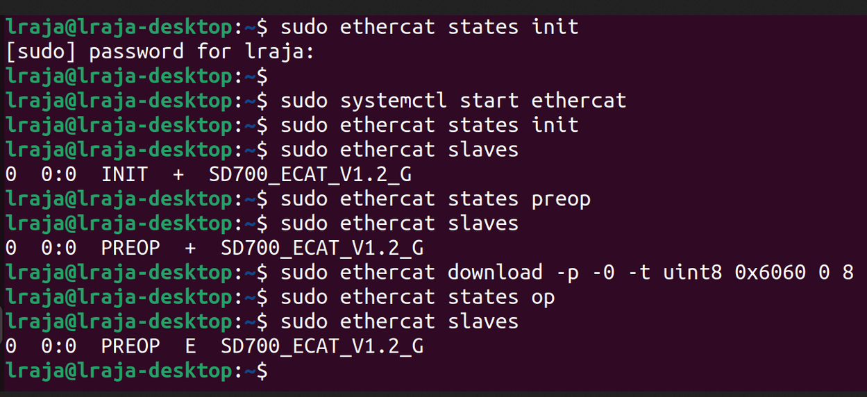

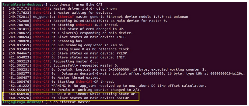

Dear friends,
I am facing the issue in ethercat master implementation.
I have installed igh ethercat master.
I have tried to set the servo in op state using igh commands. But, the Servo cannot set to OP state.
Servo drive: veichi servo sd700.
I have get more information about this using gmesg command. It says "ERROR 0.0 timeout while setting state OP.
Kindly check and give me a suggestion /solution to solve this issue

Dear Sir,
I have shared the terminal output as suggested by you. Kindly check and help me

lraja@lraja-desktop:~/lr_r2k/OpenPLC_v3$ sudo dmesg | grep ethercat
lraja@lraja-desktop:~/lr_r2k/OpenPLC_v3$ sudo dmesg | grep EtherCAT
[ 180.830901] EtherCAT: Master driver 1.6.0-rc1 unknown
[ 180.831419] EtherCAT: 1 master waiting for devices.
[ 180.867495] ec_generic: EtherCAT master generic Ethernet device module 1.6.0-rc1 unknown
[ 180.867568] EtherCAT: Accepting DC:A6:32:28:79:61 as main device for master 0.
[ 180.884585] EtherCAT 0: Starting EtherCAT-IDLE thread.
[ 430.573013] EtherCAT 0: Link state of ecm0 changed to UP.
[ 430.582246] EtherCAT 0: 1 slave(s) responding on main device.
[ 430.582270] EtherCAT 0: Slave states on main device: INIT.
[ 430.582419] EtherCAT 0: Scanning bus.
[ 430.843757] EtherCAT 0: Bus scanning completed in 260 ms.
[ 430.843780] EtherCAT 0: Using slave 0 as DC reference clock.
[ 430.848691] EtherCAT 0: Slave states on main device: PREOP.
[ 531.164458] EtherCAT 0: Master debug level set to 1.
[ 678.455807] EtherCAT: Requesting master 0...
[ 678.455849] EtherCAT DEBUG 0: IDLE -> OPERATION.
[ 678.455859] EtherCAT: Successfully requested master 0.
[ 678.455931] EtherCAT DEBUG 0: ecrt_master_create_domain(master = 0x0000000069c462d7)
[ 678.455946] EtherCAT DEBUG 0: Created domain 0.
[ 678.456348] EtherCAT DEBUG 0: ecrt_master_slave_config(master = 0x0000000069c462d7, alias = 0, position = 0, vendor_id = 0x00850104, product_code = 0x01030507)
[ 678.456360] EtherCAT DEBUG 0: Creating slave configuration for 0:0, 0x00850104/0x01030507.
[ 678.456369] EtherCAT DEBUG 0 0:0: Attached slave 0.
[ 678.456875] EtherCAT DEBUG 0 0:0: ecrt_slave_config_sync_manager(sc = 0x00000000a0031af1, sync_index = 0, dir = 2, watchdog_mode = 0)
[ 678.456895] EtherCAT DEBUG 0 0:0: ecrt_slave_config_pdo_assign_clear(sc = 0x00000000a0031af1, sync_index = 0)
[ 678.456910] EtherCAT DEBUG 0 0:0: ecrt_slave_config_sync_manager(sc = 0x00000000a0031af1, sync_index = 1, dir = 2, watchdog_mode = 0)
[ 678.456968] EtherCAT DEBUG 0 0:0: ecrt_slave_config_pdo_assign_clear(sc = 0x00000000a0031af1, sync_index = 1)
[ 678.456981] EtherCAT DEBUG 0 0:0: ecrt_slave_config_sync_manager(sc = 0x00000000a0031af1, sync_index = 2, dir = 1, watchdog_mode = 0)
[ 678.456995] EtherCAT DEBUG 0 0:0: ecrt_slave_config_pdo_assign_clear(sc = 0x00000000a0031af1, sync_index = 2)
[ 678.457016] EtherCAT DEBUG 0 0:0: ecrt_slave_config_pdo_assign_add(sc = 0x00000000a0031af1, sync_index = 2, pdo_index = 0x1602)
[ 678.457028] EtherCAT DEBUG 0 0:0: Loading default mapping for PDO 0x1602.
[ 678.457034] EtherCAT DEBUG 0 0:0: No default mapping found.
[ 678.457047] EtherCAT DEBUG 0 0:0: ecrt_slave_config_pdo_mapping_clear(sc = 0x00000000a0031af1, pdo_index = 0x1602)
[ 678.457065] EtherCAT DEBUG 0 0:0: ecrt_slave_config_pdo_mapping_add(sc = 0x00000000a0031af1, pdo_index = 0x1602, entry_index = 0x6040, entry_subindex = 0x00, entry_bit_length = 16)
[ 678.457081] EtherCAT DEBUG 0 0:0: ecrt_slave_config_pdo_mapping_add(sc = 0x00000000a0031af1, pdo_index = 0x1602, entry_index = 0x60FF, entry_subindex = 0x00, entry_bit_length = 32)
[ 678.457095] EtherCAT DEBUG 0 0:0: ecrt_slave_config_sync_manager(sc = 0x00000000a0031af1, sync_index = 3, dir = 2, watchdog_mode = 0)
[ 678.457107] EtherCAT DEBUG 0 0:0: ecrt_slave_config_pdo_assign_clear(sc = 0x00000000a0031af1, sync_index = 3)
[ 678.457167] EtherCAT DEBUG 0 0:0: ecrt_slave_config_pdo_assign_add(sc = 0x00000000a0031af1, sync_index = 3, pdo_index = 0x1A02)
[ 678.457178] EtherCAT DEBUG 0 0:0: Loading default mapping for PDO 0x1A02.
[ 678.457185] EtherCAT DEBUG 0 0:0: No default mapping found.
[ 678.457237] EtherCAT DEBUG 0 0:0: ecrt_slave_config_pdo_mapping_clear(sc = 0x00000000a0031af1, pdo_index = 0x1A02)
[ 678.457262] EtherCAT DEBUG 0 0:0: ecrt_slave_config_pdo_mapping_add(sc = 0x00000000a0031af1, pdo_index = 0x1A02, entry_index = 0x6041, entry_subindex = 0x00, entry_bit_length = 16)
[ 678.457279] EtherCAT DEBUG 0 0:0: ecrt_slave_config_pdo_mapping_add(sc = 0x00000000a0031af1, pdo_index = 0x1A02, entry_index = 0x6064, entry_subindex = 0x00, entry_bit_length = 32)
[ 678.457294] EtherCAT DEBUG 0 0:0: ecrt_slave_config_pdo_mapping_add(sc = 0x00000000a0031af1, pdo_index = 0x1A02, entry_index = 0x606C, entry_subindex = 0x00, entry_bit_length = 32)
[ 678.457467] EtherCAT DEBUG 0: ecrt_master_slave_config(master = 0x0000000069c462d7, alias = 0, position = 0, vendor_id = 0x00850104, product_code = 0x01030507)
[ 678.457495] EtherCAT DEBUG 0 0:0: ecrt_slave_config_reg_pdo_entry(sc = 0x00000000a0031af1, index = 0x6040, subindex = 0x00, domain = 0x00000000b5134dfa, bit_position = 0x00000000ef25e7f7)
[ 678.457509] EtherCAT DEBUG 0: Domain 0: Added 6 bytes at 0.
[ 678.457522] EtherCAT DEBUG 0: ecrt_master_slave_config(master = 0x0000000069c462d7, alias = 0, position = 0, vendor_id = 0x00850104, product_code = 0x01030507)
[ 678.457538] EtherCAT DEBUG 0 0:0: ecrt_slave_config_reg_pdo_entry(sc = 0x00000000a0031af1, index = 0x60FF, subindex = 0x00, domain = 0x00000000b5134dfa, bit_position = 0x00000000ef25e7f7)
[ 678.457552] EtherCAT DEBUG 0: ecrt_master_slave_config(master = 0x0000000069c462d7, alias = 0, position = 0, vendor_id = 0x00850104, product_code = 0x01030507)
[ 678.457568] EtherCAT DEBUG 0 0:0: ecrt_slave_config_reg_pdo_entry(sc = 0x00000000a0031af1, index = 0x6041, subindex = 0x00, domain = 0x00000000b5134dfa, bit_position = 0x00000000ef25e7f7)
[ 678.457577] EtherCAT DEBUG 0: Domain 0: Added 10 bytes at 6.
[ 678.457589] EtherCAT DEBUG 0: ecrt_master_slave_config(master = 0x0000000069c462d7, alias = 0, position = 0, vendor_id = 0x00850104, product_code = 0x01030507)
[ 678.457605] EtherCAT DEBUG 0 0:0: ecrt_slave_config_reg_pdo_entry(sc = 0x00000000a0031af1, index = 0x6064, subindex = 0x00, domain = 0x00000000b5134dfa, bit_position = 0x00000000ef25e7f7)
[ 678.457619] EtherCAT DEBUG 0: ecrt_master_slave_config(master = 0x0000000069c462d7, alias = 0, position = 0, vendor_id = 0x00850104, product_code = 0x01030507)
[ 678.457635] EtherCAT DEBUG 0 0:0: ecrt_slave_config_reg_pdo_entry(sc = 0x00000000a0031af1, index = 0x606C, subindex = 0x00, domain = 0x00000000b5134dfa, bit_position = 0x00000000ef25e7f7)
[ 678.458339] EtherCAT DEBUG 0: ecrt_domain_external_memory(domain = 0x00000000b5134dfa, mem = 0x0000000008bda562)
[ 678.458358] EtherCAT DEBUG 0: ecrt_master_callbacks(master = 0x0000000069c462d7, send_cb = 0x00000000547b267b, receive_cb = 0x000000002a851c7b, cb_data = 0x0000000069c462d7)
[ 678.458366] EtherCAT DEBUG 0: ecrt_master_activate(master = 0x0000000069c462d7)
[ 678.458379] EtherCAT DEBUG 0: Adding datagram pair with expected WC 3.
[ 678.458386] EtherCAT 0: Domain0: Logical address 0x00000000, 16 byte, expected working counter 3.
[ 678.458395] EtherCAT 0: Datagram domain0-0-main: Logical offset 0x00000000, 16 byte, type LRW at 000000006890a4e7.
[ 678.458404] EtherCAT DEBUG 0: Stopping master thread.
[ 678.458583] EtherCAT DEBUG 0: Master IDLE thread exiting...
[ 678.458806] EtherCAT 0: Master thread exited.
[ 678.458823] EtherCAT DEBUG 0: FSM datagram is 00000000feeb28d1.
[ 678.458830] EtherCAT 0: Starting EtherCAT-OP thread.
[ 678.460757] EtherCAT DEBUG 0: mmap()
[ 678.460847] EtherCAT DEBUG 0: Vma fault, offset = 0, page = 000000005554fe22
[ 678.469036] EtherCAT DEBUG 0: Operation thread running with fsm interval = 4000 us, max data size=45000
[ 679.205026] EtherCAT DEBUG 0: Configuration changed.
[ 679.205057] EtherCAT DEBUG 0-0: Checking system time offset.
[ 679.305020] EtherCAT WARNING 0: No app_time received up to now, abort DC time offset calculation.
[ 679.305050] EtherCAT DEBUG 0: Requesting OP...
[ 679.501127] EtherCAT DEBUG 0-0: Changing state from PREOP to OP.
[ 679.501197] EtherCAT DEBUG 0-0: Configuring...
[ 679.649612] EtherCAT DEBUG 0-0: Now in INIT.
[ 679.649637] EtherCAT DEBUG 0-0: Clearing FMMU configurations...
[ 679.649644] EtherCAT DEBUG 0-0: Clearing mailbox check flag...
[ 679.749636] EtherCAT DEBUG 0-0: Clearing sync manager configurations...
[ 679.849590] EtherCAT DEBUG 0-0: Clearing DC assignment...
[ 679.899690] EtherCAT DEBUG 0-0: Configuring mailbox sync managers...
[ 679.899735] EtherCAT DEBUG 0-0: SM0: Addr 0x1000, Size 128, Ctrl 0x26, En 1
[ 679.899748] EtherCAT DEBUG 0-0: SM1: Addr 0x1080, Size 128, Ctrl 0x22, En 1
[ 679.999602] EtherCAT DEBUG 0-0: Assigning SII access to PDI.
[ 680.149609] EtherCAT DEBUG 0-0: Now in PREOP.
[ 680.149637] EtherCAT DEBUG 0-0: Assigning SII access back to EtherCAT.
[ 680.199618] EtherCAT DEBUG 0-0: Reading mapping of PDO 0x1602.
[ 680.199642] EtherCAT DEBUG 0-0: Uploading SDO 0x1602:00.
[ 680.199648] EtherCAT DEBUG 0-0: Upload request:
[ 680.199653] EtherCAT DEBUG: 00 20 40 02 16 00 00 00 00 00
[ 680.399623] EtherCAT DEBUG 0-0: Upload response:
[ 680.399645] EtherCAT DEBUG: 00 30 4F 02 16 00 02 00 00 00
[ 680.399688] EtherCAT DEBUG 0-0: Uploaded data:
[ 680.399710] EtherCAT DEBUG: 02
[ 680.399721] EtherCAT DEBUG 0-0: 2 PDO entries mapped.
[ 680.399726] EtherCAT DEBUG 0-0: Uploading SDO 0x1602:01.
[ 680.399733] EtherCAT DEBUG 0-0: Upload request:
[ 680.399737] EtherCAT DEBUG: 00 20 40 02 16 01 00 00 00 00
[ 680.599635] EtherCAT DEBUG 0-0: Upload response:
[ 680.599656] EtherCAT DEBUG: 00 30 43 02 16 01 10 00 40 60
[ 680.599699] EtherCAT DEBUG 0-0: Uploaded data:
[ 680.599723] EtherCAT DEBUG: 10 00 40 60
