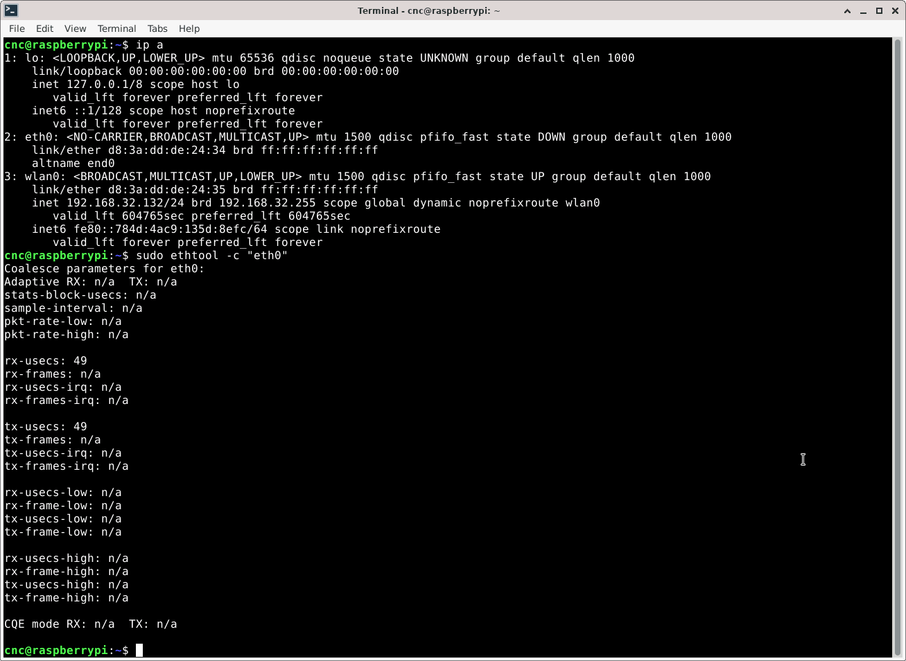

i would like to share some research findings.
I have acquired RPi 5 since I wanted to check linuxcnc performance on this new single board PC.
The performance leap compared to RPi 4 is staggering. I tried to hook up Delta B3 EtherCAT drives, which was pretty straight-forward.
Browsing youtube for linuxcnc ethercat videos I come across this one:
So I thought that I should try this on raspberry pi 5. 125000ns was too much, but 250000ns was mostly OK.
But with this cycle times, servo drives started to have troubles with getting to OP mode.
Guys at etherlab found out, that ethercat master driver generic (DEVICE_MODULES="generic") is only good for 1000000ns threads/cycle time.
To reach better cycle times, I was told to try "genet" driver wich is working fine on Raspberry Pi 4. (RPi5 and RPi4 has the same ethernet chip BCM54213PE)
But the final verdict is, that RPi5 uses macb driver (Cadence GEM) and not genet.
Thats why we are stuck with generic device module.
Link to etherlab issue thread:
gitlab.com/etherlab.org/ethercat/-/issues/104

Install ethtool and run this in Terminal:
sudo apt install ethtool
ip a
sudo ethtool -c "NIC CARD NAME" and post your output.
In essence you are trying reduce the settings (buffer) as much as you can.
You can change the settings with:
sudo ethtool -C "NIC CARD NAME" "NEW SETTING".
Some drivers allow to reduce to 0, some others require a higher minimum number.

12 Feb 2024 18:22 #293157
by zmrdko
Replied by zmrdko on topic Raspberry Pi 5 EtherCAT master servo thread period
Hi!
thanks for reply.
see output in attachment
thanks for reply.

Now try to reducing those two settings:
sudo ethtool -C eth0 rx-usecs 0
sudo ethtool -C eth0 tx-usecs 0
If that errors out, try 1 or the lowest number the driver accepts.

14 Feb 2024 00:30 - 14 Feb 2024 00:31 #293283
by zmrdko
I set bot values to 0.
Do you have any suggestion, how to verify, if its working?
I tried 250 000 ns thread and it did not make any difference (random first drive failing to get to OP)
Thanks for suggestion.Now try to reducing those two settings:
