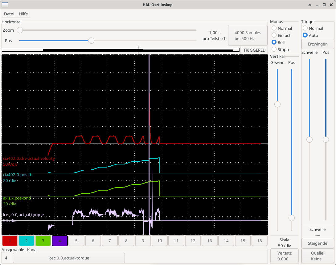

My CNC system with ethercat and Leadshine EL8 controller works as an absolute value system so far. When running the program, the system interrupts sporadically with the error message:
Motor 0 position error
Position: relatively current
I can also sometimes hear short interruptions during motor braking. However, these are not always directly related to the error message.
Can the warnings from the dsmg protocol be ignored or is a specific program or configuration change necessary?
How could I solve the problem?

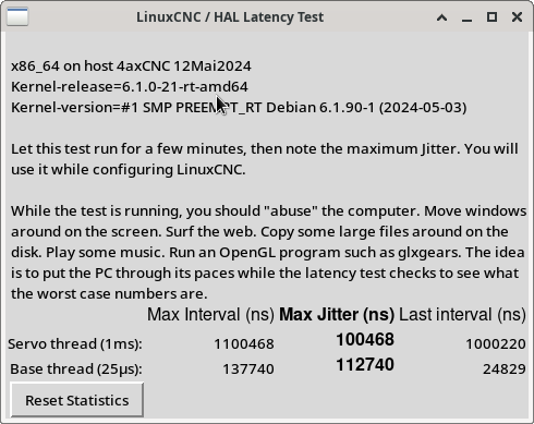

In the terminal I got this information:
Unexpected realtime delay on task 0 with period 1000000This Message will only display once per session.Run the Latency Test and resolve before continuing.task: main loop took 0.018594 secondsMotor 2 Positionssfehleremc/task/taskintf.cc 976: Error on joint 2, command number 377task: main loop took 0.037092 secondstask: main loop took 0.019966 secondstask: main loop took 0.024853 seconds
How could I solve the problems?

11 May 2024 09:15 #300377
Replied by rodw on topic Leadshine EL8 interruptions
Please post your config xml file.
There seems to be a lot of unmatched datagrams
also your latency looks pretty awful. Please work on cleaning that up in the BIOS settings.

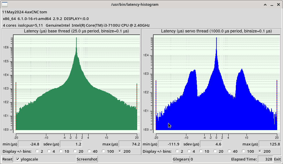

Regarding latency, have a read through this:
forum.linuxcnc.org/38-general-linuxcnc-q...ead-and-irq-affinity

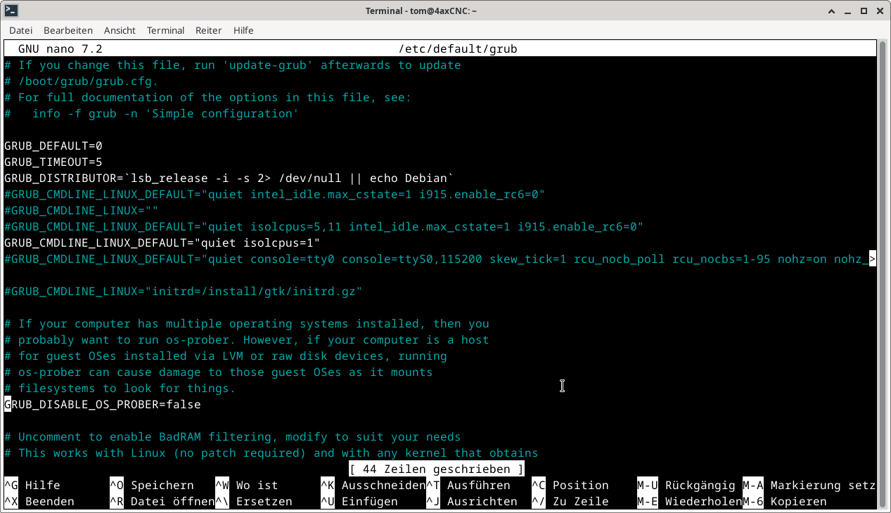

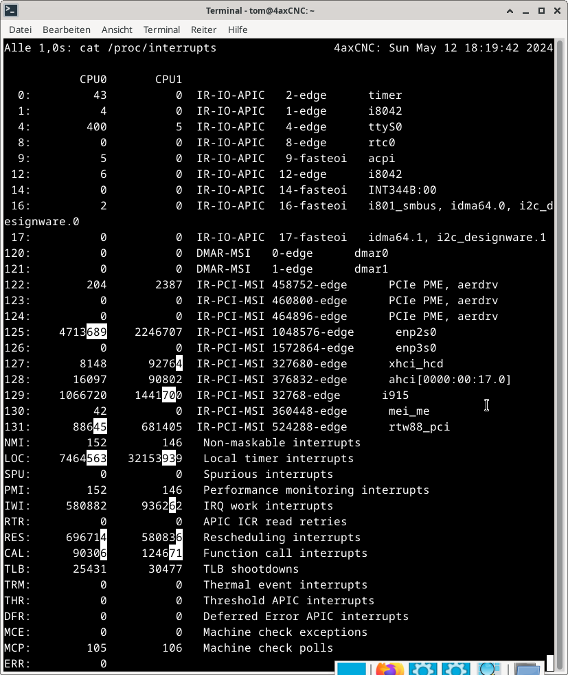

I have now tried to improve the bios according to the Linuxcnc documentation as suggested by rodw.
I also followed the instructions in the link from tommylight and tried to reduce the latency in this way.
Since the result is not really good yet, it would be great if I could get hints on a possible solution based on the files in the attachment

12 May 2024 21:05 #300472
by blazini36
Replied by blazini36 on topic Leadshine EL8 interruptions
Slow the servo thread to 2ms, until you get the latency sorted out. I don't think you'll get away with a 1ms servo thread.
Try updating the PC/motherboard BIOS. Sometimes they ship with crap that generally works then sort it out halfway through the product lifecycle.
