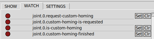

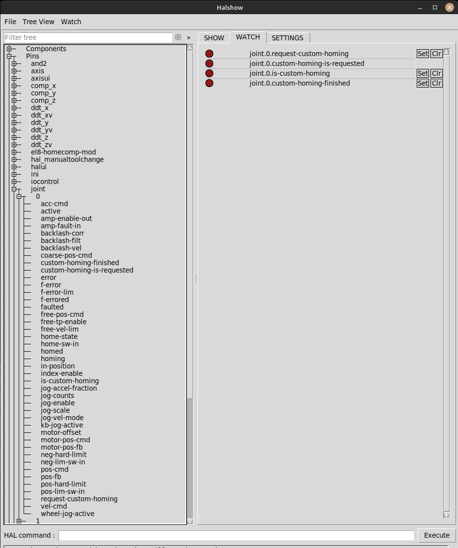

17 Jun 2024 15:11 - 17 Jun 2024 16:38 #303183
Replied by Aciera on topic Help Needed: Cracking the Code on LinuxCNC Servo Homing Setup!
To test my modified component you need to 'halcompile --install' the 'el8_homemod_mod.comp (sudo is needed for a package installation):
in the [EMCMOD] sectio of your ini file:
then start your config and check if the homing pins have been created using the 'show hal configuration' tool (image shows pins for joint 0 but same goes for all other joint numbers):
Question 1: Do you see the homing pins for each joint in the 'show hal configuration' tool as shown in the image above? If the answer is no then you are not using the correct component/version.
If you do have the pins then close linuxcnc and open a terminal window. In the terminal type (note lowercase letter 'L' after the hyphen-minus to start your last config):
At this stage if you have not connected the pin 'joint.0.request-custom-homing' in hal you can set/clear it in the 'WATCH' tab as shown above. If cleared the DEFAULT homing procedure should be executed (ie the HOME_ABSOLUTE_ENCODER = 2 you have set in the [JOINT_0] section of your ini file). If you set the pin then the CUSTOM homing procedure should be executed (ie the one the uses the hal connections to the 'cia402.0.' component).
Note the printed messages in the terminal window when CUSTOM homing is selected, similar to this:
HOMEMOD=el8_homecomp_modthen start your config and check if the homing pins have been created using the 'show hal configuration' tool (image shows pins for joint 0 but same goes for all other joint numbers):
linuxcnc -lAt this stage if you have not connected the pin 'joint.0.request-custom-homing' in hal you can set/clear it in the 'WATCH' tab as shown above. If cleared the DEFAULT homing procedure should be executed (ie the HOME_ABSOLUTE_ENCODER = 2 you have set in the [JOINT_0] section of your ini file). If you set the pin then the CUSTOM homing procedure should be executed (ie the one the uses the hal connections to the 'cia402.0.' component).
Waiting for joint 0 to confirm custom homing ...Attachments:

17 Jun 2024 16:06 - 17 Jun 2024 16:47 #303186
Oops, after all of that I realize that I used underscore instead of hyphen in the homing pin names.
My appologies I'll have to fix that, or your hal entries wont work.
[edit]
Ok, I fixed the halpin names in the component posted above and also the screen shots. So make sure to download the fixed component and install it again.
[edit]
Last edit: 17 Jun 2024 16:47 by Aciera.
