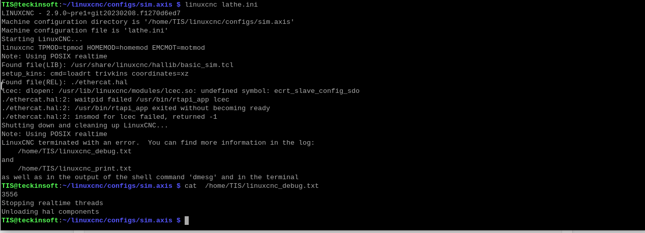

by seyad
Linuxcnc's Ethercat in Raspberry pi-5 was created by seyad
I am using raspberry pi-5 for my project to build linuxcnc . I actually build linuxcnc from source file following this site (linuxcnc.org/docs/master/html/code/build...nc.html#sub:realtime). and i also build ethercat using this two (forum.linuxcnc.org/ethercat/49771-etherc...ce-full-instructions // forum.linuxcnc.org/ethercat/42048-notes-...at-on-raspberry-pi-4). but at stage of testing i am facing issues in ethercat . i attached that error below .
Attachment not found

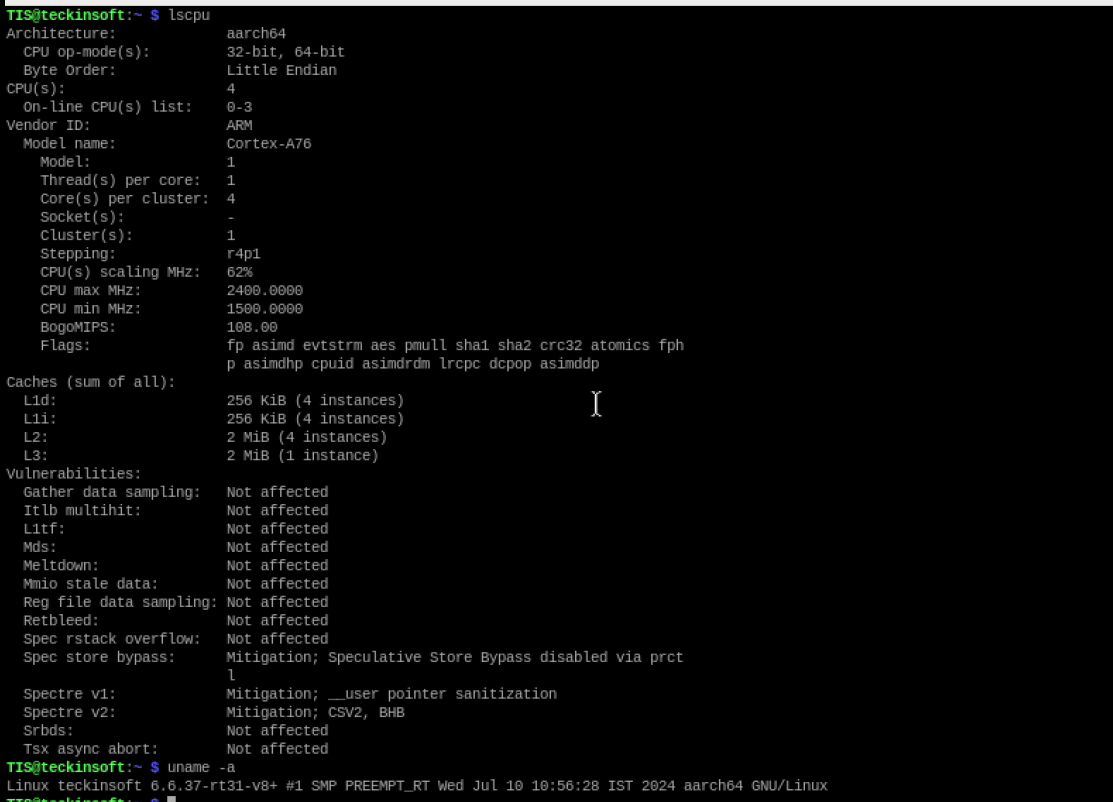

I've successfully built LinuxCNC by following the instructions in the official documentation. Additionally, I've compiled EtherCAT using the instructions provided on this site.(forum.linuxcnc.org/ethercat/49771-etherc...ce-full-instructions) However, when I reached the final testing step for EtherCAT, I encountered an error while executing a specific .ini file. Here is a screenshot of my sytem configration :
Could you help me troubleshoot this issue?
Last edit: 12 Jul 2024 06:20 by seyad.
- Posts: 1200
- Thank you received: 426
12 Jul 2024 10:52 #304976
Replied by Cant do this anymore bye all on topic Linuxcnc's Ethercat in Raspberry pi-5
All lscpu gives is info on the cpu, nothing else is reported, and it's really not the info needed.
You haven't given any indication of your error your error, I skipped mind reading & ESP classes at school
Please upload the error Linuxcnc is giving and all the files, ini, hal & xml & any extra files your ini file loads. Screenshots aren't really much help, ever tried using grep to look for a string in a screen shot ? Just a little joke there mate.

15 Jul 2024 04:53 #305190
by seyad
Replied by seyad on topic Linuxcnc's Ethercat in Raspberry pi-5
For Ethercat installation i followed this video ().After that I strated test ethercat following his steps while executing lathe.ini file error came. Bellow attached error report.

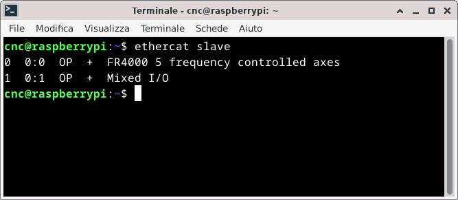

17 Jul 2024 09:52 #305469
by jjdege
Replied by jjdege on topic Linuxcnc's Ethercat in Raspberry pi-5
HI
Just wanted to confirm that everything is working
I downloaded and installed the LinuxCNC file for Raspberry Pi 5
followed the stiky written by Rod for the EtherCAT drivers and everything works
my CNC moves like with the PC
the only thing you can't manage is the display
but it's all great
Thank you!
