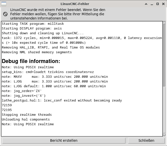

Hallo zusammen, ich bin grade dabi meine erste Maschine mit ethercat zubauen. Nach ein paar kleinen Fehlern hab ich das meiste beseitigen könne nun bekomme ich beim satrten der Sim axis diesen fehler: "lcec config exited without becoming ready".
Kann mir einer weiterhelfen ?
Gruß Tom
Gruß Tom

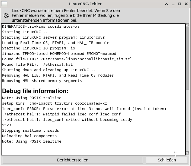

1 year 9 months ago #320491
by Hakan
Replied by Hakan on topic lcec config exited without becoming ready
That's not right
You should add a new first line so it starts with
(I hope you understand my answer, my german is terrible)
Code:
<master idx="0" appTimePeriod="1000000" refClockSyncCycles="1">
<slave idx="0" name=”D1” type="EK1100"/>
<slave idx="1" name=”D2” type="EL2004"/>
<slave idx="2" name=”D3” type="EL2004"/>
<slave idx="3" name=”D4” type="EL1008"/>
</master>
</masters>
Code:
<masters>
- Millimetergott
- Topic Author
- Posts: 17
1 year 9 months ago #320504
by Millimetergott
Replied by Millimetergott on topic lcec config exited without becoming ready
thx for your fast reply. I have chnged my configs like your exmaple, now i get a new error.
- Hakan
- Posts: 1317
- Thank you received: 454

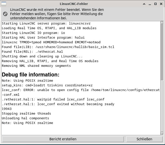

1 year 9 months ago #320506
by Hakan
Is the config file really located there?
Normally there is a sub-directory to configs, like
Code:
loadusr -W lcec_conf /home/tom/linuxcnc/configs/ethercat-conf.xml
Code:
loadusr -W lcec_conf /home/tom/linuxcnc/configs/My_Machine/ethercat-conf.xml
- Millimetergott
- Topic Author
- Posts: 17
1 year 8 months ago #320517
by Millimetergott
Changed this part also but i get the same error again

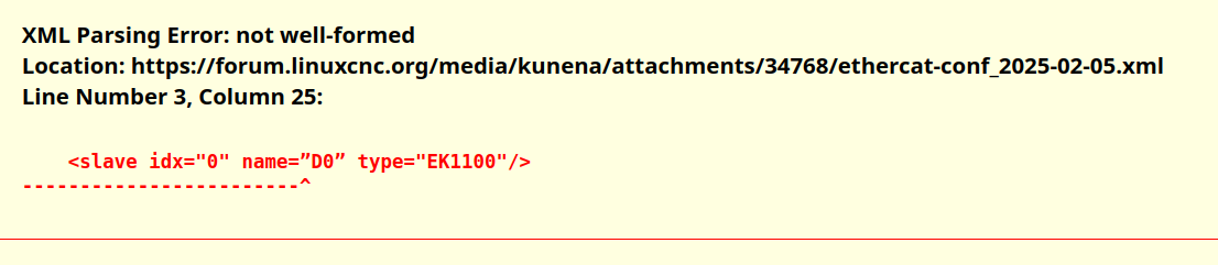

- Hakan
- Posts: 1317
1 year 8 months ago #320530
by Hakan
Do you use some special double-quotes around D1, D2,D3 and D4?
Replace them with the normal ones, that are around 0,1,2,3 in slaves
names="D1"
names="D1"
- Millimetergott
- Topic Author
- Posts: 17
1 year 8 months ago #320762
by Millimetergott
I made a new xml with only the beckhoff EK1100. Now i get a new error
