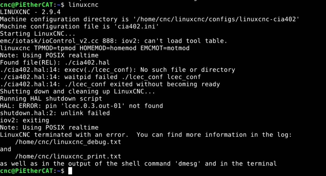

Thank you for all the help so far. I've been running into an issue and feared it may have been caused by my fumbling earlier on and some weird state I may have put the installation into. To resolve this, I started a fresh install from current ISO and so far it has been much smoother given that I have a little more understanding. However, I have still ended up getting stuck at the same place, lol. I have included a screenshot and some config files to assist troubleshooting.
Thanks,
Steve Cap
Thanks,
Steve Cap

There are probably several things. But let's start with the line
"loadusr -W ./lcec_conf ethercat-conf.xml'"
Remove the ./ and it will find the lcec_conf module at /usr/lib/linuxcnc/modules/lcec_conf.so
The filename ethercat-conf.xml on that line must match the file name where you have the config. You attach ethercat-conf_2025-02-26.xml. If that's the one you use use the line "loadusr -W lcec_conf ethercat-conf_2025_02_26.xml".
You will get error because slave 0 and 2 do not have hal pins with the mentioned names. You had them as basic cia402 in the earlier xml file. Either go back to that or change the pin name in ethercat-conf.xml the "halPin" value there.
There is no slave 3 in ethercat-conf.xml so you will get errors when trying to use lcec.0.3.out-03 in the hal file.

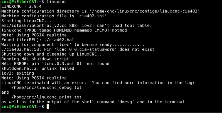

Thanks for the reply again Hakan,
I have been trying numerous files from different cia402 examples, and im having a hard time understanding what is what. for example, my `lcec_configgen` output seems a bit disjointed. for example it seems to show some drives as "generic" and some as "basic_cia402", but they are indeed all the same make and model of drive. How does `lcec_configgen` generate this information? Is the a basic .hal, .xml & .ini available that has only the bare minimum to establish a connection? I have made the suggested changes and now have an error at "lcec.0.0.cia-statusword".
Thanks again for your patience
Steve Cap
Steve Cap
