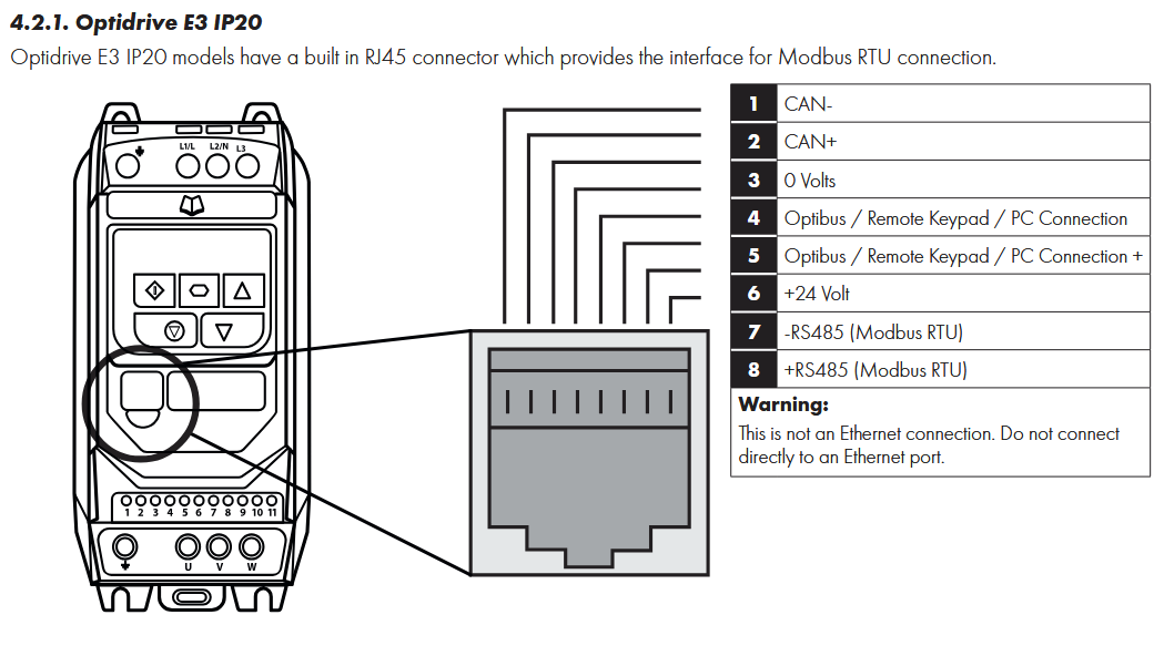

Hi, I am just on the way to start my ethercat adventure.
I received my ethercat servos and some beckhoff ethercat interfaces as well.
Now i recognize that I still need something to control my Optidrive E3 VFD over modbus.
Can I use the El6001 Serial Interface or wich Interface do I need?
I would really appreciate any help or hint
best Kai

Many of us use a USB to RS485 converter plus the mb2hal or vfdmod hal module.

From what I read the EL6021 could perhaps work. Ethercat master will create a virtual serial port over which modbus is communicating.
IgH Ethercat master supposedly supports virtual serial ports when compiled with the right option. But I have no idea of how to set this up in linuxcnc context. I mean it will be a virtual serial port so the standard mb2hal etc are used, but to set up the virtual serial port?.

No the EL6021, modbus is usually RS-485 signalling. Not so different from RS-232 but differential signals.
Edit. The USB to RS-485 is a much better option in this case to avoid the vertical learning curve.

Why not use an Ethercat VFD like the Omron MX2 which is supported in the hal driver. I believe internally its a cia402 device since it's essentially a speed control for a motor just like a servo!
