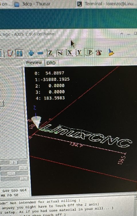

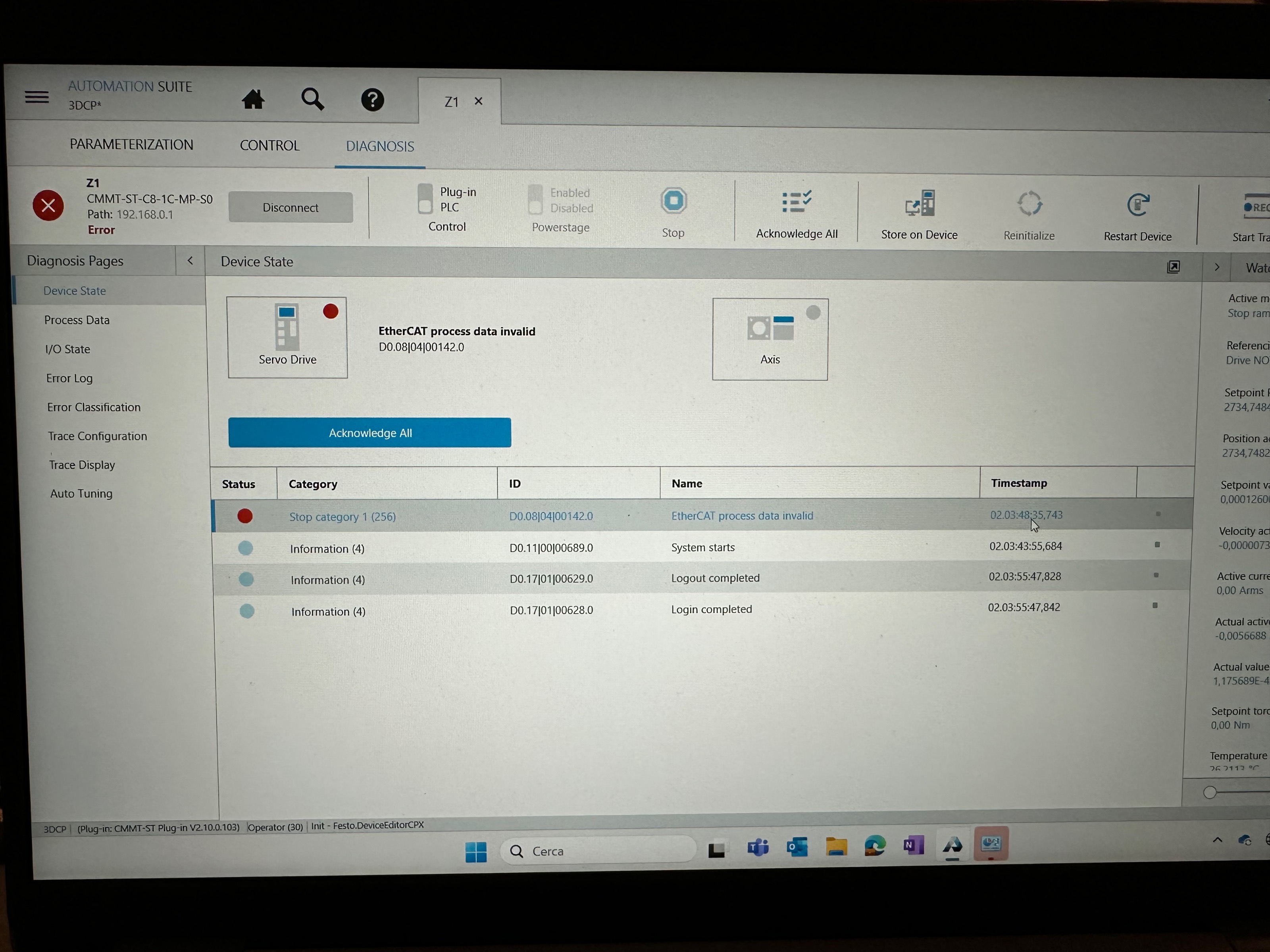

Good morning, I'm trying to build an XYYZZ gantry with two motors on the Y and Z axes. To do this, I've used 5 CMMT-ST drives with absolute encoder servomotors. I have some doubts about the homing procedure. At the moment I can see the drives, but I haven't managed to move them yet. Before causing any damage, I wanted to get your opinion on the configuration files, since this is my first time using LinuxCNC.
ethercat.ini
ethercat.hal
ethercat-conf.xml
I hope this can eventually help other people who want to use these drives.
Many thanks to all for your help.

22 Oct 2025 15:23 #336885
by jc2ktr
Replied by jc2ktr on topic Festo CMMT-ST
Sorry for the late Answer,
yes i had this Error in Festo Automation Suite too first. I don´t really know what i´ve done that it works now.
i put my working config in the Attachments.

24 Oct 2025 03:40 #337019
by endian
Replied by endian on topic Festo CMMT-ST
hi there,
I think you have to check if drivers is running at FHPP or Cia402 protocol shape .. It is configurable and it should be hidden pain...
then you have to setup the SDOs and then PDOs for Cia402
If you are familiar with twincat 3 I can recommend it for you to jog motor from scratch... if it will jog over them just swap yout master to lcec
regards
regards

26 Oct 2025 09:28 - 26 Oct 2025 09:39 #337183
by lorenzing
Replied by lorenzing on topic Festo CMMT-ST
Thank you all very much for the support. The drives use the CiA402 protocol, with the jc2ktr setup I was able to see the drives and I can perform jogging, but I don't understand why I see Z1 on joint 0, which should be X. And when I try to jog joint 1, joint 0 always moves. I definitely made a lot of confusion in the HAL file.
Last edit: 26 Oct 2025 09:39 by lorenzing.

- jc2ktr
- Posts: 87
- Thank you received: 17
27 Oct 2025 18:34 #337304
by jc2ktr
I´ve had at work that if you swap in and out of the Ethercat ports you get weird behavior on the EC-Bus.
Maybe your Hardware (ethercat ports, or motorcables) are wired wrong, your halfile looks okay to me?Thank you all very much for the support. The drives use the CiA402 protocol, with the jc2ktr setup I was able to see the drives and I can perform jogging, but I don't understand why I see Z1 on joint 0, which should be X. And when I try to jog joint 1, joint 0 always moves. I definitely made a lot of confusion in the HAL file.
