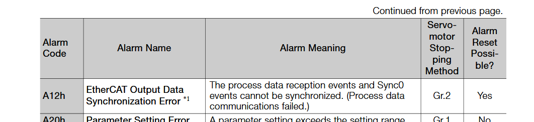

I'm trying to use Yaskawa sigma servo(EtherCAT) for LinuxCNC.
But my trial does not work.
I get Alarm A12 (EtherCAT Output Syncronization Error)
Does anyone know good example master settings ?

Yes, 67108864 is Encoder count per round.
The problem is "Alarm A12 (EtherCAT Output Syncronization Error) "
A support person said,
"As long as A12 occurs, servo amp can't anser properly."

- Hakan
- Posts: 1119
- Thank you received: 393
20 Dec 2025 09:37 #340335
by Hakan
Replied by Hakan on topic EtherCAT master xml file for Yaskawa Sigma Servo motor?
I was able to find the manual and some info´about the alarm. Even if there were very few clues in the post
Then you can tryor if you have an old lcec version and syncToRefClock isn't recognized: refClockSyncCycles="-1000"
Check the lcec.0.pll-reset-count variable that it stays on single digit. Read at least one full page here github.com/linuxcnc-ethercat/linuxcnc-et...istributed-clocks.md
Then you can try
<master idx="0" appTimePeriod="1000000" refClockSyncCycles="1000" syncToRefClock="true">Check the lcec.0.pll-reset-count variable that it stays on single digit. Read at least one full page here github.com/linuxcnc-ethercat/linuxcnc-et...istributed-clocks.md

sudo make modules_install install
sudo depmod
sudo echo KERNEL==\"EtherCAT[0-9]*\", MODE=\"0664\" > /etc/udev/rules.d/99-EtherCAT.rules
I got error>> bash: /etc/udev/rules.d/99-EtherCAT.rules no permission
So I fixed to
echo KERNEL==\"EtherCAT[0-9]*\", MODE=\"0664\" | sudo tee /etc/udev/rules.d/99-EtherCAT.rules
sudo systemctl daemon-reload
sudo systemctl start ethercat
ethercat version
IgH EtherCAT master 1.6.8
ethercat slaves
0 0:0 PREOP + SGDXS-xxxxA0x EtherCAT(CoE) SERVOPACK Rev02.09
and then, I executed LinuxCNC with my simple config.
But nothing has improved.
I attached dmesg.
And then , what I did was.. syncToRefClock="true"
>> I got error, and LinuxCNC did not started.
refClockSyncCycles="-1"
>> I got LinuxCNC Terminal output "Failed to get reference clock time: Input/output error" (20 times )
What am I missing ?
