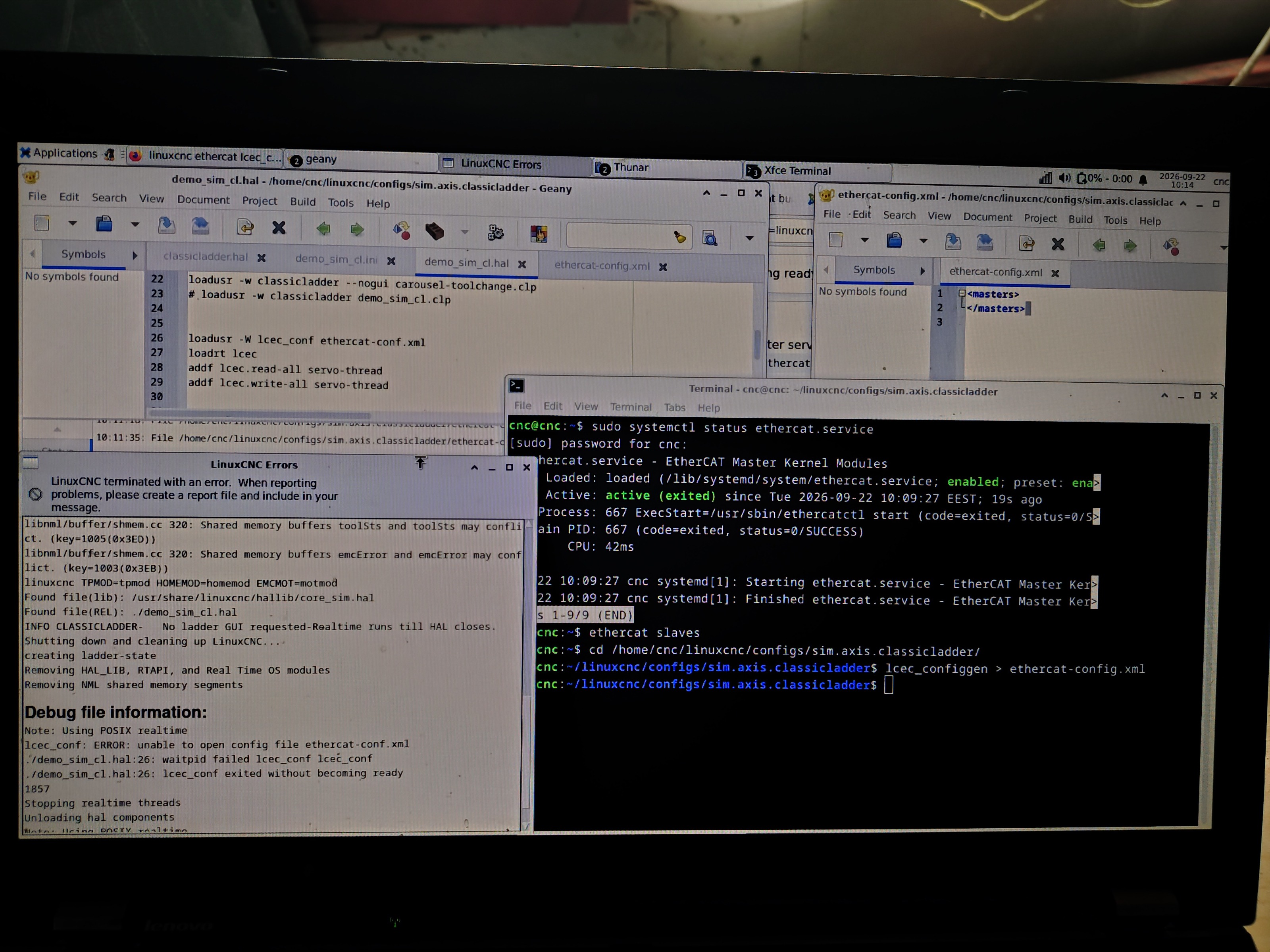

I tried lcec_configgen and the result is xml file with 2 lines which, based on the error message, seem insufficient (please see attached image). note that it was before I tried adding cia402 module. Is that a mistake and is cia402 module mandatory? because the way I understand it now is that cia402 helps connecting HAL pins, but the VFD should be discovered over ethercat even without it. is that correct? one more thing is that cia402.comp in the comments contains suggested HAL file lines and there lcec_conf is loaded in line 50 before cia402 in line 52:
github.com/dbraun1981/hal-cia402/blob/main/cia402.comp#L50
so I think that it should work like it is, the problem most probably is the XML file
I was expecting at least some kind of output from "ethercat slaves" command - there was totally nothing. is that ok? I was expecting some message that shows discovered slave device or a message that no devices were found

one step at a time. you need to get rid of the error messages. comment out classicladder.
I have never used it so on a starting config, why do you?
Why are you still showing us useless xml?
It seems you are not finding your xml file.
I can't see any relevant messages or that 2 line generated file. it may be correct.

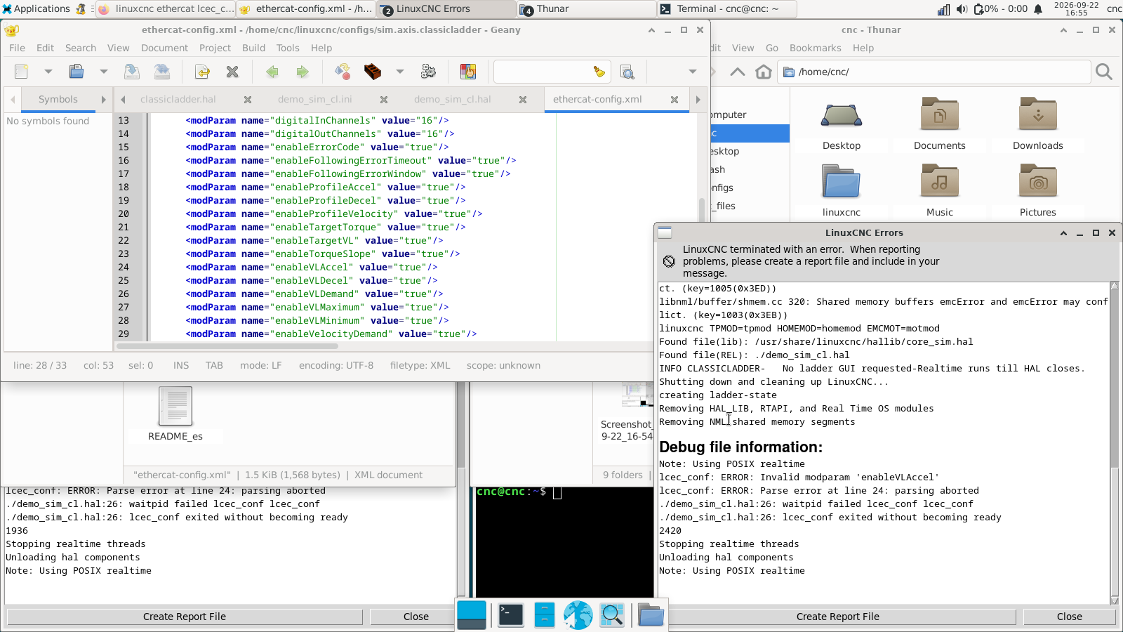

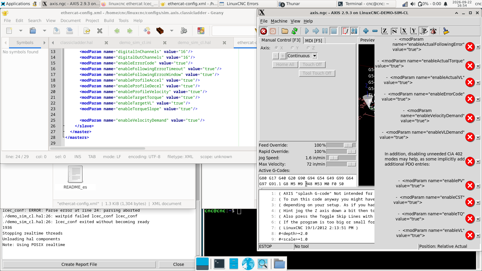

so I tried again with VFD connected and got still the same error (see attached image "error present")
what I did is cut out lines 24-28, saved and tried again and LinuxCNC did run! see attached image "error gone".
how do I proceed from here to actually get the VFD running? is it enough to set the correct HAL pin from 0 to 1 to mimic "run/stop" signal together with providing some frequency/speed value on second pin or does this process require any more steps?

Nobody knows you VFD so you need to work it out yourself, it seems there is a syntax error in your xml and it reports the line number.
Sharing your xml file now you have made some progress would be helpful. as we are flying blind
I suspect you will need to command it more like it was a servo except use a mode that commands RPM (velocity) not position

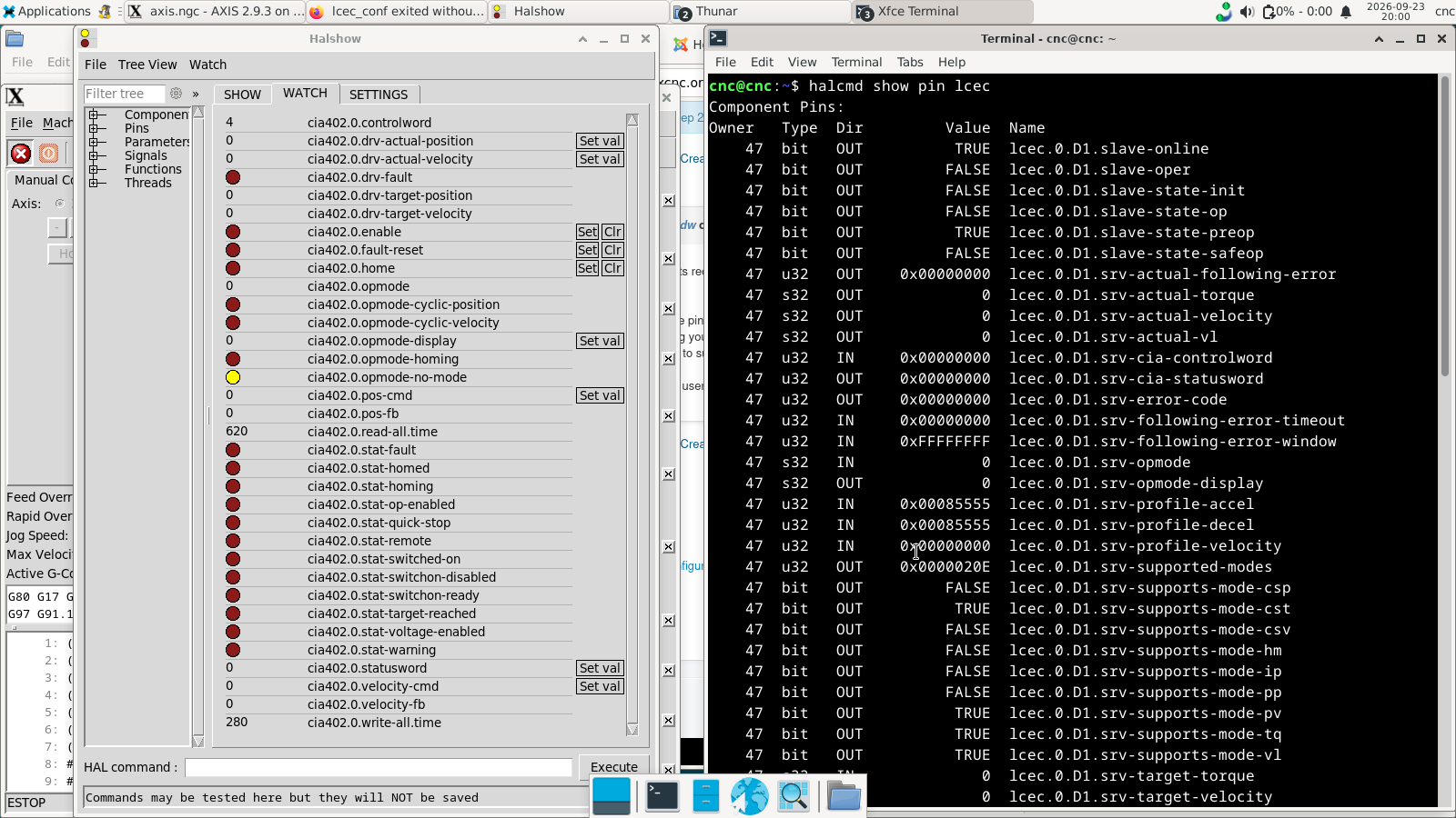

It seems that its recognized as a cia402 device. at this point, with LinuxCNC open, open another window and type: halcmd show pin lcec
This will list the pins they were found. You can use them in your hal file and follow the cia402 templates.
I have a feeling you need to command your drive using a mode not supported by the cia402 component. It will need modifying and rebuilding to support it. But I can't help you there as I have no expereince. Someone else may be able to help.
I do know one user using an abb VFD but they are using MODBUS 485 to avoid buying the FECA-01 interface

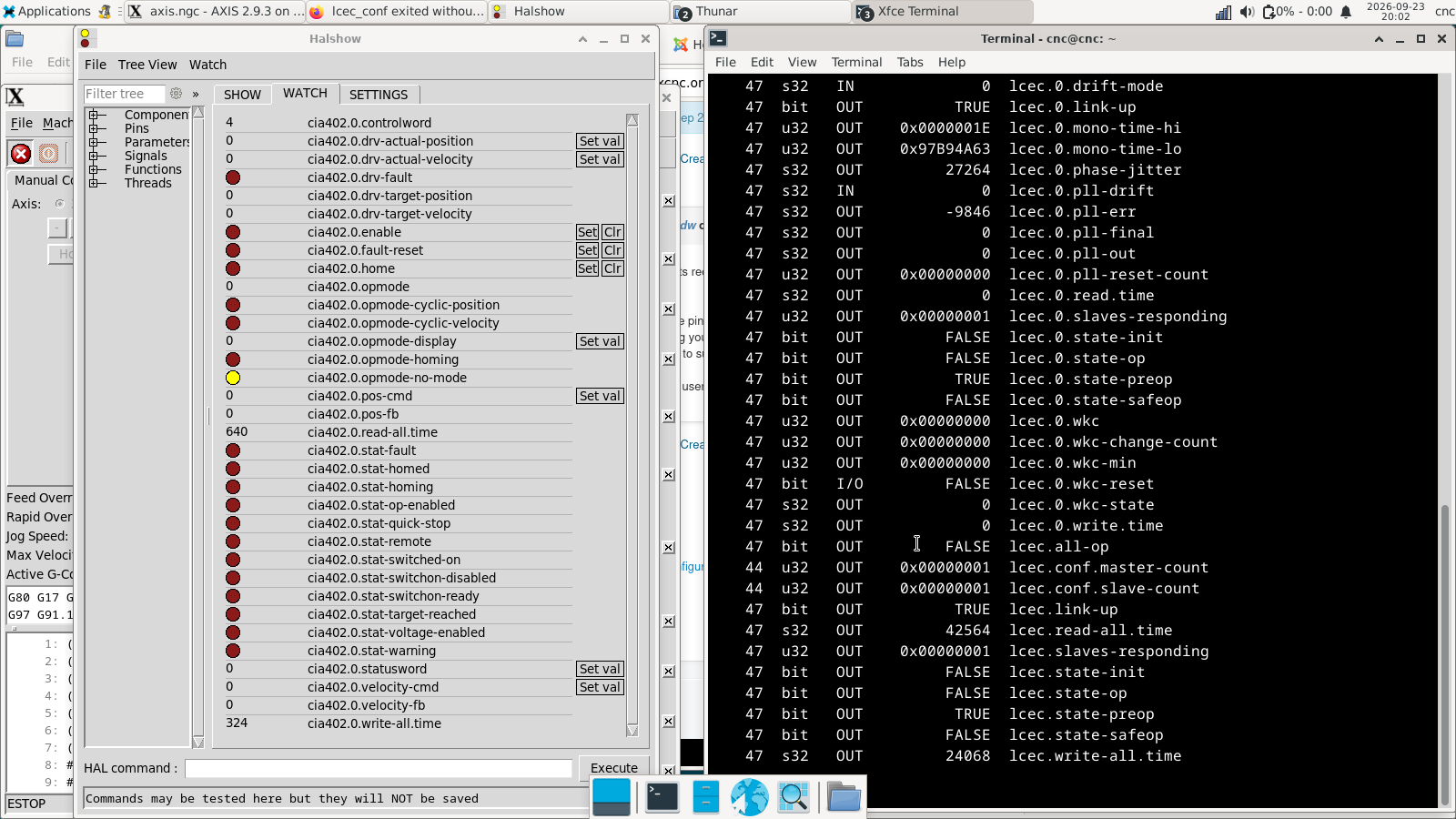

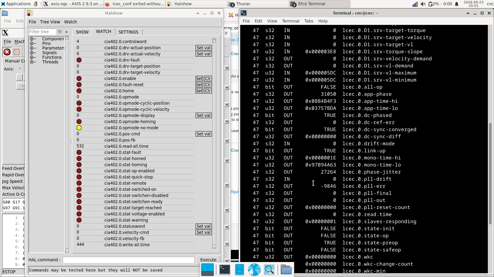

please find attached 3 screenshots - left side are all the pins for cia402 component (they did all fit in screen) and right side is list of lcec pins in terminal. do you have any idea, which of these is "enable" pin? lcec.0.state-preop, lcec.0.state-safeop and lcec.0.state-op seem suspicious to me but then I do not understand why would 3 pins be needed. I would appreciate some hints on which pins should I try for enabling the drive and which would be most suitable candidate for making the motor spin. cia402.0.velocity-cmd would seem like most obvious candidate but is there anything else to add (so far in my experience it would have been 2 pins - one sets velocity, the other would be a bit output for "run/stop")
BTW cia402.0.controlword has value 4, which seem to match instructions in manual to set the parameter 50.04 to 4 (which means that reference is speed). does that help in any way? and since the manual says this:"Ensure the drive profile parameter 51.02 is set to CiA402 (0)" I would like to think that it's all good regarding the suspicion about needing different mode rather than cia402.
could you please share some link where I could see some cia402 templates that you mentioned?
