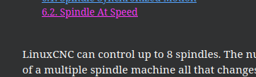

Actually "I" didn't see that but was told that 9 spindles were supported.
even though the Docs say 9
could you point out where in the docs you found that?
Seems to be correct here:
linuxcnc.org/docs/html/examples/spindle.html

Thank you for the update and new pins. I pulled the latest deb and Flex is recognizing the additional spindle connections I put in my test GUI.
This doesn't affect me directly - I have no GUI spindle controls, just displays - but are there similar multi-spindle control pins? I didn't see any update in the docs about those changing.
