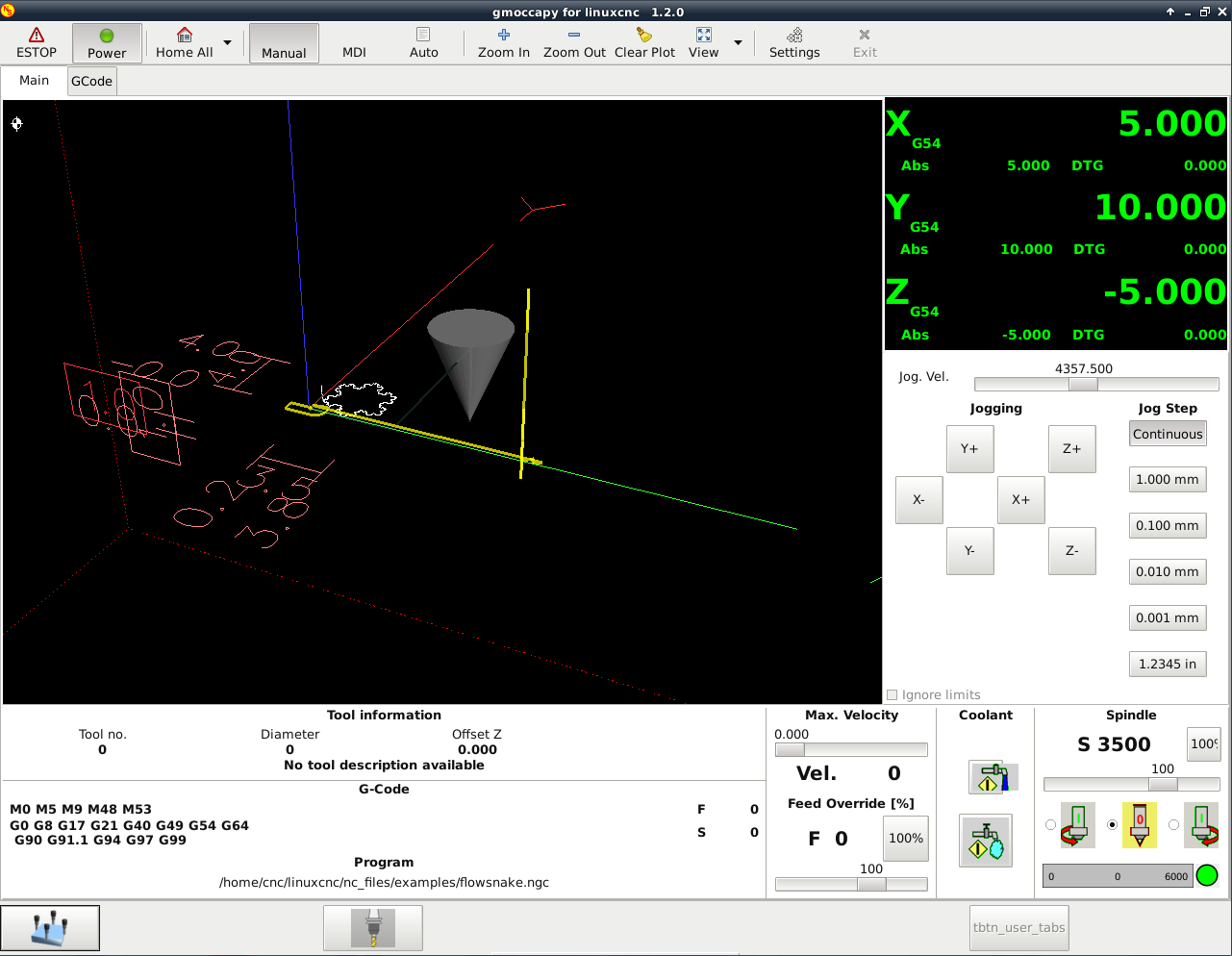

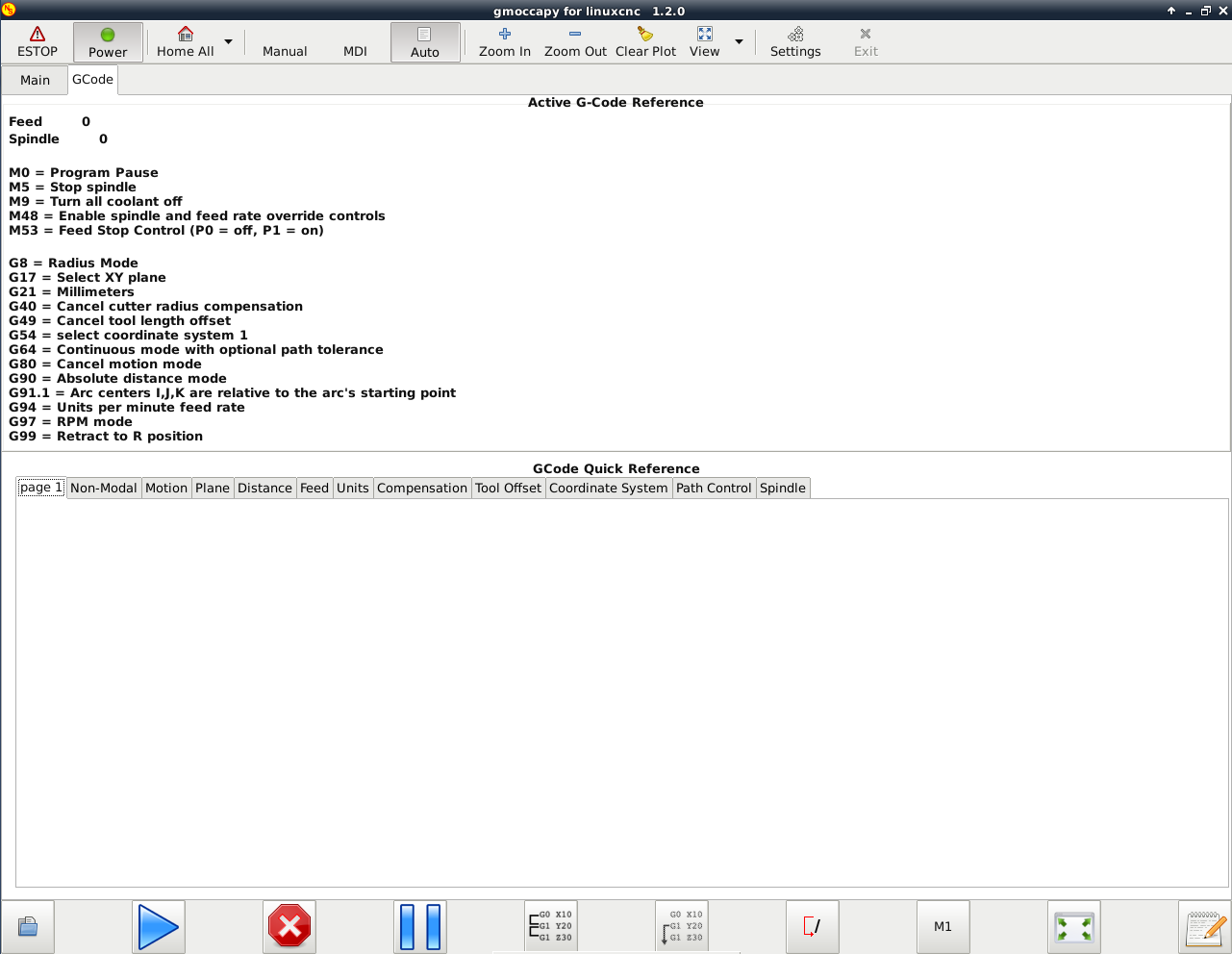

Hello all,
I think gmoccapy is a great GUI but there are a few things that don't suit me very well. I don't have a touchscreen, and I thought the interface could be cleaner and more space efficient. So some months ago I put some work in to a modification of gmoccapy to suit me better.
I have a few hardware buttons (feed start/stop, feed override), but otherwise use the mouse and keyboard
Tonight I dusted it off and thought I would share it.
I have planned to implement a probing tab like is being discussed.
I still need to work on the buttons along the bottom, improving looks and functionality.
I made a GCode quick reference - I forget some GCodes when I don't use my machine for some time.
I have attached some screenshots and the actual files. At present these are just modified gmoccapy files - if you want to try it:
Backup gmoccapy.py from /usr/bin
Place modified gmoccapy.py in /usr/bin (you'll need to use sudo)
Backup gmoccapy.glade from /usr/share/gmoccapy
Place modified gmoccapy.glade /usr/share/gmoccapy (you'll need to use sudo)
File Attachment:
File Name: gmoccapy.glade
File Size:559 KB
File Attachment:
File Name: gmoccapy.py.txt
File Size:189 KB
I would like to develop this further as a fork / offshoot of gmoccapy, but I'm not sure how to put a whole new named GUI, directory structure etc. I think I would call it LCNCScreen
