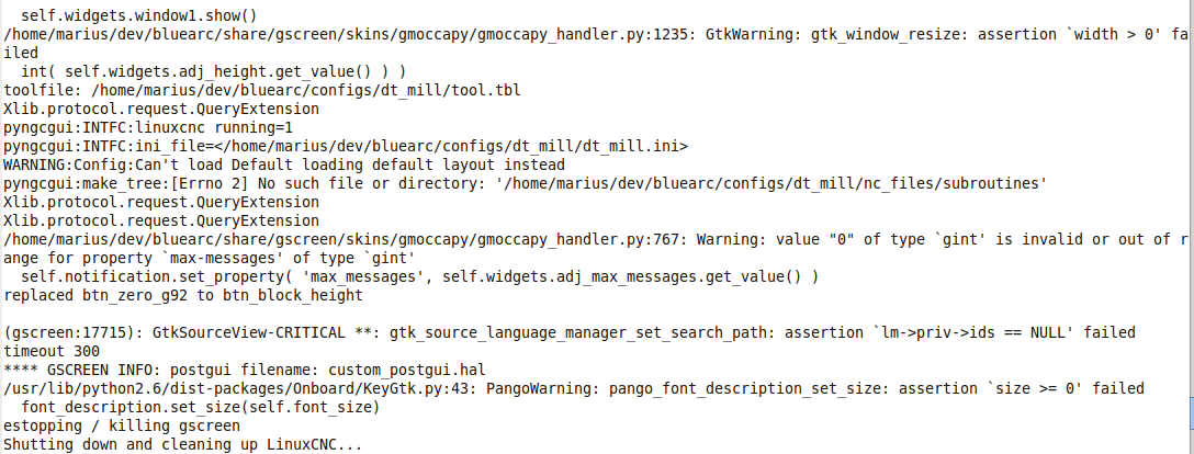

11 Feb 2014 06:05 #43728 by mariusl
Replied by mariusl on topic Gmoccapy - A new screen for linuxcnc
Hi Norbert
I am starting to feel really stupid. Every time I try and integrate the sim config into a real machine config, I seem to screw up.
I took my working desktop mill config and applied the tool_set remap stuff from the sim config. I get these errors and the screen takes a long time to load.
Regards
Marius
www.bluearccnc.com

12 Feb 2014 01:40 #43769 by newbynobi
Replied by newbynobi on topic Gmoccapy - A new screen for linuxcnc
Halo Marius,
I use INI Values and Hal pin for the remap structure, please see change.ngc from macros folder.
In the first screen shot, you are using also pyngcgui and the main error I see, that this one do not find the subroutines folder.
Please take care to set the path in the INI so the different parts you use can find them. In my sim tollmeasurement config, I placed the files in my macro folder and set the path of subroutines to that folder, that could be one point to take care off.
Norbert
12 Feb 2014 03:48 #43775 by mariusl
Norbert
The missing file is not a problem as I have a number of paths specified on the test system. It finds the subroutines OK.
The main problem was the manual tool change pins in the HAL file. The real error was not captured by my screen shot sorry :(. I am using the macro folder now as well.
I have not tested on the machine just yet but hope to do it tomorrow.
