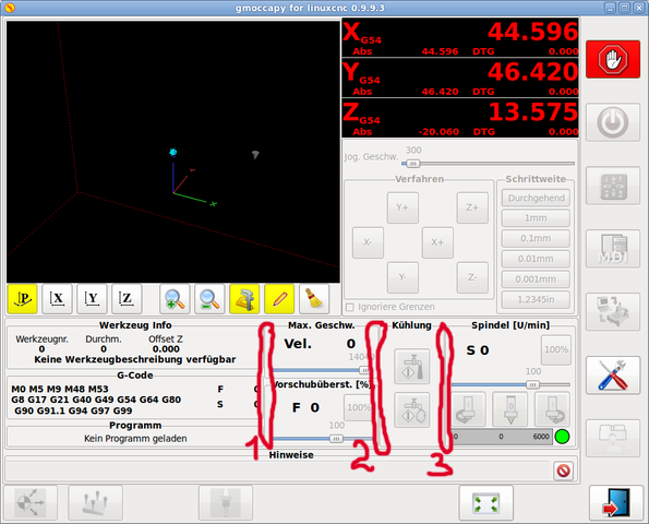

Helo, Norbert
I need your help,
Themes and design standart GTK buttons are not displayed on theĀ "EMBED_TAB" panels .
This included version 1.04 gmoccapy-plazma
This version gmoccapy 1.04 with my addition
startup log
files.mail.ru/2B9DB08B26A34D9A9A4F3FE3128E6782
I need your help,
startup log

Replied by newbynobi on topic Gmoccapy - A new screen for linuxcnc
@verser,
I just pushed the needed changes. See the new file signals.py and the changes of plasma.py.
After you change the theme in gmoccapy, you will have to restart the GUI so the panels can get notice of your changes. Both panels will read the Theme-Name from the preferences file and set it. Would be finer to do that with signals, but I thought the work does not worth it, because the theme changes should not be a think you do every 5 seconds
Norbert

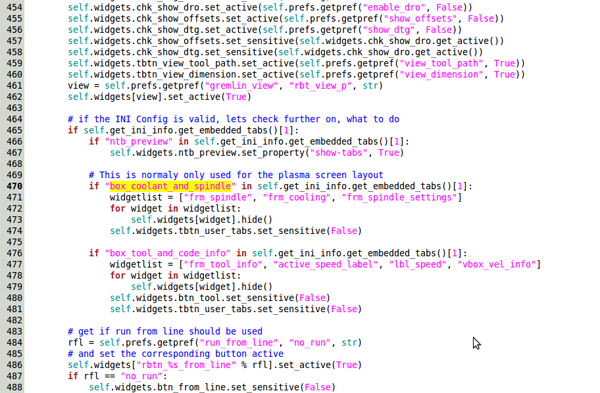

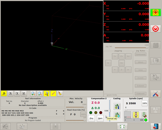

Norbert, there is a huge request,
to complete the work on the compensation Z (and more) requires space to insert it.
It is possible to add a hide blank panels in gmoccapy.glade here
and in gmoccapy.py here
insert code
insert code
if "box_custom" in self.get_ini_info.get_embedded_tabs()[1]:
widgetlist = ["box_custom_widget1","box_custom_widget2","box_custom_widget3"]
for widget in widgetlist:
self.widgets[widget].hide()
self.widgets.btn_tool.set_sensitive(False)
self.widgets.tbtn_user_tabs.set_sensitive(False)
Last edit: 06 Mar 2014 01:24 by verser. Reason: edit

@verser,
I am not able to follow you.
In the image showing the themes problem you panel did fit, so why introduce new panels and hide them if custom:box is in embedded tab?
Could you explain more in detail?
Norbert
Norbert
