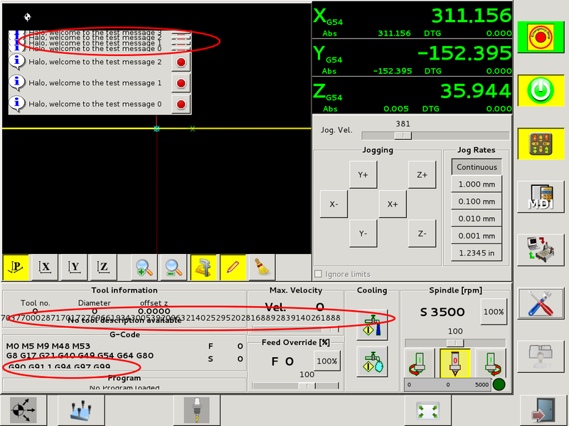

Wow! 85 pages in this topic and counting. I hope I'm posting in the right place.
I'm having some issues with how gmoccapy is displaying on my 15" touchscreen.
If multiple pop-up alerts occur at the same time, the newer ones are reduced in height until it's impossible to click the button to clear them.
I'm also seeing an exceptionally long number string for the max velocity and I haven't figured out how to fix it.
The pane showing the enabled gcodes is clipping. It's
minor but annoying.

Hi
Look in the INI file under the [TRAJ] section you will find and entry MAX_LINEAR_VELOCITY = xxx. Change that entry to MAX_VELOCITY = xxx
As for the messages, what config are you running?
Regards
Marius

30 Aug 2014 21:29 #50521 by sliptonic
Replied by sliptonic on topic Gmoccapy - A new screen for linuxcnc
Hi
Awesome. I'd commented out MAX_LINEAR_VELOCITY but not replaced it. I thought I'd recalled something about that error but couldn't find it in the thread. Maybe we need a troubleshooting or FAQ section on the wiki.
My config is based on the default sim config but modified quite a bit for my mill. I've been running it for 6 months and just upgraded linuxcnc and the machine it runs on. Now running debian so also affected by the lack of onboard.
The Ctrl+space trick is a good workaround but doesn't help running a touchscreen.
